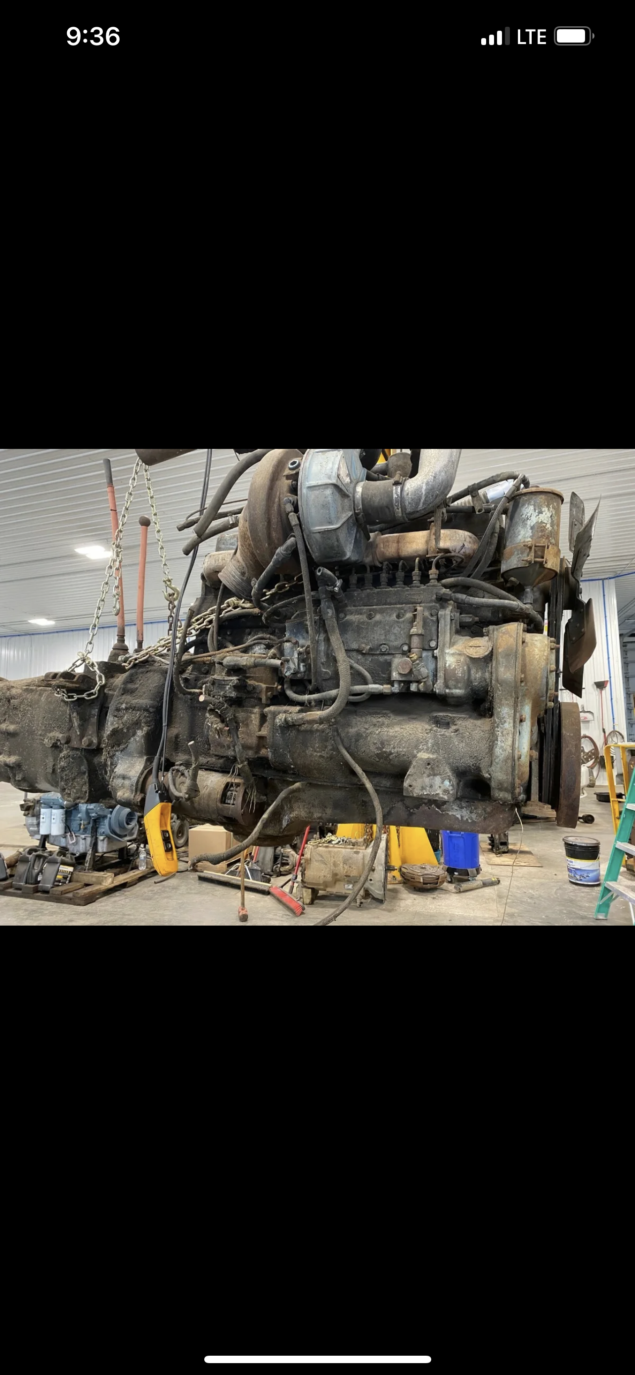

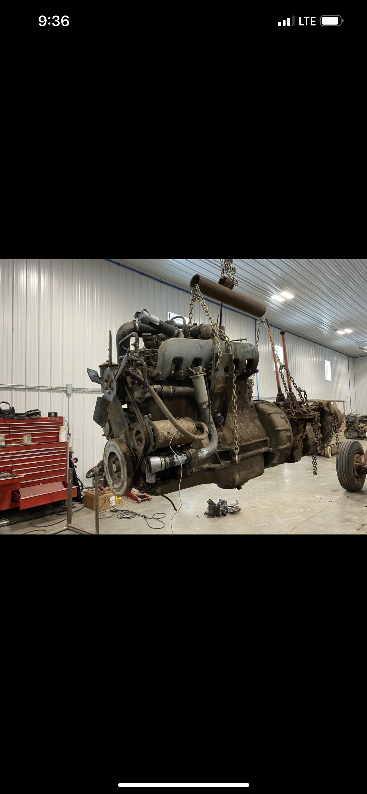

Nice. I’m gonna have to fab something up I guess. I saw this pic online. I like the idea of the pipe for a spreader. Not sure I like how all the weight is on the exhaust manifold. The oil filter housing bracket looks like it works well enough for the drivers side
Thats quite the wood chipper on the exhaust there !😂
Early Schweitzer?  Seems kinda familiar on early 673s.

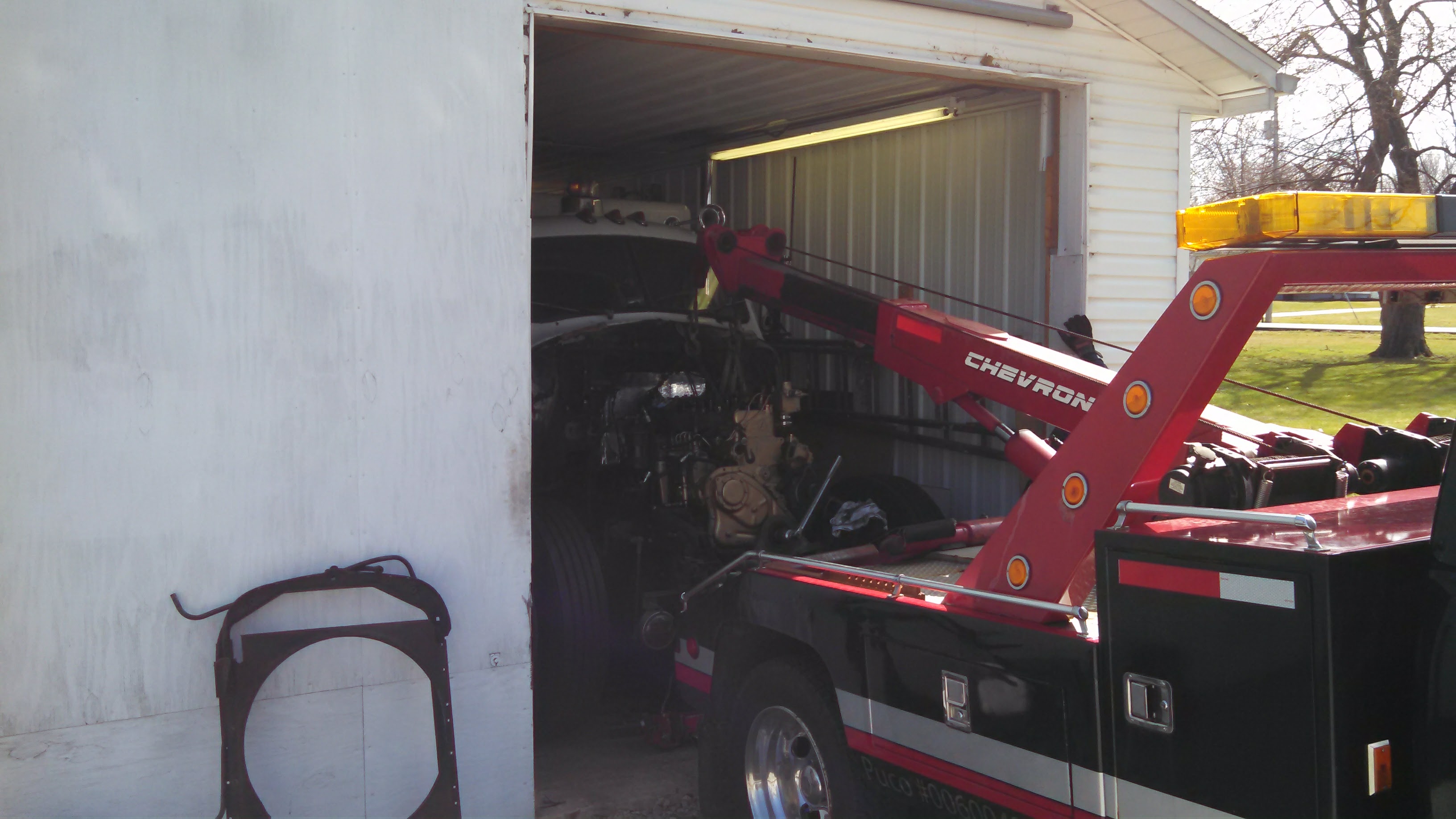

Craig, I didn't use a spreader, just three points with a chain.  Got lucky and buddy let me borrow his wrecker.  Worked perfectly.

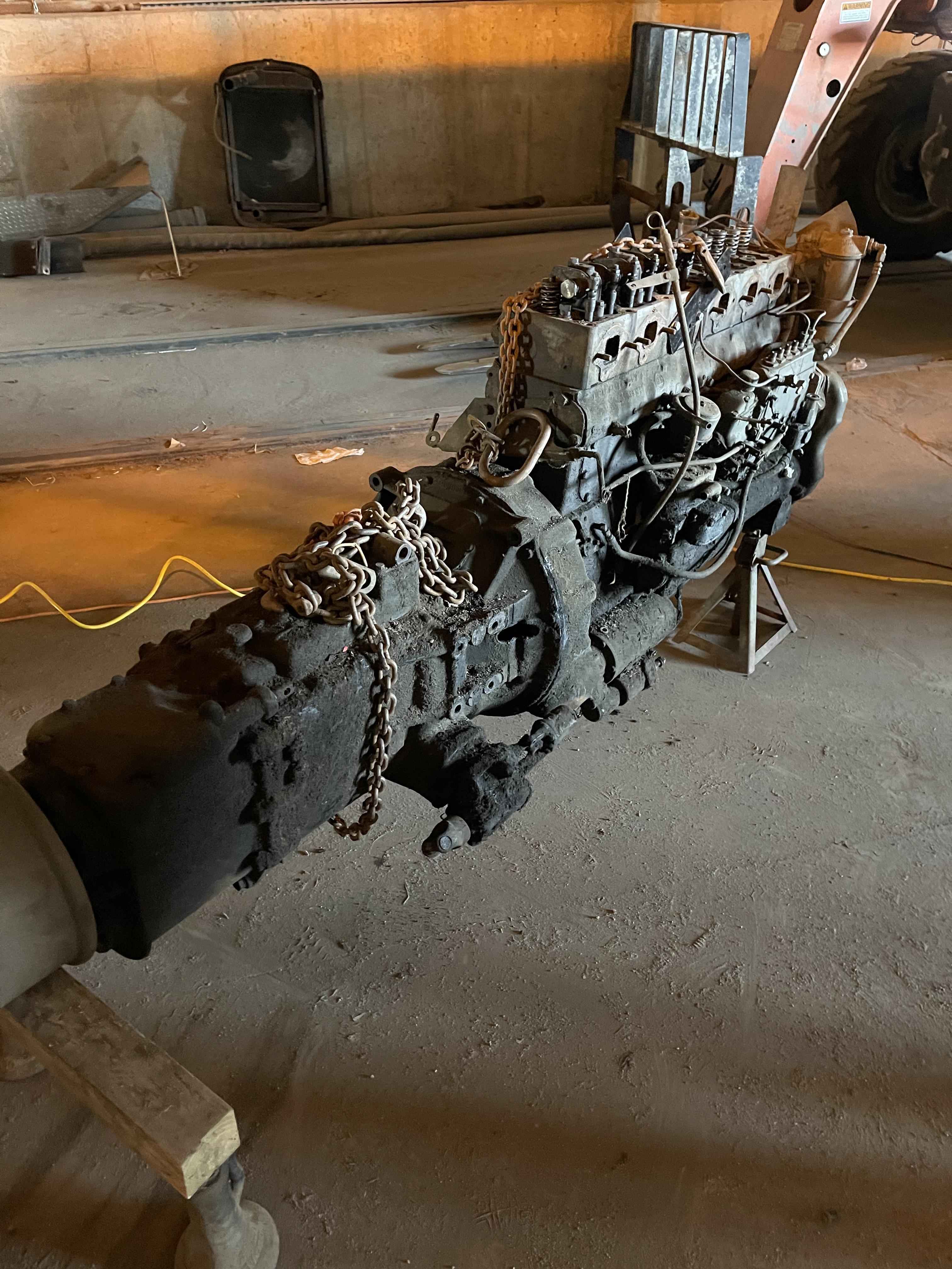

Oh nice. I’ll have to see what I’m up against once I get it all apart and ready to pull. Will probably use the 8k extended forklift I have at work to pull it I think. I haven’t worked on it in a couple weeks, need to get some time on it. Would love to have the body off of the green one before the new year

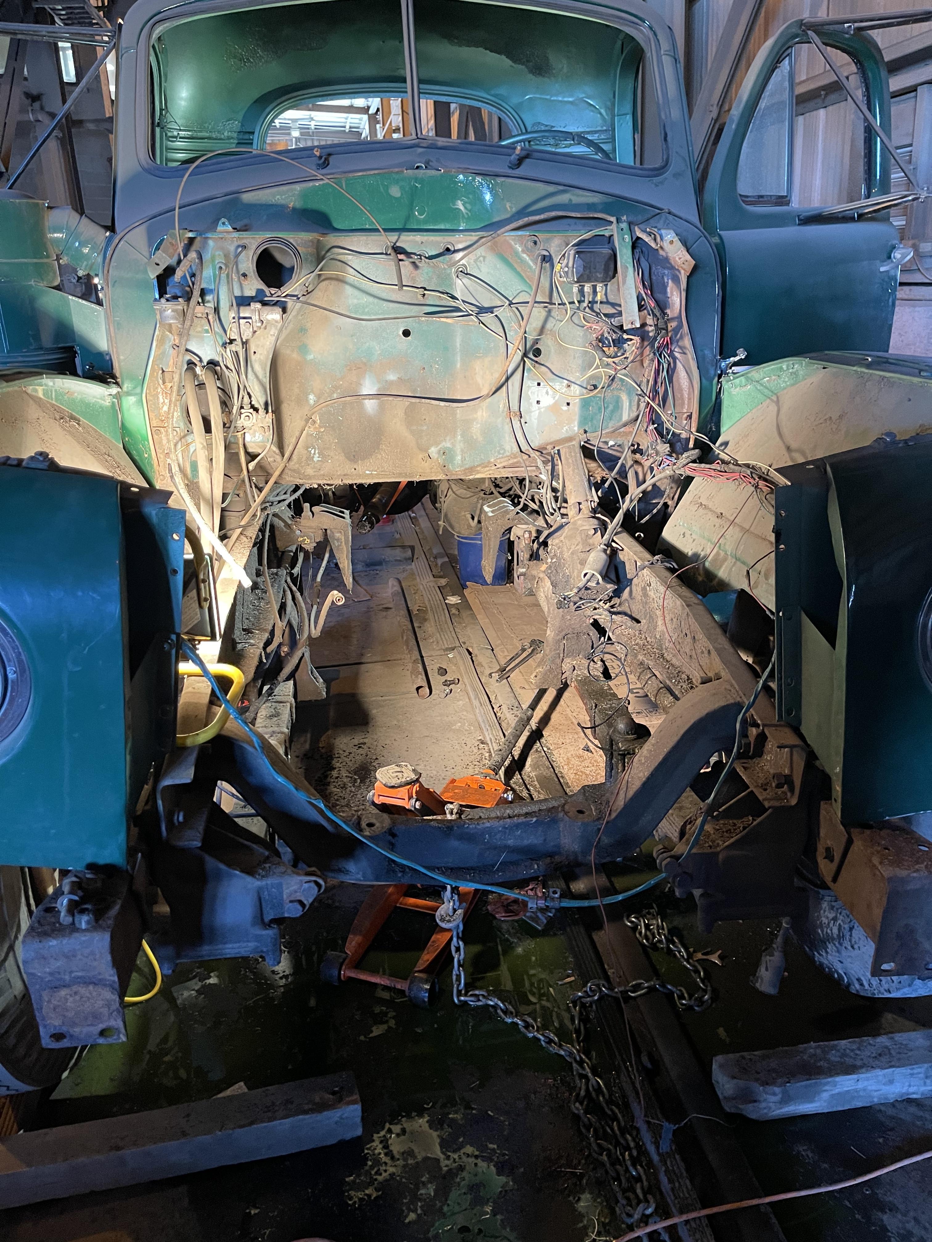

Wish they put “eyes” on these motors from the factory to hook chains to. Would make it a hell of a lot easier to pull those things. We fabbed up some plate steal to bolt to the heads to pull the one out of the green one, but all the manifolds were off of it so it was easy. I don’t really want to take the manifolds off of the running one if I can help it.

as I said once in another post ;; these engines didn't come with lifting eyes for unlike todays electronic "nightmares" engines back then were made to work ; not be removed for repair regularly. for your removal operation  one major thought will be :: is this lifting procedure safe. i have found chains have a tendency to bend things , HD straps work better if possible. the lifting device also makes a difference.  trans mission/ engine combo pulled together  to me is alot of pressure on the manifolds.
