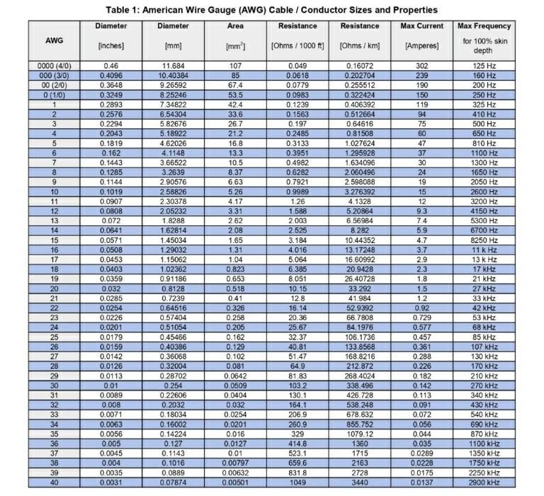

IMG_7299.thumb.jpeg.43909688b5c93ac14c91c9c68a1736bf.jpegWhat size fusible link are you all running between your battery and alternator?  For those that run an alternator.  The alternator tested at 180 amp, so a 200 amp fuse is my thought.

I don't think most alternators have a fuseable link in the circuit
However it is important to remember the purpose of a fuse is to protect the wire, nothing more, so fuseable link size should be based on the wire not on the alternators ability
I found this chart bellow that should you give some idea
As far as the pulley goes, the only downside that I can think of is alternators become effective at a different speed and can spin a lot faster than a generator
As such most alternators have a lot smaller pully so the alternator with a large pulley might not be useful until the engine revs pick up, if it was mine I would hunt about for a small pully as truck motors only rev low to begin with
Do you know what size pully the alternator is meant to have ?  This might be a place to start, or what the rev range is
Good luck and great progress, a bugger about the glass, I have zero luck with glass fitment and just pay the coin as I break more than I have success with lol
Paul
I’ve got the smaller pulley, I can run that.  I was just thinking of not having to figure out what size belts I’ll need and saving a few bucks haha. I’ll put the smaller one on tomorrow and try to get it mounted up. Just gonna run some 1/2” all thread for the bottom bracket I guess.
