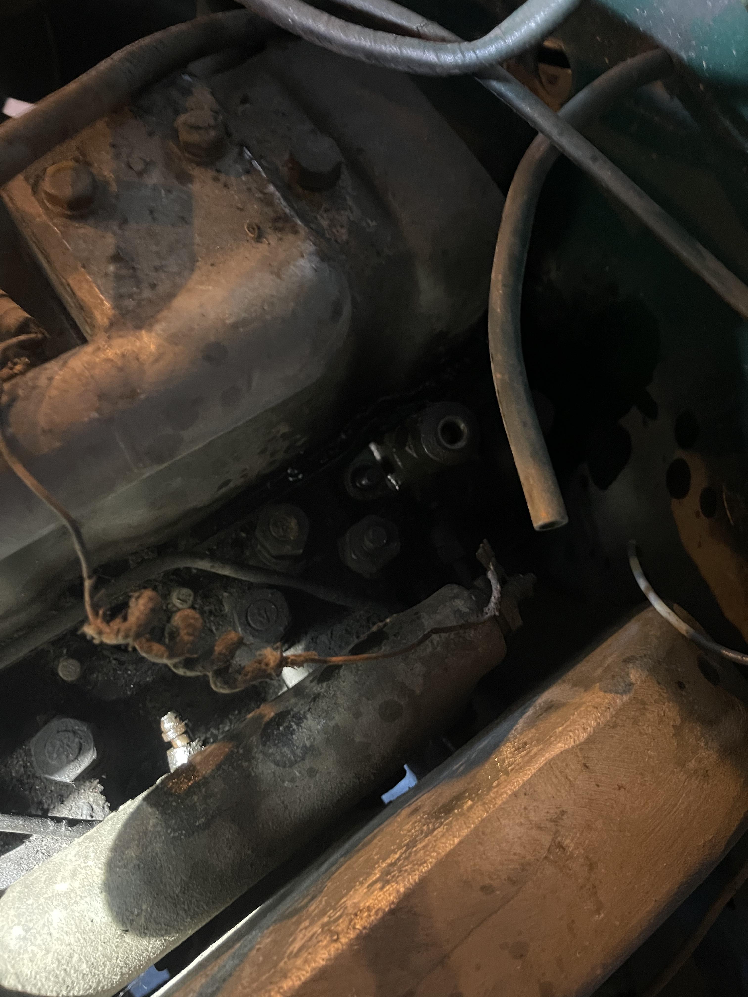

Hi all. I just picked up a nice b42 but the motor is stuck from sitting about 6 years. Supposedly ran fine when it was parked.   I’m going to pull the injectors on  the 673 and put some mystery oil/on blaster in the cylinders and let it sit about a week. Then I’ll jack it up, put it in high gear and rock the wheels back and forth to try and free it. So, my question is, can I make a slide hammer out of a long 3/8x24 bolt and thread it in to where the banjo bolt holds the return lines on top of the injector and use that to get the injectors out?  Is that too much on the threads maybe?  There looks to be about a half inch of threads in the top of the injector for the bolt to grab to. I don’t wanna wreck the injectors. Might try to find a puller that will go under the ears but figured I’d ask here first. Thanks for a great forum filled with tons of great info, everyone.

based on the picture, you have ALL the hold down inj nuts off. if you pull any inj that is free then put two nuts back on loose of the stuck one, the engine  will spin over easier to possibly push the stuck ones lose. that's if the heel trick doesn't do it of course

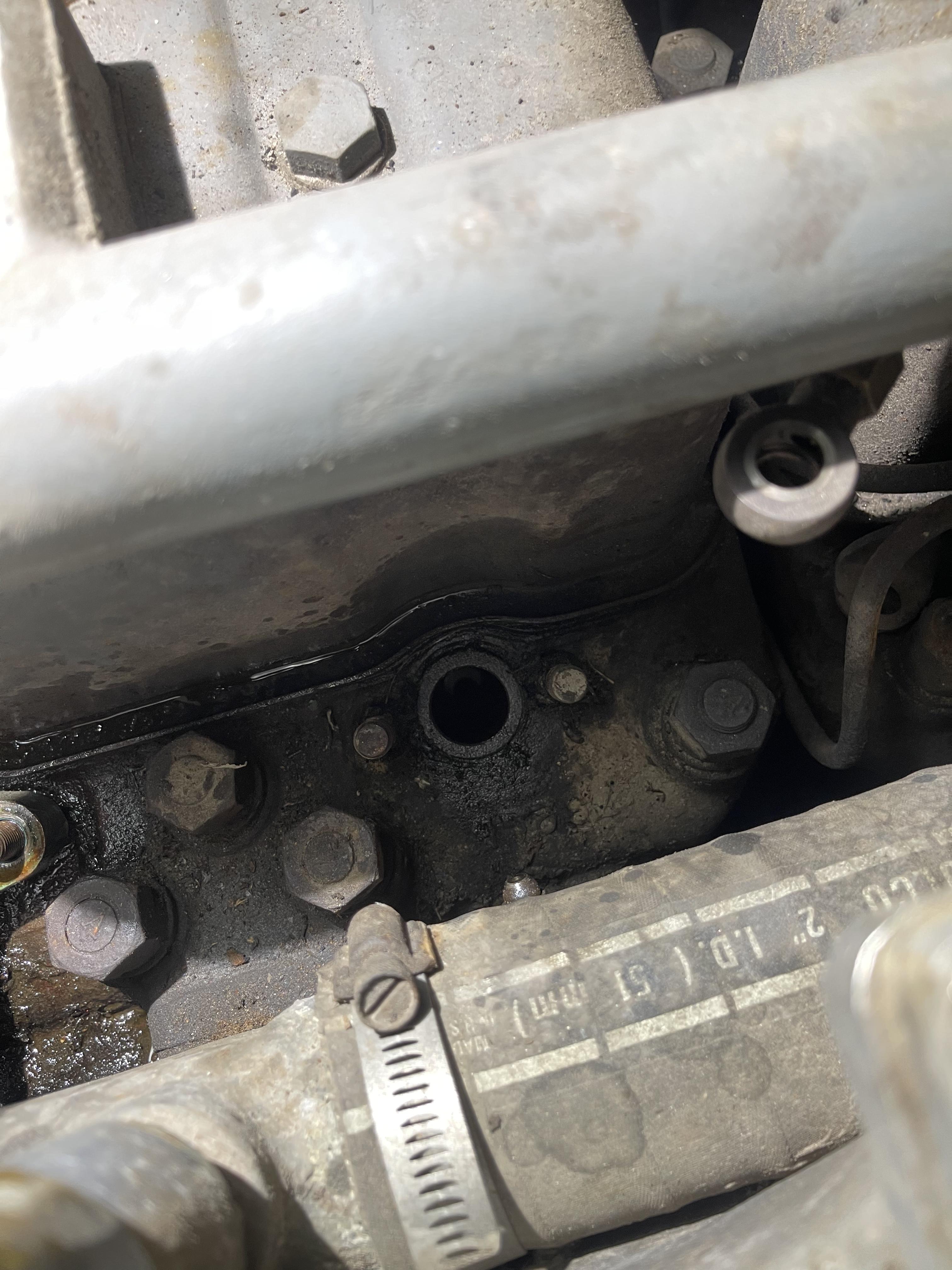

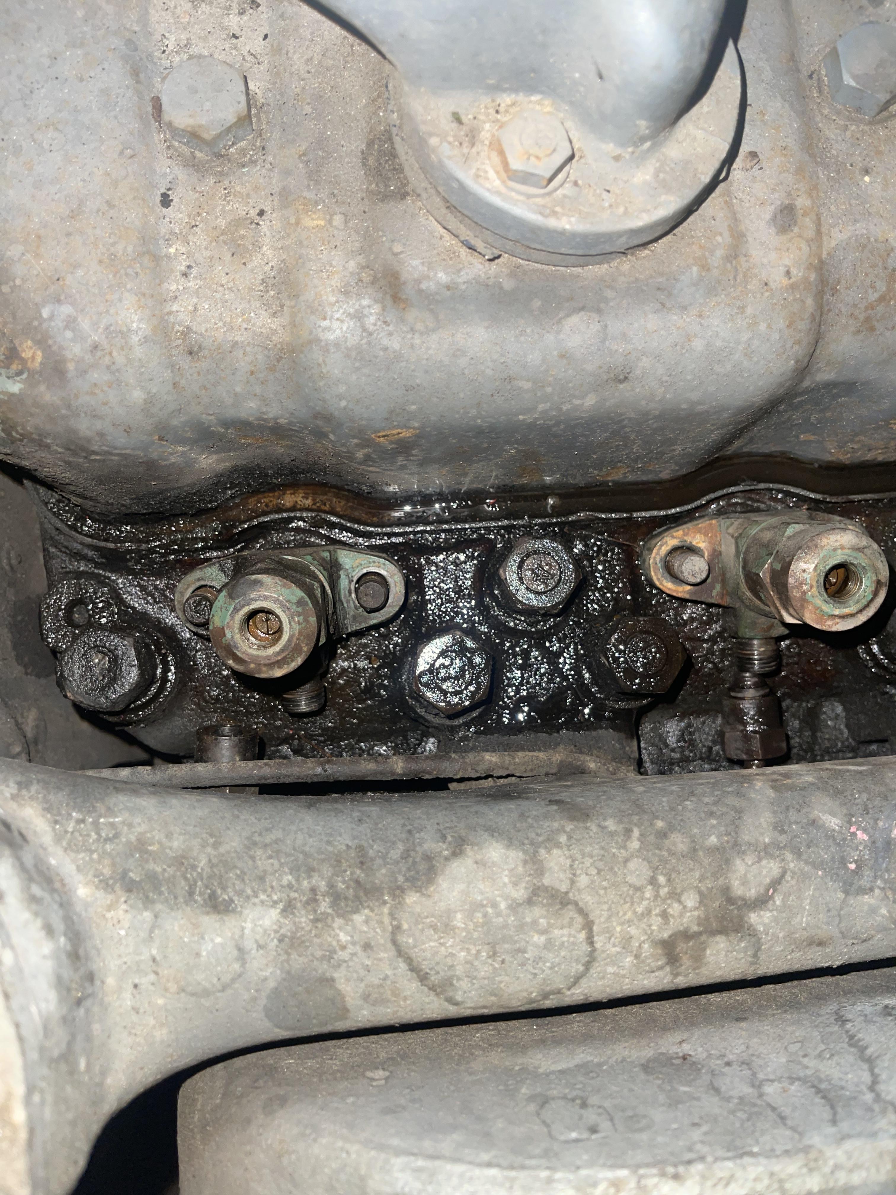

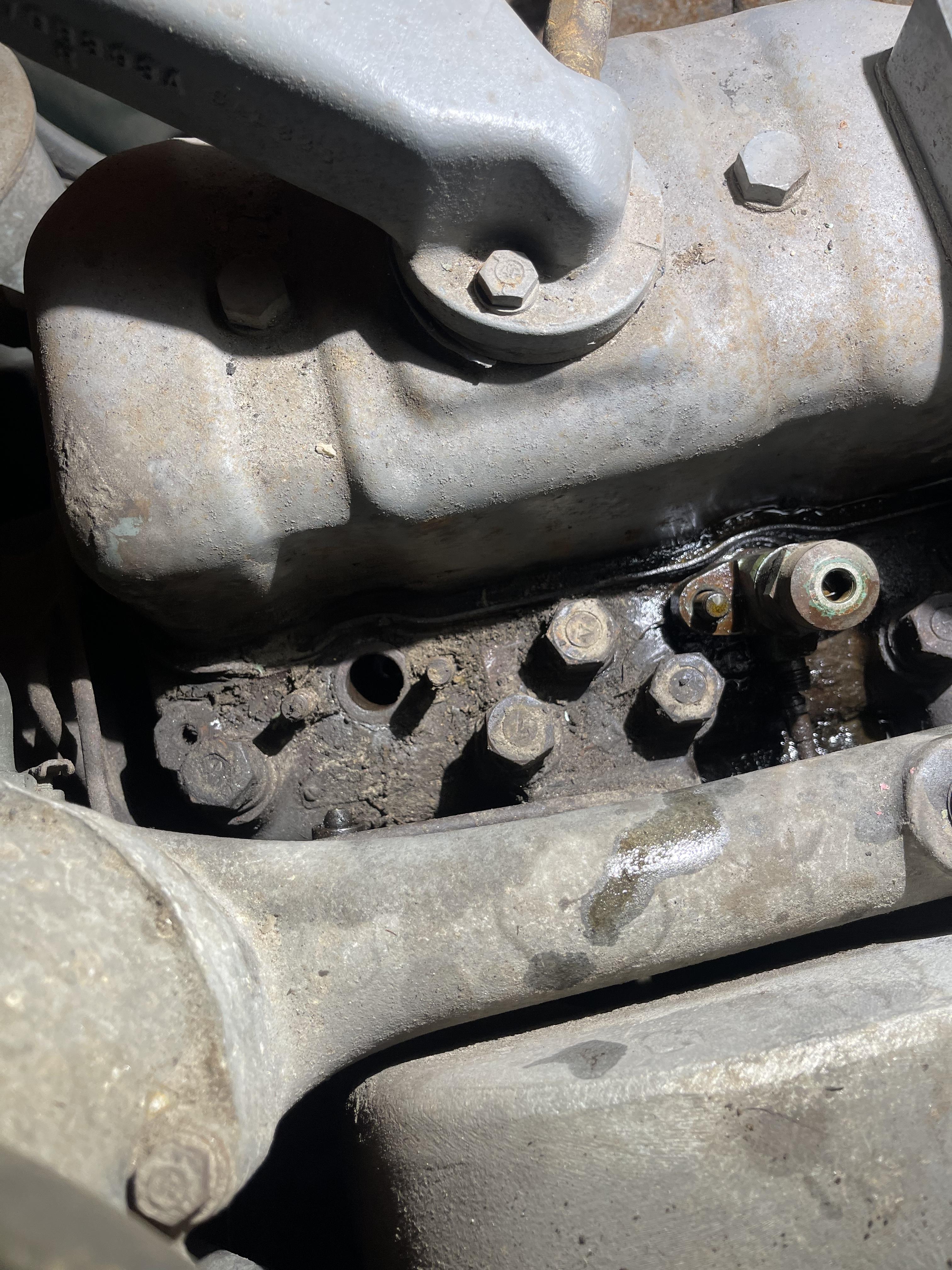

Well, I’ve got 4 out of the 6 injectors out and they came out relatively easy with the heel bars. There are two (2&6) that are being super stubborn. I’ve been fighting with them for a bit now and can’t get them to budge at all. I’m gonna wrestle with them more today and I’ll spray them down once again before I leave tonight and fight with them again tomorrow.  Thanks for all the advice on here.

So, do you think there’s any chance of breaking the ears off using the heel bars? I can get some leverage on them if I add some wrenches too. I’m using 18” (give or take) heel bars so could probably double the leverage.  The others came out with minimal effort with the bars (one 12” even) but these last two are real stubborn.  I’m trying to avoid taking the air intake and coolant manifold off to even think about getting a hammer and punch in there. These injectors are sitting on studs so not sure how much I could really get them to move with a hammer and punch anyway, but it might be just enough to break them loose.
