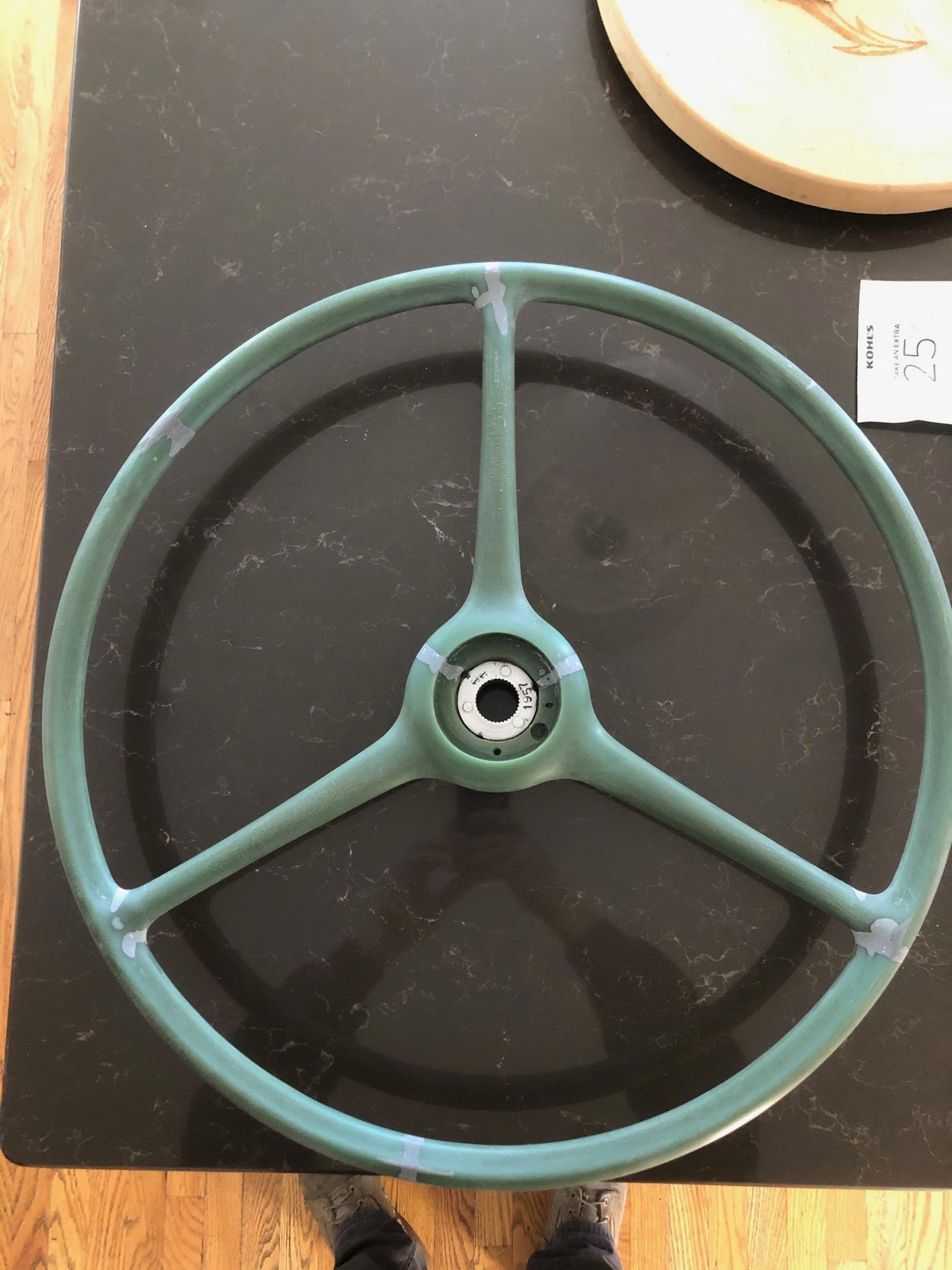

Steering Wheel
The wheels I have are all pretty badly cracked, and I don't want to mortgage my house to get one recast. If anyone has a decent one they'll sell please let me know. Otherwise I guess I'll have to putty it up and paint it. If you have any tips on fixing the cracks, please post them.

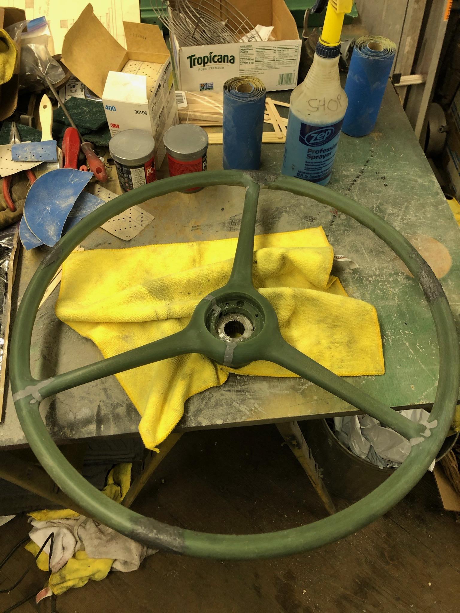

They have a retro wheel that looks pretty close to original. I think the price is somewhere around $350-400. I got a quote to do my wheel of $1100. I ended up using PC-7 to fill the cracks and about six hours sanding. I used SEM Flexible spray over several coats of primer then cleared it. This was about four years ago. It has held up well although I see some hairline cracks starting to appear.

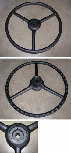

You also might want to check some of these custom big rig steering wheels I know you probably don’t want to go that route but at least take a look at what they got you might find something you would be happy with good luck
I want to stay with the original style, that white one would work fine but it's a 20" wheel and with manual steering I need the biggest one I can get. Mine's 22" and that extra 2" makes a big difference.

I did the PC-7 epoxy on mine. I've looked at all the above options(military, re-pro, restored & new)and I ended up painting it black when done, I couldn't get a satisfactory color to match the original tint. Mine wasn't horrible, but had several decent age cracks. The kicker is I was saving a really nice 22" one from my B-42, when I put power steering in it with a 20" wheel. When I dug it out I discovered that there is a difference in the splined hub area and it wouldn't fit the B-73 shaft. I would send it out to have the hub modified to fit, but I don't know of anyone who can do that.
If any one has a paint code that closely matches the original plastic tint, I love to get it.

Take the wheel down to Napa and have them hit it with their special little paint match gun.  It’s the easiest way and paint codes never match up with what you have.

I was leaning towards that new white wheel.  I like the look.  I may paint it later?
