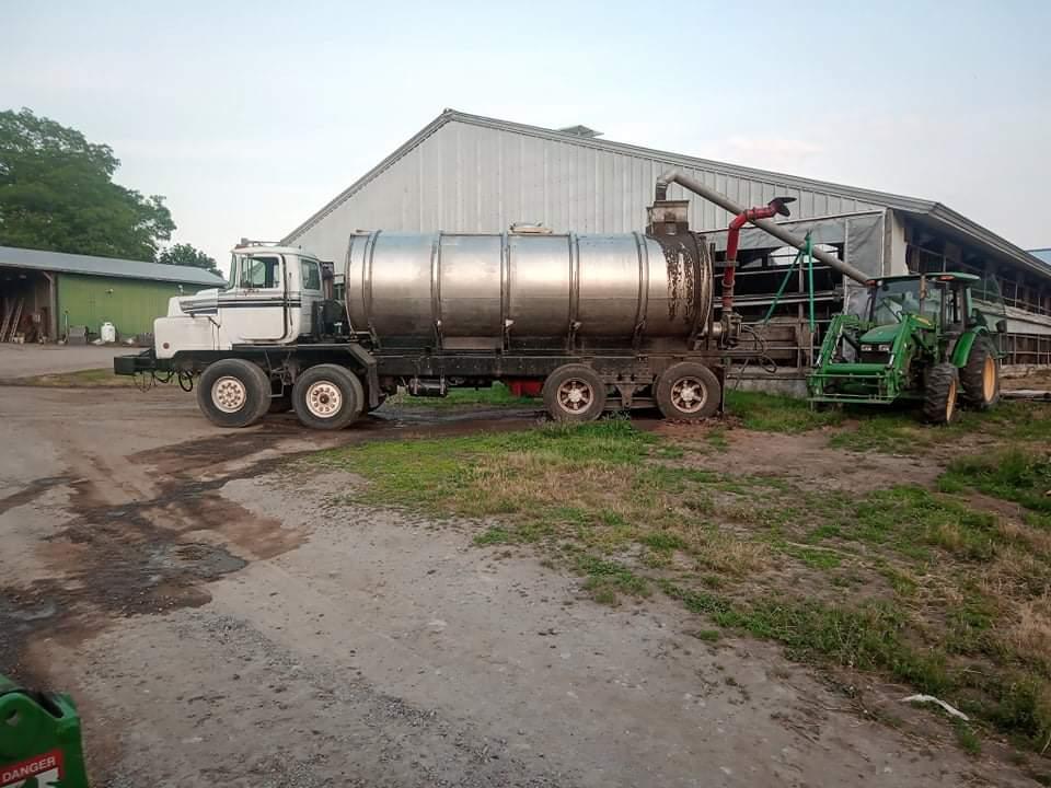

The mighty DMM
Manure must be happy if it only could feel anything for being transported in that shiny food grade SS tank!
The truck is an animal definitely. I also have a DMM. But turned out it's a project put on a back burner. I had to remove the cab to transport the truck in a closed trailer and it's still off the chassis for almost 7 years now. Hope to get fixing it some day. The specs are EM6-285 with T2060 Mack 6 speed and 44000 walking beams. It's a tandem not 3 axle as yours.

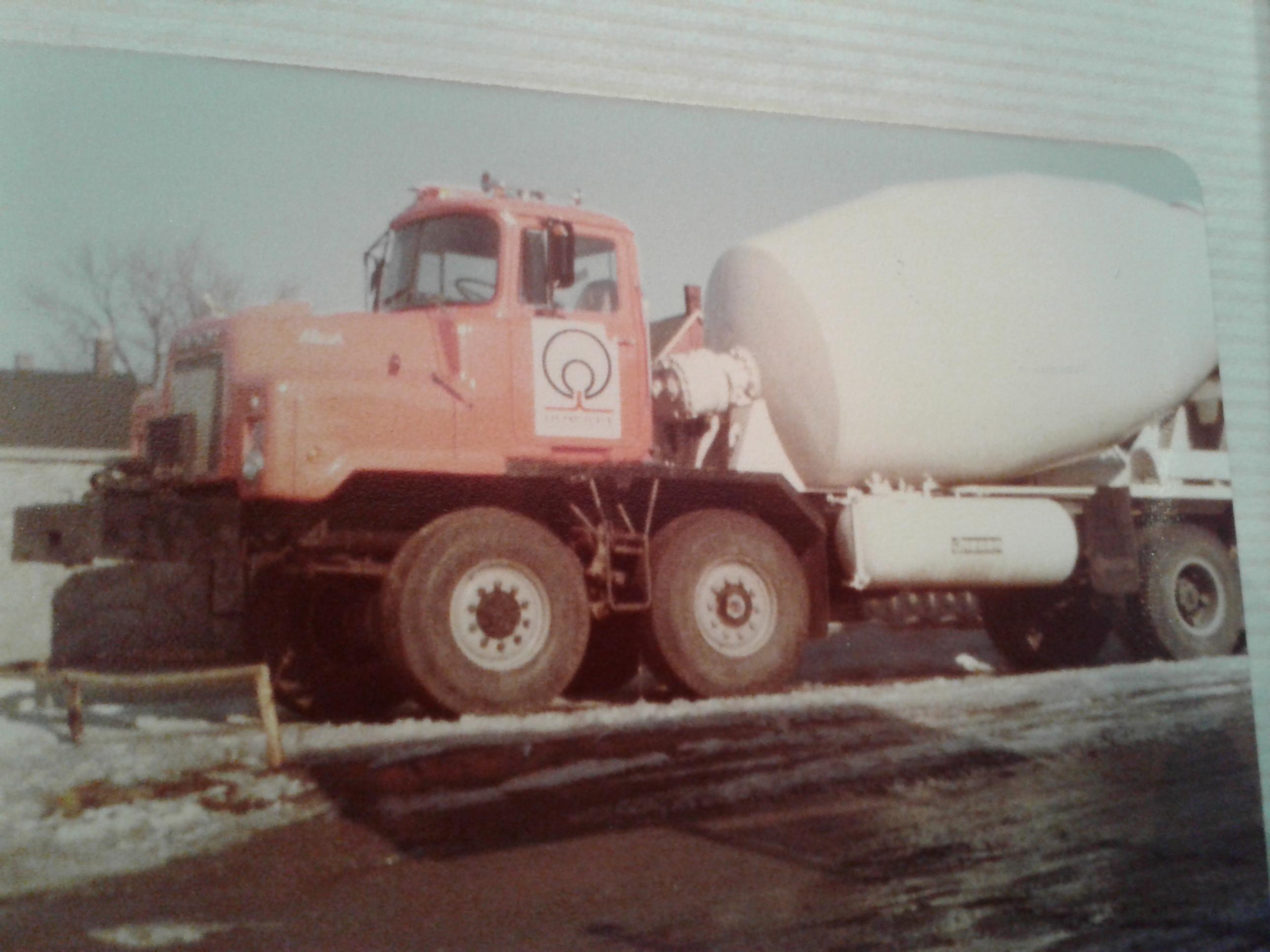

Nice truck. Up until just recently, those OWNED the ready mix market here where I am. Tandem tandem, just like that with 72 inch spread. But they tell me it is getting hard to find front drive and transfer case parts for them now??
I always wondered how that drive system worked. Back in the 70's and 80's when all the ready mix trucks were just DM tandems here, I remember they all used to be able to move with nobody in them, but I have not seen that in any of the current ready mix trucks here any more.

I've never heard of remote drive on a cement truck, but it is possible to get a specialty transfer case that can accept power from either the transmission, or a hydraulic motor. Sort of the opposite of a transfer case in a fire pumper, that will output to the rear wheels, or to the axles. Another option would be an air cylinder on the clutch. For low speed driving you don't really have to take the brakes off, but it isn't really advisable practice in either case.
As for front axle and transfer case stuff not being available. I hope that isn't the case. But I also hope I don't need any...

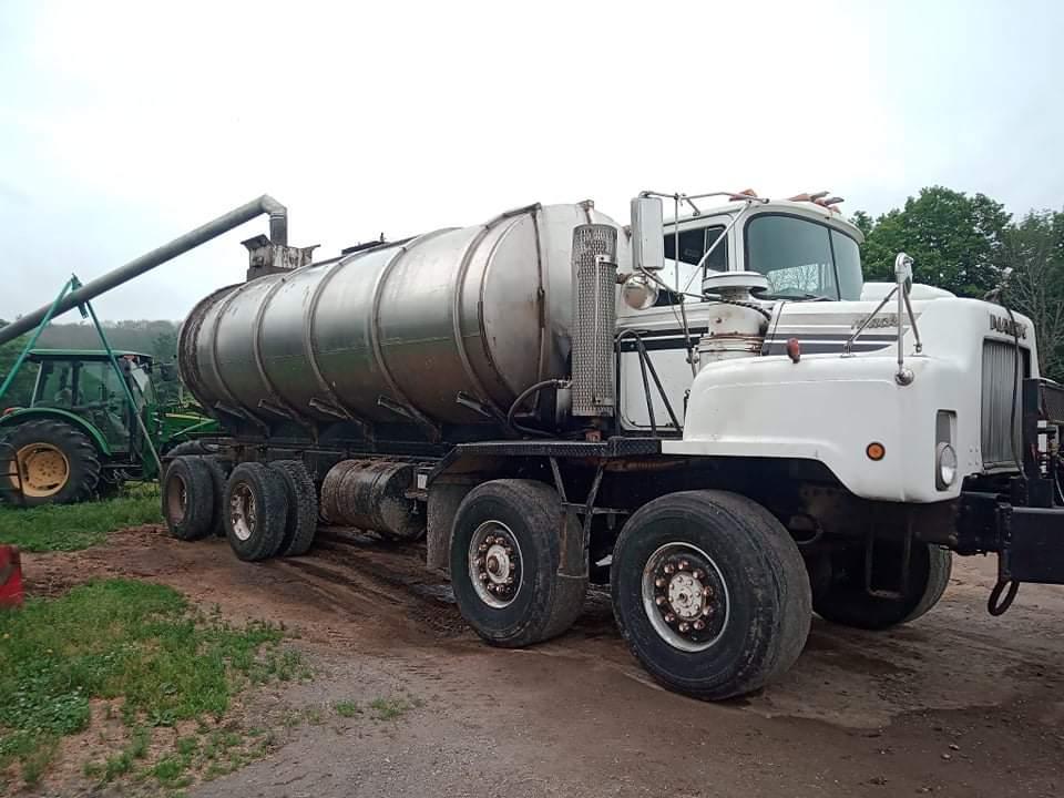

The biggest issue with DMM6EX units in Ontario is that with the start of SPIF axle set ups over 10 years ago, you could no longer carry a full capacity load on the forward axles. Because the second axle has a cab controlled air switch which controls air bags for ground pressure to the axle. It's basically considered the same as a lift axle in Ontario which is now reduced carrying capacity.  Love those DMMs.
