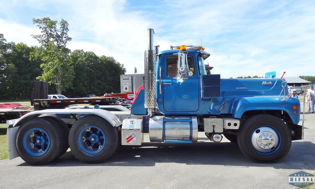

I have a line on a running V12 Detroit I was kicking around the idea of putting it in the superliner. I know to some its just wrong to power a mack with a Detroit even though they did from the factory in the 70s. I'm no stranger to fabrication but am wondering how deep into it I will have to go. The truck has a fuller ten speed in it right now so the bellhousing should be right and I know exhaust and linkages will need to be changed. I should have enough room for the larger engine being a parade truck it should raise the cool factor a bit the truck has a newly done in frame rebuilt 300+ there should be a market for that to offset a little of the cost of the swap.

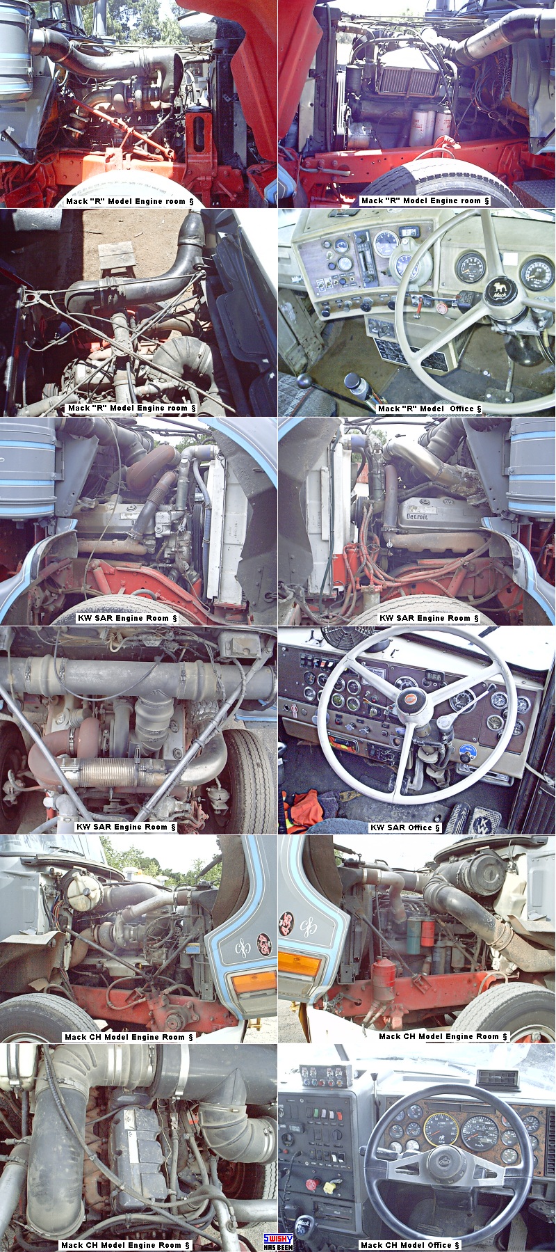

with many variations of the Jimmy diesel surely U wouldn't need to stretch the hood
may jack cab up a cuple inches !!
any one got the dimensions of the V12 compared toa Mack 6 or V8?
