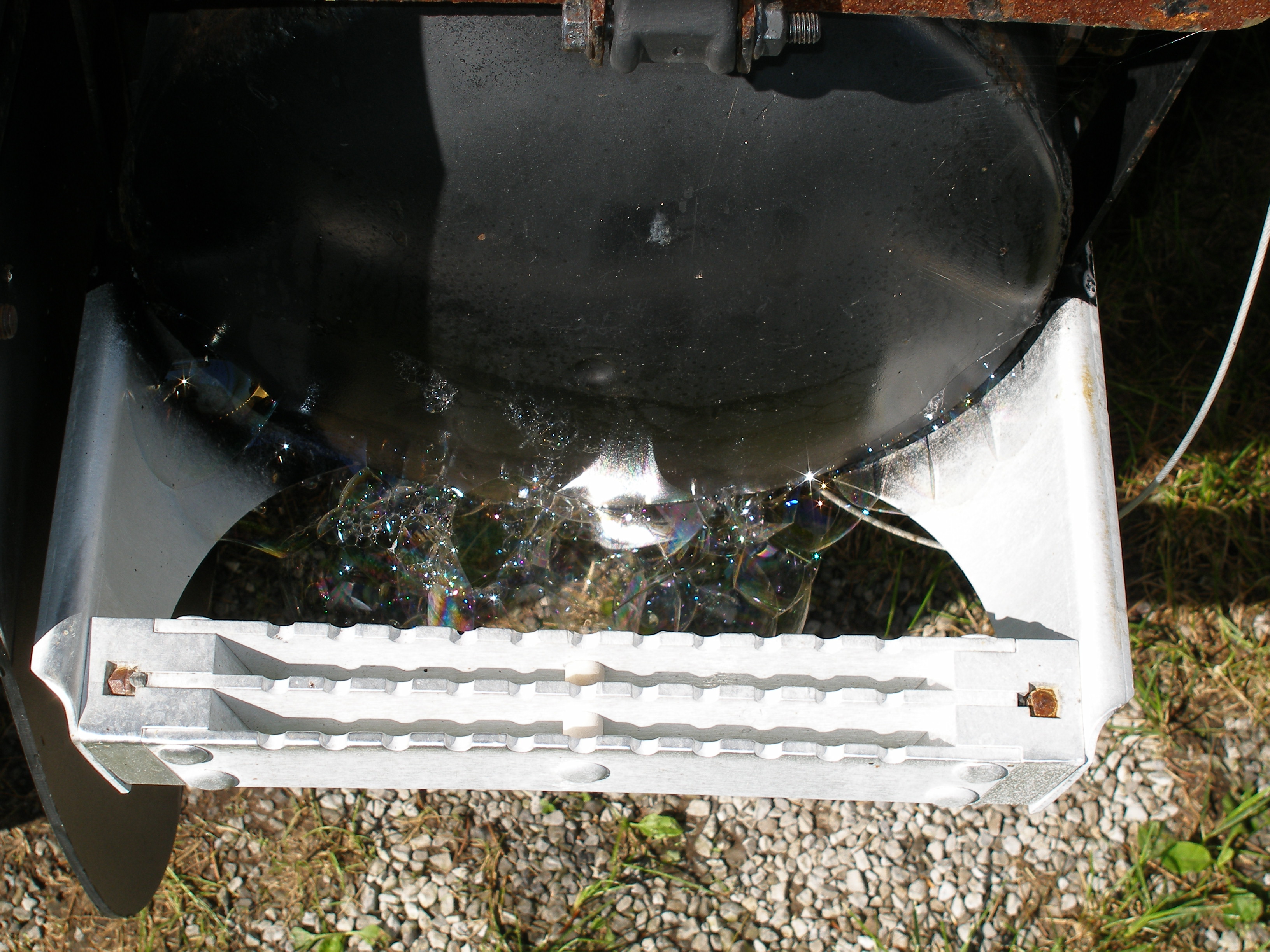

Air leak identified - LH air tank between tank and step...duh!

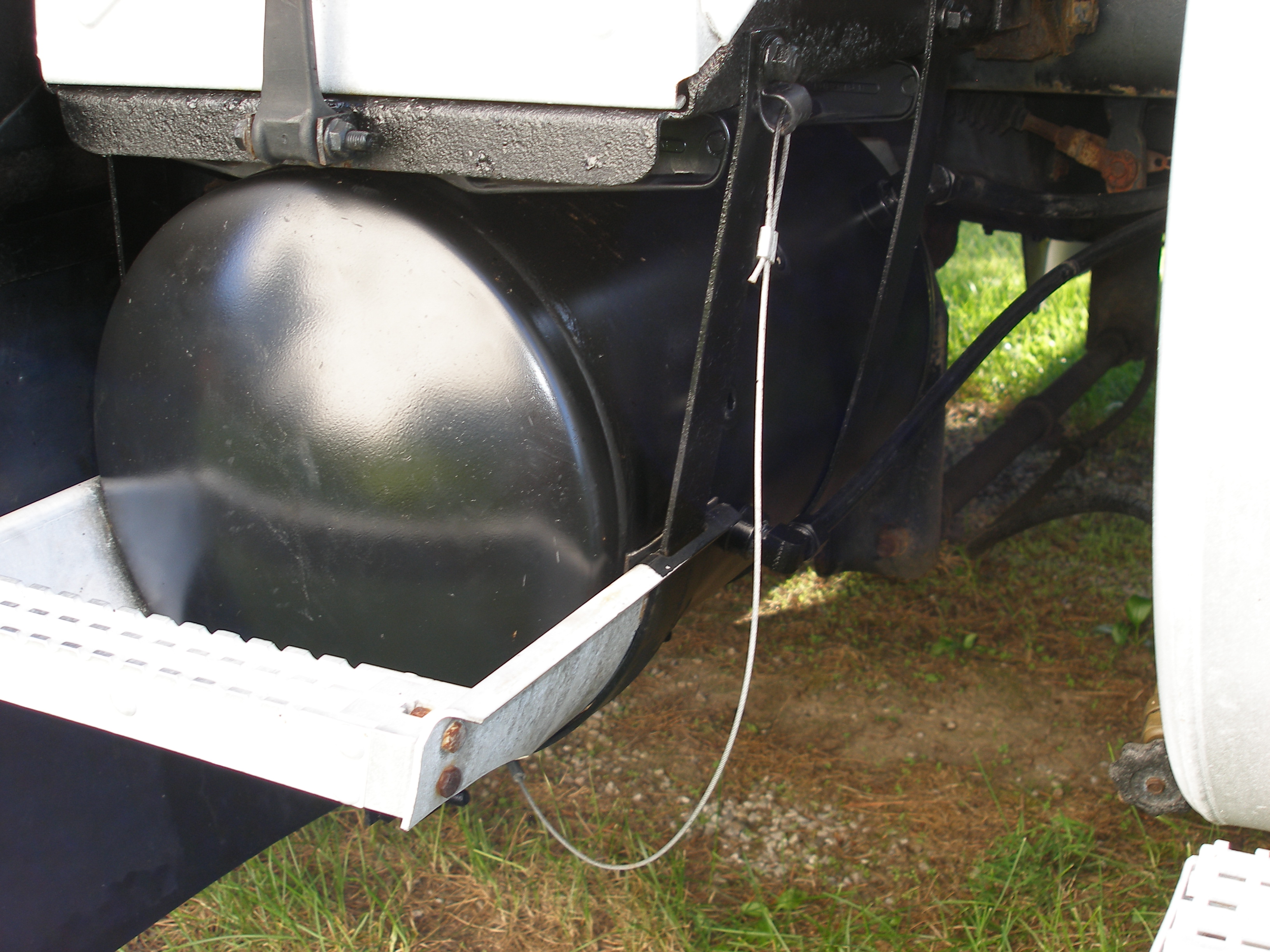

I was not able to drive the "roll hauler" in a deep or cement pond so I got out the trusty water/soap bottle.  Sprayed all the fittings and then soaked the tank at the step bracket (see photo).  I put my ear to the area and even before the bubbles started I could hear a slight air leak.  The bubbles confirmed what I suspected.  So definitely in the market for a nice used LH steel tank.

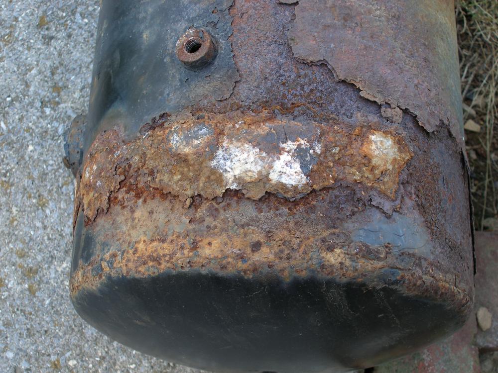

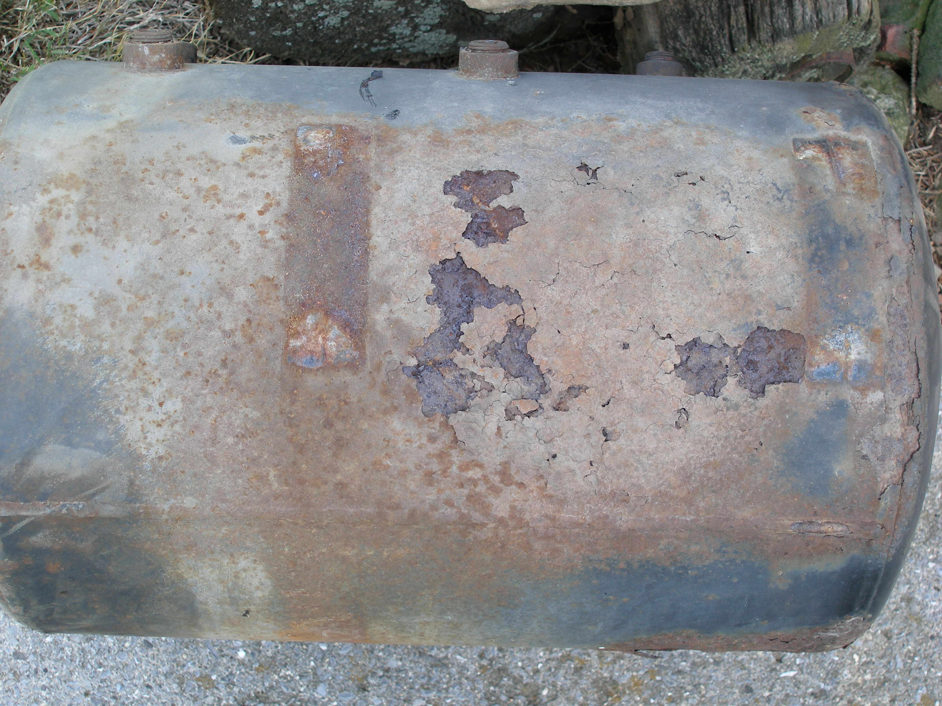

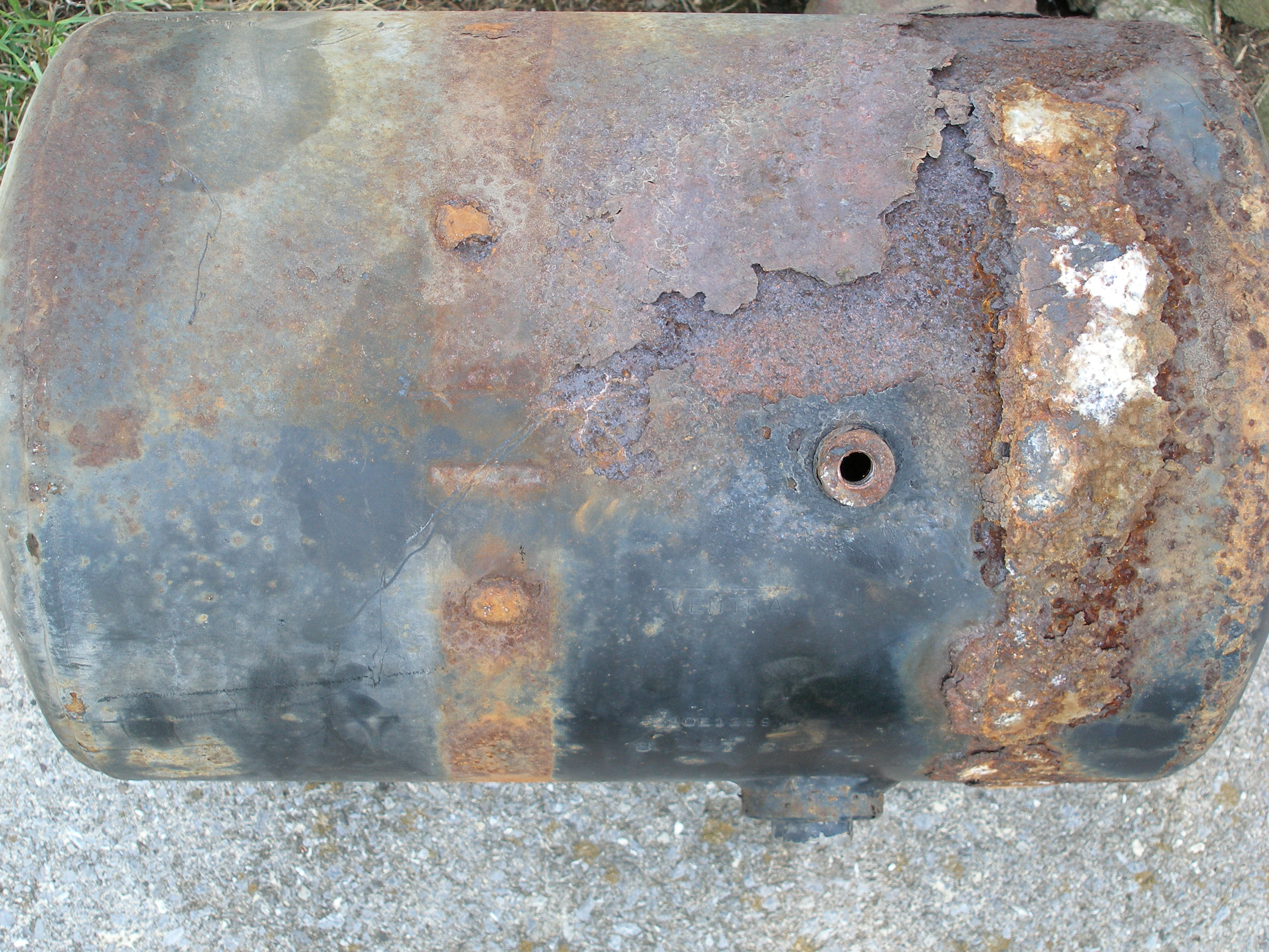

Ken, sorry to see the picture.
By the way I removed both air tanks from my MH being worry they could get holly some day and sandblasted them.
After that the left one went to the paint shop but the right one didn't.
I welded up 5-6 rusty spots I got condensed water leaks from after blasting but not sure it will live long.
Just want you to know any options on getting new tanks you've found to the moment.
And did anyone reskinned air tanks the way people do it to fuel ones?
Think we had a topic on air tanks before. Welding on air tanks is a bad idea.  Just as I would not weld up brake drums, Brakes and air is nothing to mess with. This is one part I would find good used ones or if new was available opt  for them even at the cost. Bought nice used aluminum 2 tank set for $250, each tank was $625-675 new each. I think if a DOT stop found welded up air tanks they would have it towed on the spot, with special instruction, as the tow air runs though the system too.  I have welded fuel tanks but they hold no pressure with no problems. :unsure:
