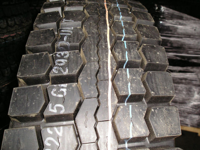

The tires on my B61 are junk and Im upgrading to the 22.5 size. I found a used set of Kumho 11r 22.5 non recaps all 8 matching drives with 25% tread. The guy wants $900 for them. Is this a fair price? My truck wont see many miles as its just a hobby truck any tires I put on it will go bad with age far before I wear the tread off.

$900 sounds like a lot for some mostly worn out tires but for your use it may not be too bad. 25% of what they cost new would be closer to $700 (I think the last 11r-22.5 tires I bought new were around $350 a piece but I got a pretty good deal on them).
If I were running the truck every day, I wouldn't even think about putting 25% tires on it.

That is just over $100 per tire I would look for something different for that kind of money you should be able to find at least 50% or better. Also look how old they are by the dot stamp code, if they are more than 6 years old I know some places around here check the age and don't want the casing for a recapping.
Check the tread depth minimum 2/32nds for drives and 4/32 for steers dot specs. Maybe they have more tread than "25%"

Kumho's are a cheap tire to begin with,at most the casing will bring $40.I'd hate to give more than $500 and make sure they are less than 5 yrs.old because in that case,the casing is worthless to retreaders,and you should get them cheaper yet.

those casings should be regroovable , so for a minimal charge you could have some good tires that would last a long time, and yes 900 for 8 tires of virgin casings sounds good to me but I'm used to buying 11r24.5 I know the low pro 22.5 are worth about 25 bucks a casing

Rerun truck tires shows the the Kumho 11.5R22.5 Drives start out with 10/32 thread depth, maybe he means 25% wear.
