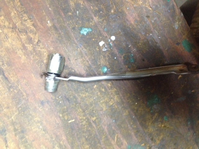

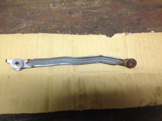

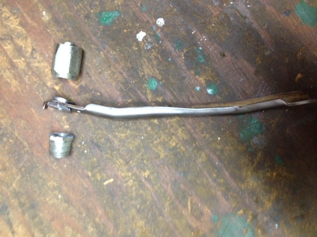

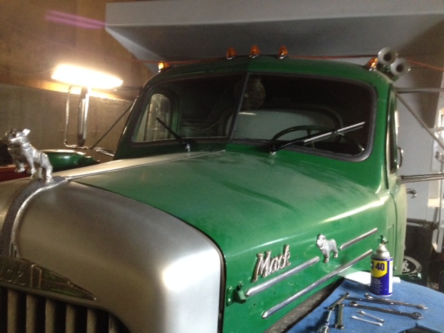

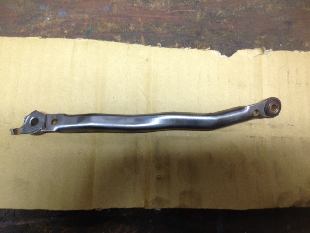

Wobblin-Goblin 817 Posted December 31, 2015 Author Share Posted December 31, 2015 Today's progress:1. The new windshield and rubber leaked, so I pulled out the spline and squirted goop under the rubber. Then I put the spline back in (easy to do with WD40 lubing things up). It looks good and I'll bet it won't leak any more.2. Installed door hinge covers that I bought from Roser a short while back. After cleaning them up with a wire brush attachment on my hand-held grinder, I primed and painted them. Primed and painted the screws, too. The covers and fasteners look good, too.3. Installed a mud flap on the driver's side in between the battery box and rear axle to cut down on stuff hitting the back of the cab and battery box. Passenger side will come tomorrow (hopefully).4. The actuating arm (connecting arm) that operates the passenger side wiper was missing its bushing, so we made one out of brake air line fittings because the wiper shaft would fit the hollow inside. We had to hack saw off most of each (the bolt and nut portions) to make it thin enough to fit on the shaft and still allow the clip to fit on the end of the shaft, holding the arm in place.It was a very profitable day. One by one the items on the "finish up 'Mater" list are getting done. Quote Link to post Share on other sites

Wobblin-Goblin 817 Posted January 5, 2016 Author Share Posted January 5, 2016 Today's progress:1. Installed the wiper actuating arm (under the dash).2. Installed the wipers themselves and adjusted them. I now have functional wipers.3. Installed a manual shut-off valve on the air filler for the air tank. This way, I can turn air on or off easily while charging the tanks from an outside air compressor. Quote Link to post Share on other sites

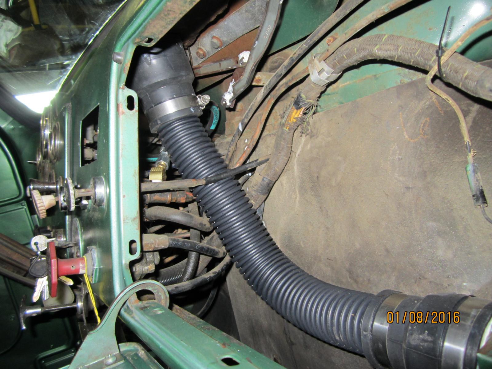

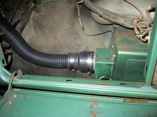

Popular Post Wobblin-Goblin 817 Posted January 9, 2016 Author Popular Post Share Posted January 9, 2016 Today's progress:1. Finished up the exhaust. The old (original?) support bracket failed, causing the new 4" exhaust to fall off the manifold. Bracket is replaced with new and exhaust is now up and tight to the manifold. Cab is quieter and no more smoke inside.2. Finished the defroster. I had to re-route the main air line behind the dash to fit the defroster hose. Also, could not find 2.5" flexible hose anywhere (I even thought about using the hose from a shop-vac), so I bought 1.5" sump pump hose and used two rubber fittings to neck each end down to the 1.5" diameter hose. Once it was all done, we tested it out and it works well, with plenty of air being moved and put on the windshield.All that's left is to put in an air brake switch, get the radiator shutters working again, and paint the rear wheels, then 'Mater is done. 4 Quote Link to post Share on other sites

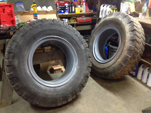

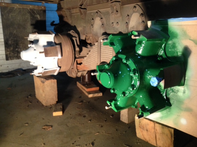

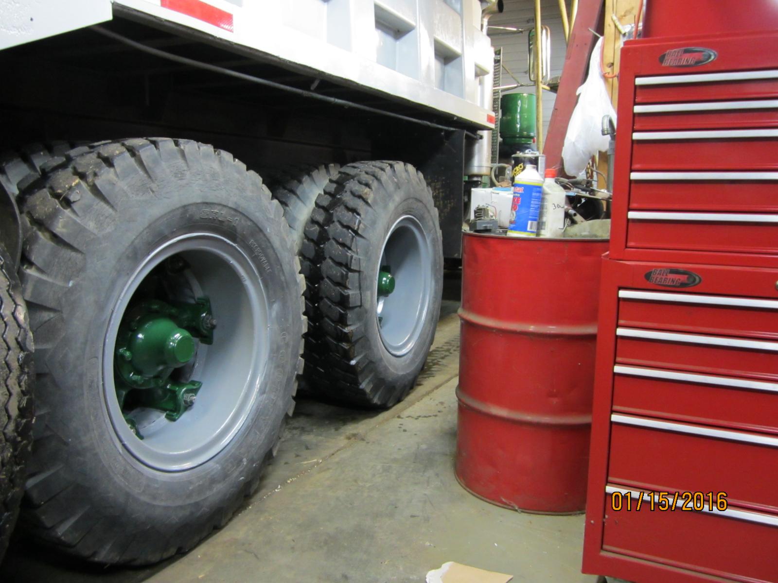

Wobblin-Goblin 817 Posted January 12, 2016 Author Share Posted January 12, 2016 Yesterday I changed the oil and oil filter and pulled all the rear wheels off the right side of the truck. Today I cleaned, primed, and painted the wheels, clamps, and nuts. Tomorrow, I plan on cleaning the right rear spokes and priming and painting them. Quote Link to post Share on other sites

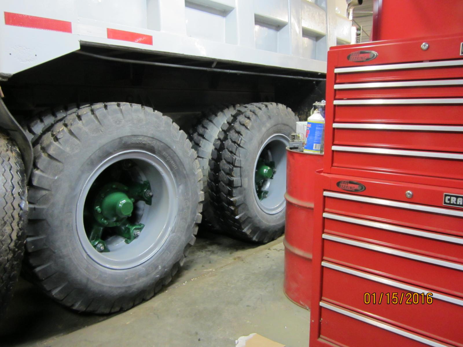

Popular Post Wobblin-Goblin 817 Posted January 14, 2016 Author Popular Post Share Posted January 14, 2016 Everything but one set of spokes is completely painted (right side only). 4 Quote Link to post Share on other sites

Wobblin-Goblin 817 Posted January 15, 2016 Author Share Posted January 15, 2016 Not much left on your list anymore.Nope. Getting close to being done.BTW, I went back to the garage tonight to finish up the second set of spokes. Now everything on the right side is painted (spokes, wheels, clamps, and nuts). Sometime tomorrow I'd like to mount the wheels back on and then start working on the left side to finish off all the painting. Quote Link to post Share on other sites

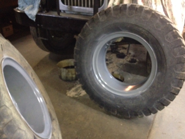

Popular Post Wobblin-Goblin 817 Posted January 15, 2016 Author Popular Post Share Posted January 15, 2016 Right side is all done. 5 Quote Link to post Share on other sites
