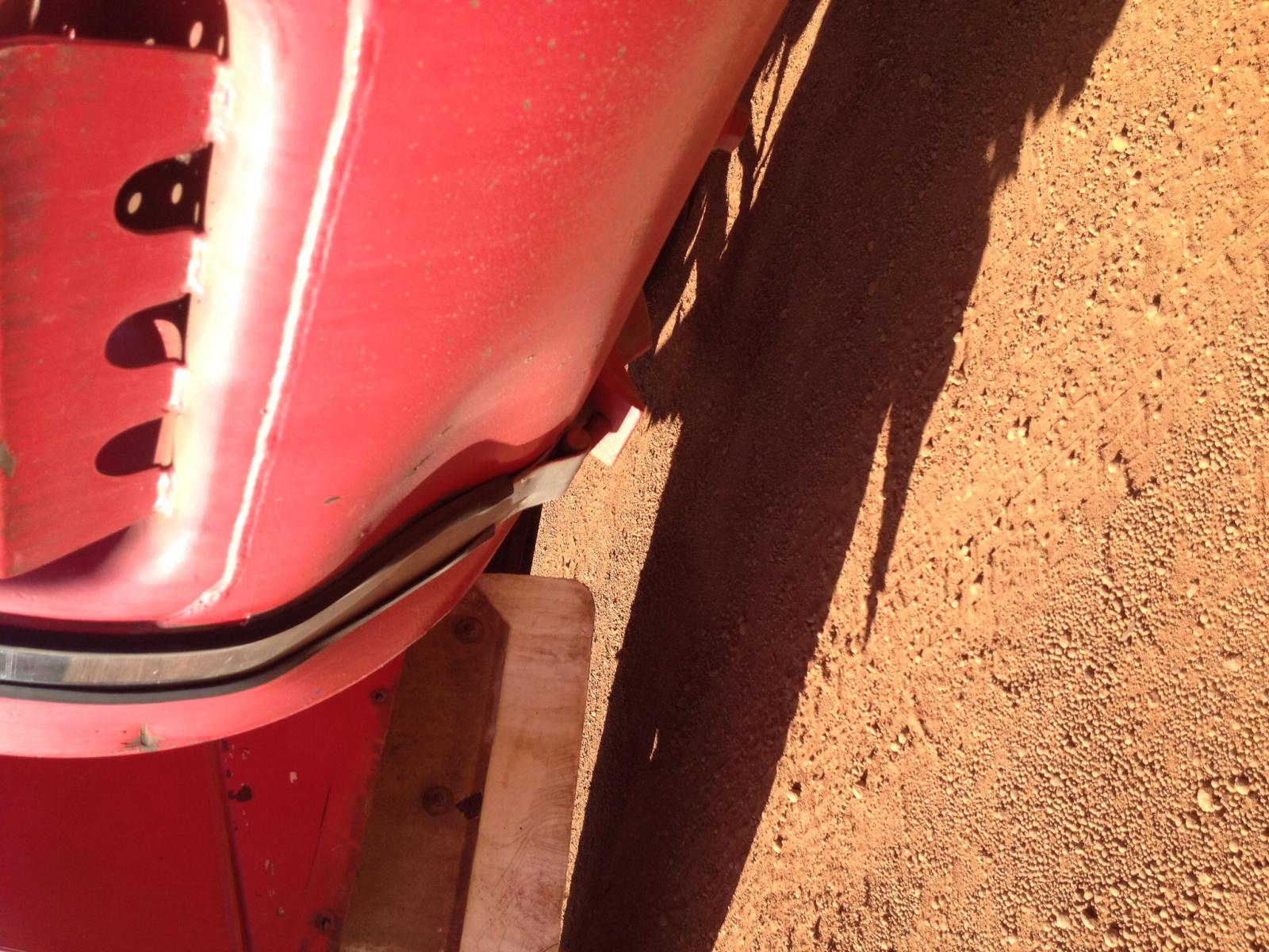

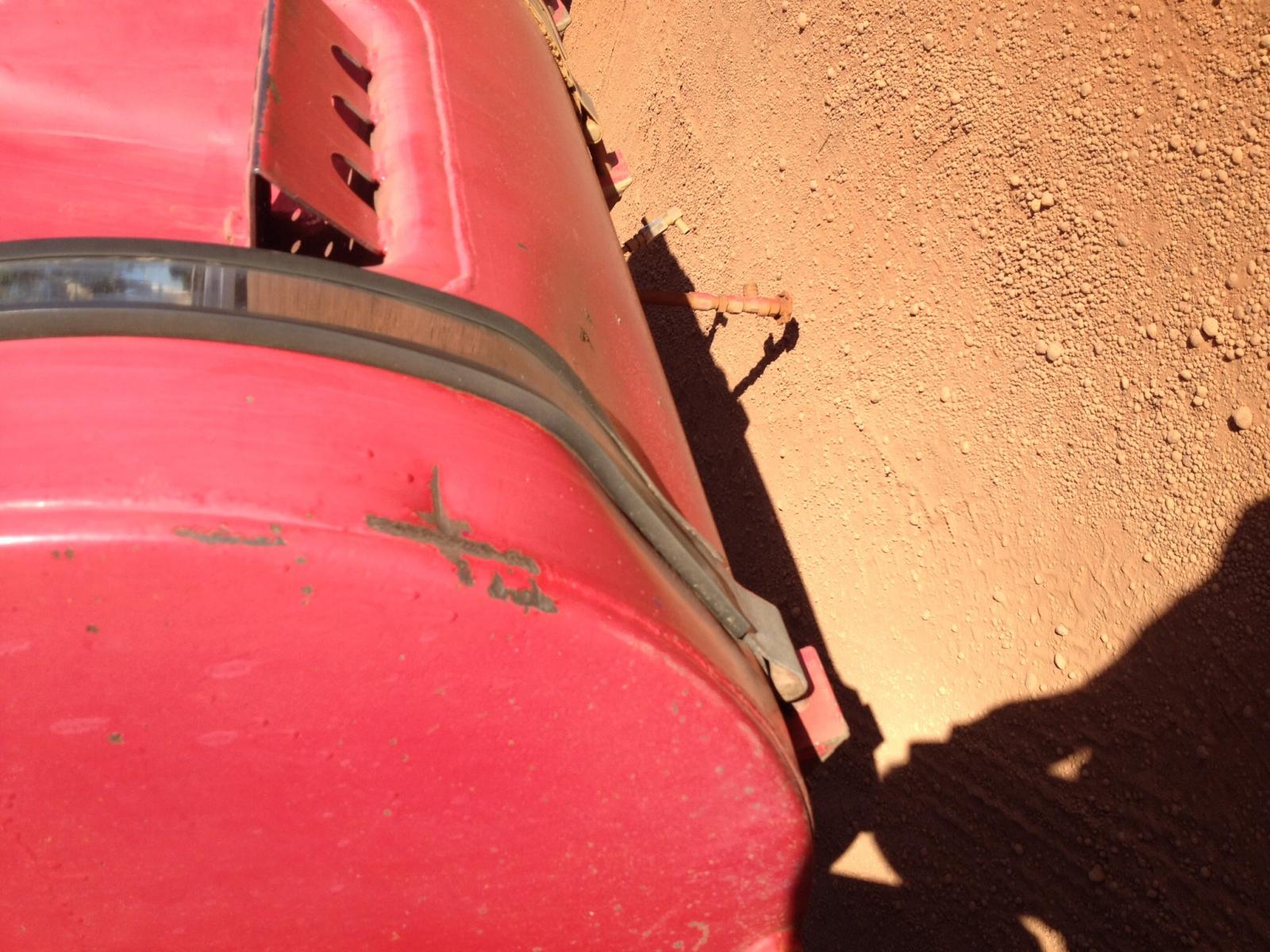

This is an otherwise straight fuel tank. It's let down by this one, rather decent size dent. Just after some options on how to remove it...
I know I could just bog it up, and that will be my last resort.
But was hoping for some more suggestions, so hit me guys!

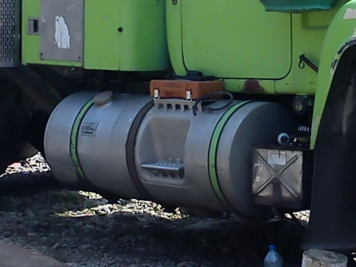

I've been researching methods for this too. Mine has a little more damage than yours but I found a thread on the Brockway sight where they cut the end off an aluminum tank at the weld seem, punded out the dents and zipped it back up.
you can find it here a few post down the page http://www.brockwaytrucks.org/messageboard/viewtopic.php?f=1&t=1044&start=220

The RHS tank has had metal strips welded under the tank straps where it would have rusted/corroded away. So I'll be sure to check this tank out, thanks for the heads up.

So just to update on this, under the tank straps has started to rust. Cleaned it up and it's pitted the steel a bit. Anyone know what thickness the steel used in tese tanks are?
Anyway I'm not going to cut corners, the end will be coming off and an internal inspection done. Fingers crossed all goes well. I appreciate all the feed back.

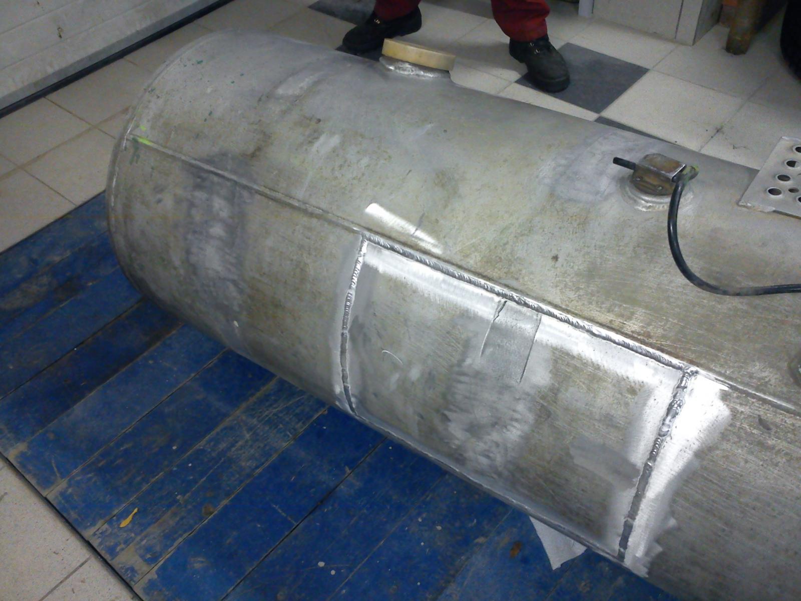

As about welding I also was first told from the shop where the guys were skilly with aluminium to cut off the end.
Although I was absolutely disagreed with that solution due to high chances to get terrible outlook with no way to change it back.
So I directed them to make the cut out from the back side of the tank, frame side.
The reason to come in was the inside cross wall was off its place laying on the tank's bottom and required to be welded up back.
post-3971-0-61408000-1393413643_thumb.jp
