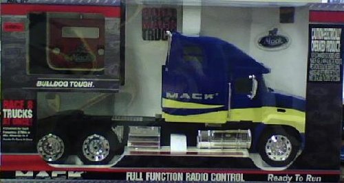

That's really something Trent! and some nice work too! that will be neat to see when its done! I have a similar project (though not quite as ambitious!) I have one of these RC toys I have taken apart with the intent of making a version of my 1:1 CX out of it,basically just paint and detail,but im still working on the fairings for the lower body....................................Mark
