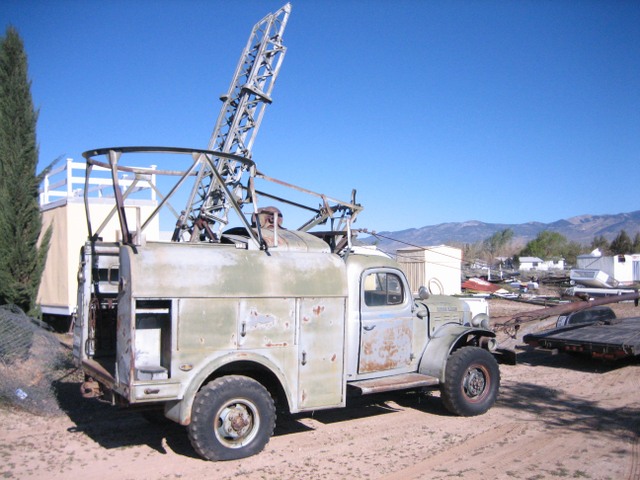

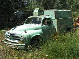

I see its got a "utility periscope" on the roof like the old Bell Telephone service trucks had.

I was wondering what that thing on the roof was for, or if I was seeing something wrong in the photos. What was the purpose of it?

You could view above the truck cab to position the ladder, auger or other equipment under area you had to work and to also make sure it was all retracted when you moved. From the time when one person could do the entire job. P aul

Thanks for clearing that up - I bet they were forced to come out with those after Jim-bob came back to the warehouse one night with a hole in the cab roof he cut with a chopping axe so he could see what he was doing!
I'd leave it. They were also installed on the military Utility Service trucks, AirCraft fueling units and CARDOX equipted Firetrucks. I'll wager when you get the Mack report on your truck you will find it was a military spec unit for Stateside service, Civil Defense or a C.C.C. /W.P.A unit. I'll copy some DOD photos for you. Paul
