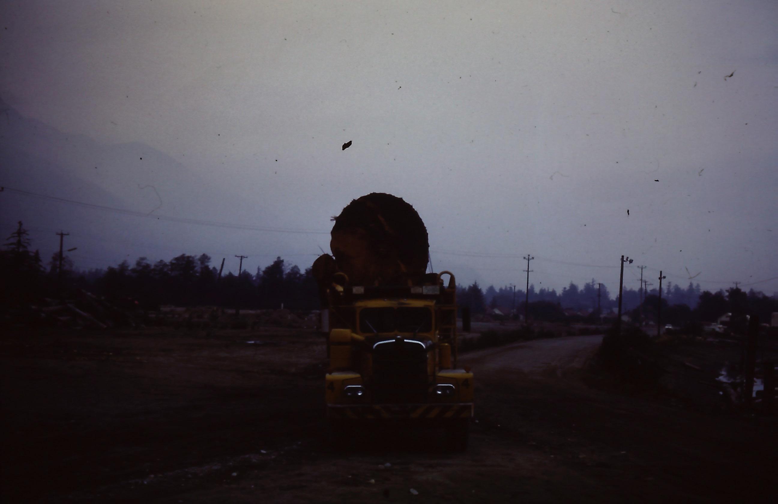

Agreed, back when a trucker was a TRUCKER, no PS, no AC, no air ride, no power, twin sticks double clutching every gear. My dad started hauling logs on the west coast in the mid 60's, this truck, IIRC had a 275 cummins, 5&4 but then got a "big power" transplant...... a 315 cummins. He had to have his hip replaced I think in the early 2000's and the surgeon looked at the X-rays and said "Truck driver eh?". Dad said "yes, how did you know that?", doctor, "the way your left hip is wore out is common among ling time drivers that double clutch every gear. I remember dad saying once he thought he would count his shifts on a trip, stopped counting at 200 and IIRC he was still on the way IN. More power reduces that number considerably, especially when driving west coast logging roads.TetachukSlides252.thumb.jpg.f1516a5294937604758de1c55ef247de.jpg
The biggest improvement to ride quality was the elimination of B-B length laws. My back-up tractor was spring and if loaded correctly road as good as the other two. Belly load it and it would beat you to death, split or uniform load the deck and it road fine.
 Even my Fleetstar with walking beam would ride well loaded, but with the short wheelbase and light tractor, would launch you empty over the bumps. It only have an old Viking T bar seat.
