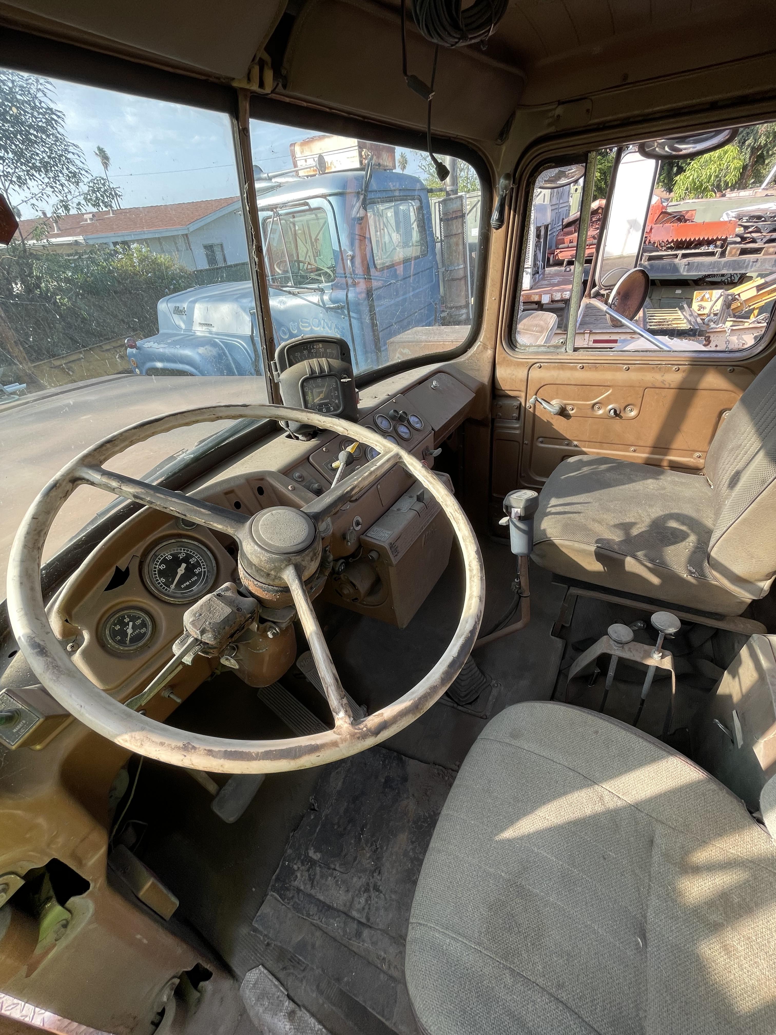

As with all old trucks it has a few issues.
The passenger side widows are smashed and need to be replaced, is r model glass readily available?

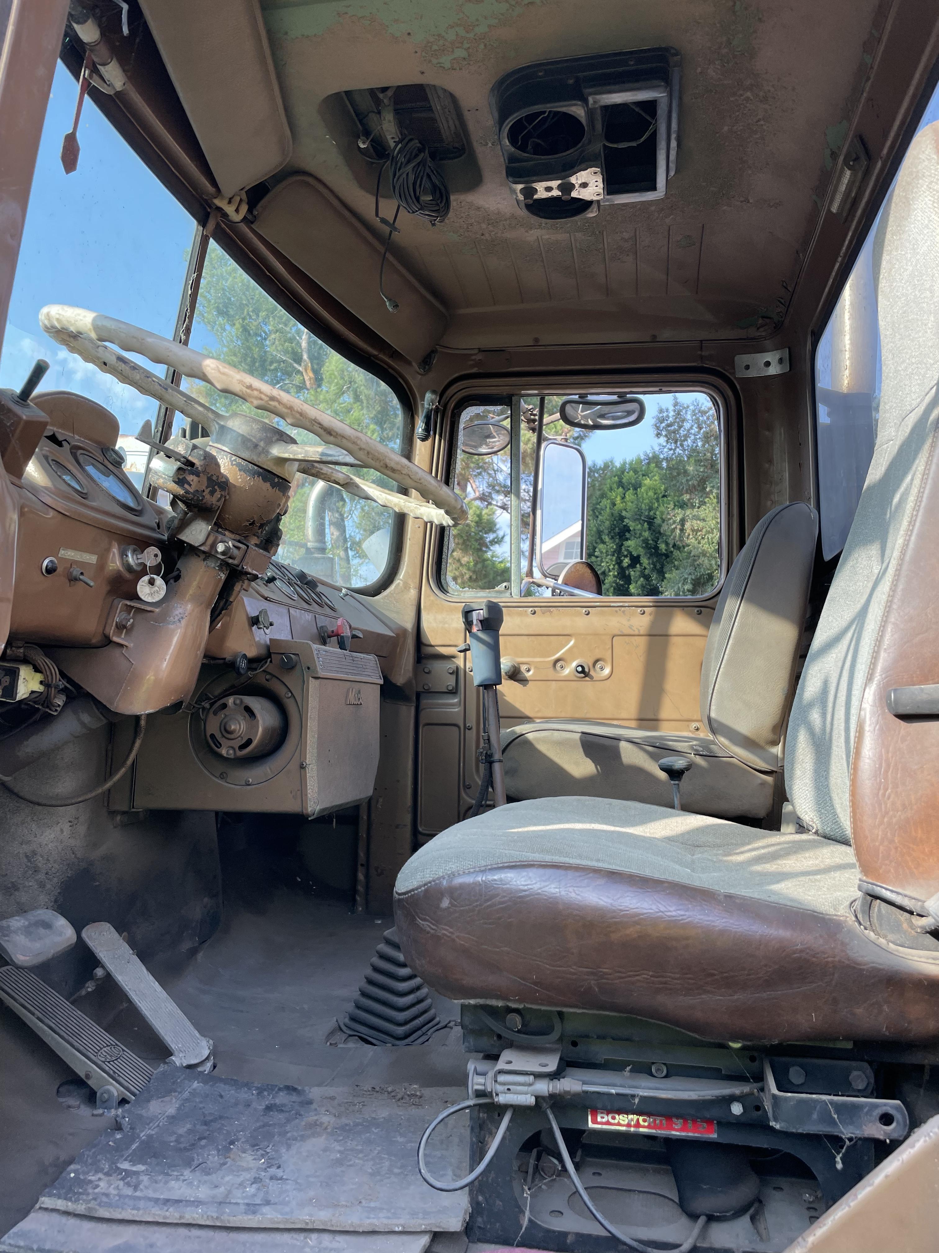

The plastic dash panel with the tach is busted. I was thinking about putting in a standard speedometer and removing the tachograph.

The Sangamo Tachograph looks like it should be mounted in the dash to the right of the tachometer. But where it is now was a common spot for them. My MB had one mounted on a 1" X ? length of pipe wielded to plate steel on the dog house. Speedometer cable came thru a hole near the shifter tower. Have two of them, should mount one of 'em where it once was.    .....Hippy

I have never seen one of those plastic gauge plates I have the steel parts somewhere if you need them I’m not sure if I can find them amongst all my shit .. Bob
I need the visor or what ever you call the part that goes between the dash and the instrument panel for both R700’s and for this truck I need the speedometer and dash panel, or a good tracing so I can mak my own panel that will only hold the tach, speedometer, air pressure gauge and a warning light
