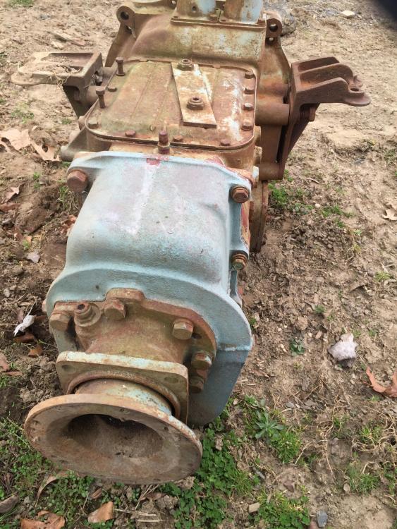

21 hours ago, mechohaulic said:
possibly but he states it's in the DM 607 he posted a picture of. a DM607 wouldn't be gas ??   711 or 673 non-turbo . green interior from picture. i'm thinking early DM. not saying trans wasn't changed ;; who would change dash shift  pattern.
I remember once seeing an early DM  It didn't have any dash pattern. It had a 673 and what as best I could tell was a quadraplex. I remember the compound was backwards if you tried to drive it ???  It looked about the size of something from a pickup truck , now I'm wondering if that's what it was .

I do recall dash shift patterns that had two spots backwards. never paid that much attention as to why. i wasn't in to numbers that much(TRQ/TRD etc ) then . main motto was ;; if it's broke fix it . once had a customer that missed a shift on a hill ::mack F-600 with duplex. shattered the back half. he "acquired "another 10 speed from a competitor down the road. using a backhoe i pulled the trans, swapped parts to make a good one . installed alone;; any idea of trips from backhoe to truck lining up the trans . point is there was a big difference in front/ rear half ratio afterwards. he complained , i said then don't steal the next one buy the right parts! LOL

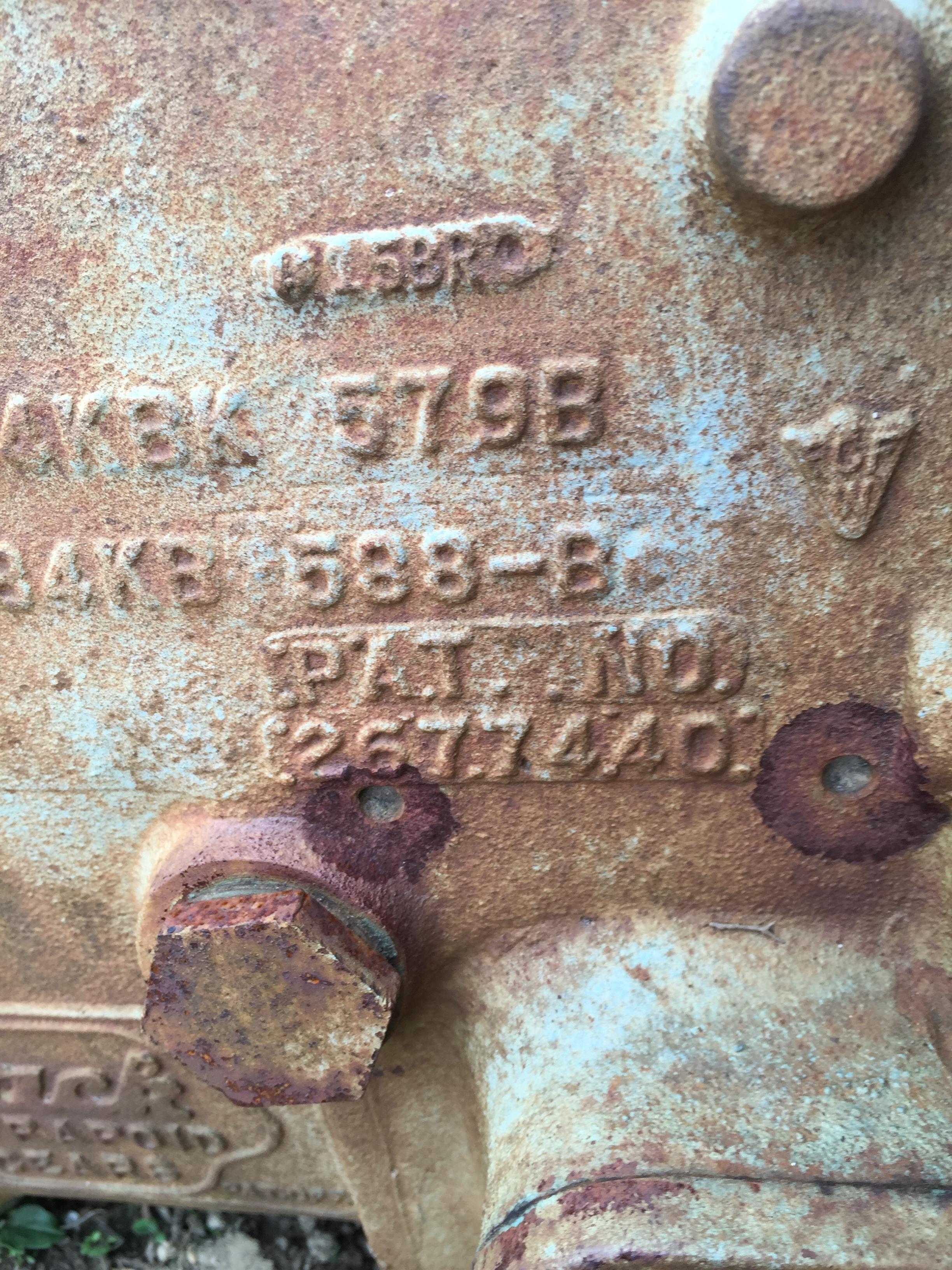

Just now, mechohaulic said:
can't read side stamped numbers  . will try and acquire it if some one can use it. it's in CT. if i can get it for zero ; that's what i'll ask for it. hate to see it sit and rust away or worse ;;; scrapped

1 minute ago, mechohaulic said:
I think that's it.  I had no idea what it was (lol) I'd have sworn it had a position where lo split would have been .  It was a weird truck.  had big cast housings with little bitty axles and some odd rear springs

You know to tell you the truth I haven’t driven the truck on the road for 27 years and now I’m not even sure about what transmission I got but it’s junk slips out of fifth main box and I’m putting the  quad box in it that I bought and yes it’s a turbo end673t. Bob
when you see an old trans where 4 and 5 are swapped, that is a tell tale of an overdrive trans. as in 13 over or 15 over.

now this post has my curiosity going . weather in ct gets above 40 i'll take a ride to farm ;; try for side numbers ; and see if i can save it from scrap yard. hopefully i can get it. might bring it home and take it apart  to remember the good ole days..
This is an old Mack transmission. The compound was like the one in the dash of that DM.  I didn't know what it was . I don't think Mack main boxes were backwards if they had an overgear. Just the compound I thought
