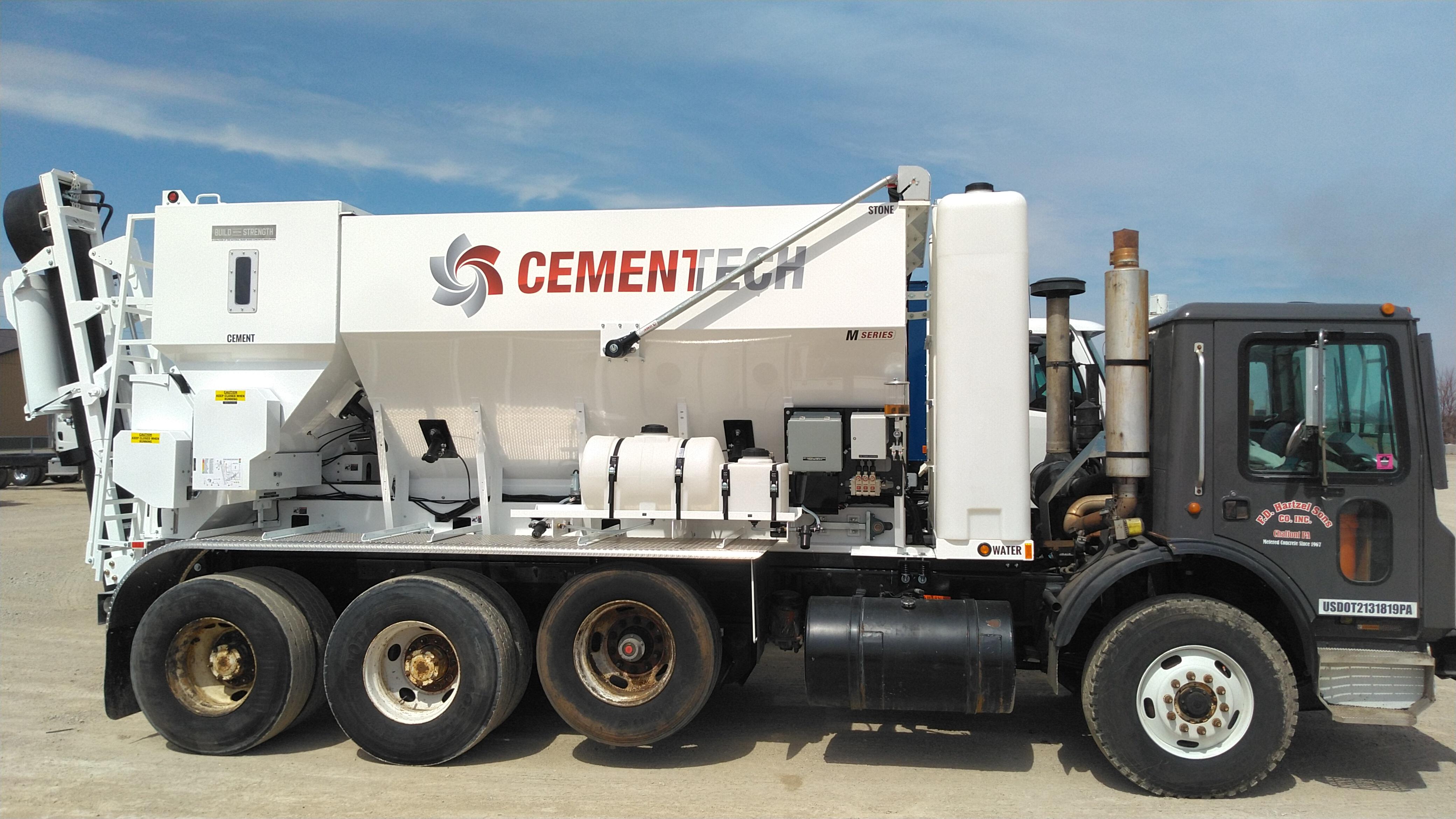

Flew out to Iowa yesterday, picked up the truck and ran around town getting the "hope I don't need this" Kit they don't let you fly with.  KIMG0746.thumb.JPG.815382f89f26db88df34bc27a598ad03.JPG
In the factory's yardKIMG0748.thumb.JPG.e0f5b911aeafac34f665c3e8b0af4e8f.JPG

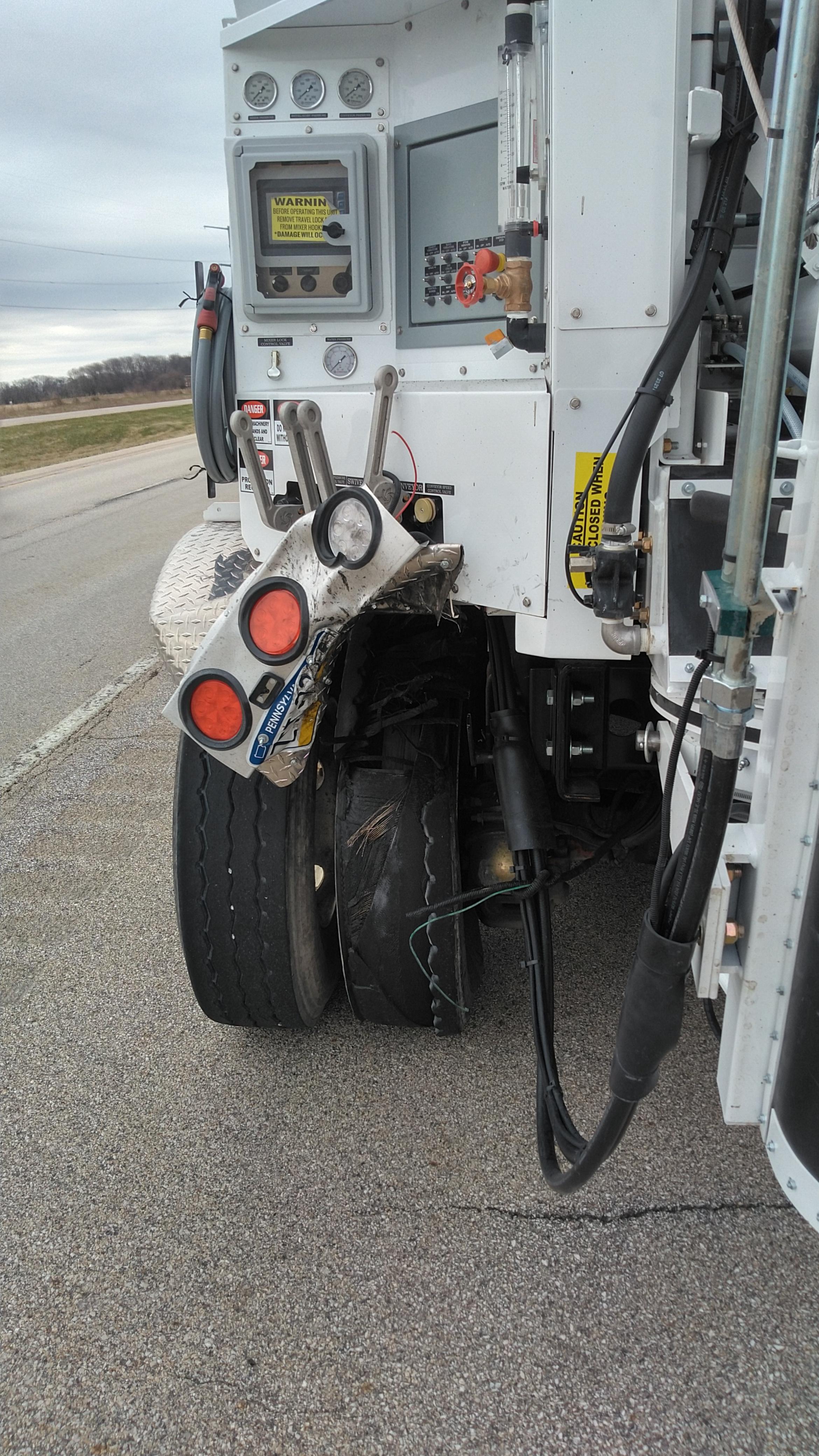

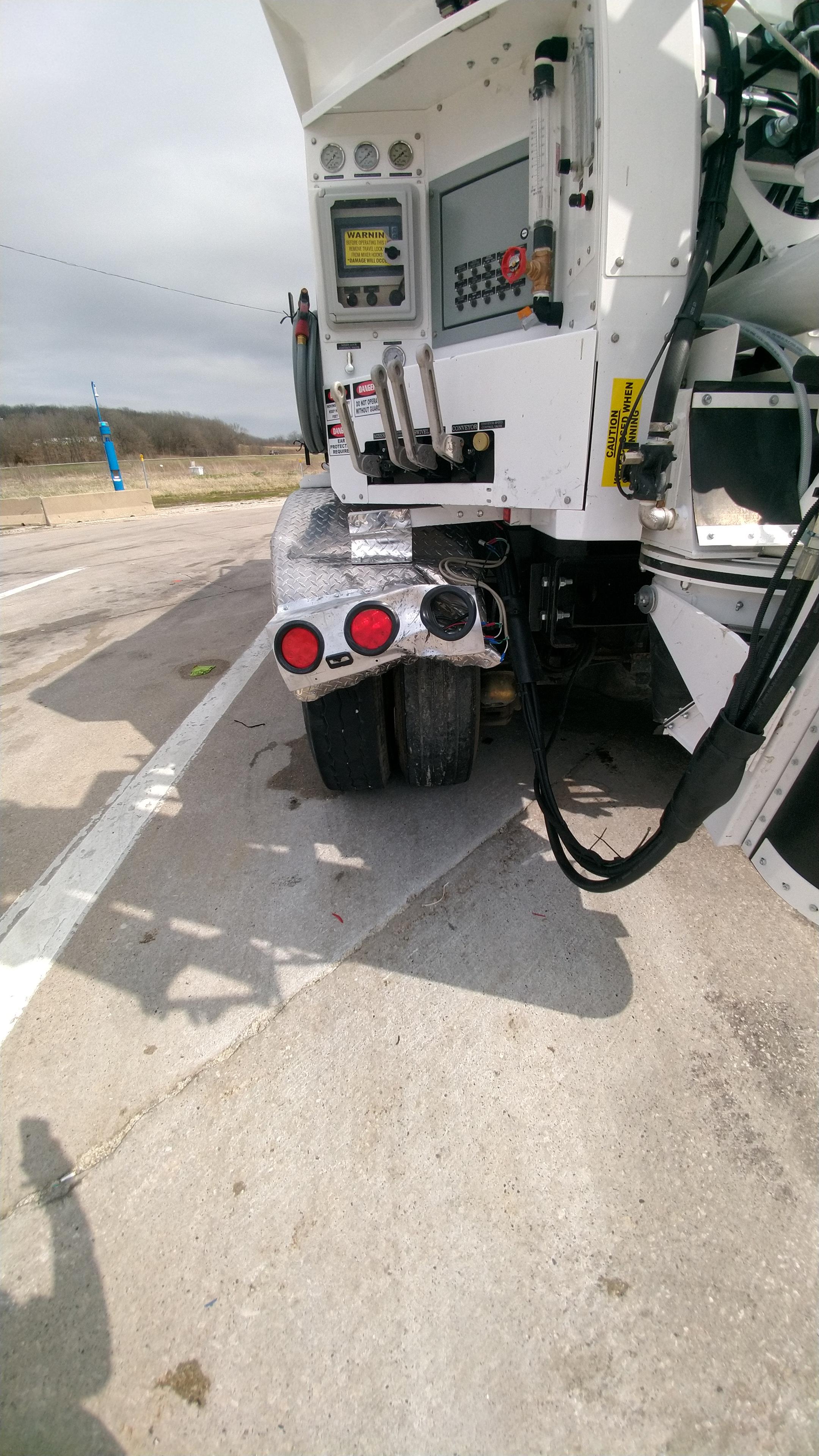

On the side of Interstate 74 near Knoxville, IL.KIMG0752.thumb.JPG.ba1e1a1d6fa8c148b68d3cbb33c5149e.JPG
Shout out to mobile mechanics like our own @Joey MackMack, they keep truck's rolling!  We stole a lift axle tire for the drive positions, took the lights out then bent/beat the fender into submission, put the lights in and he wired it back up!  License plate is now in the cab, it looks like shit!
  • Sad 2
Controls are mostly ok, minor damage to (very easily replaced/fabricated) brackets holding the levers. Truck will get our steel diamond plate fenders pretty quick. I knew these chinsy aluminum ones would be a problem, was just hoping it wouldn't have been this soon!

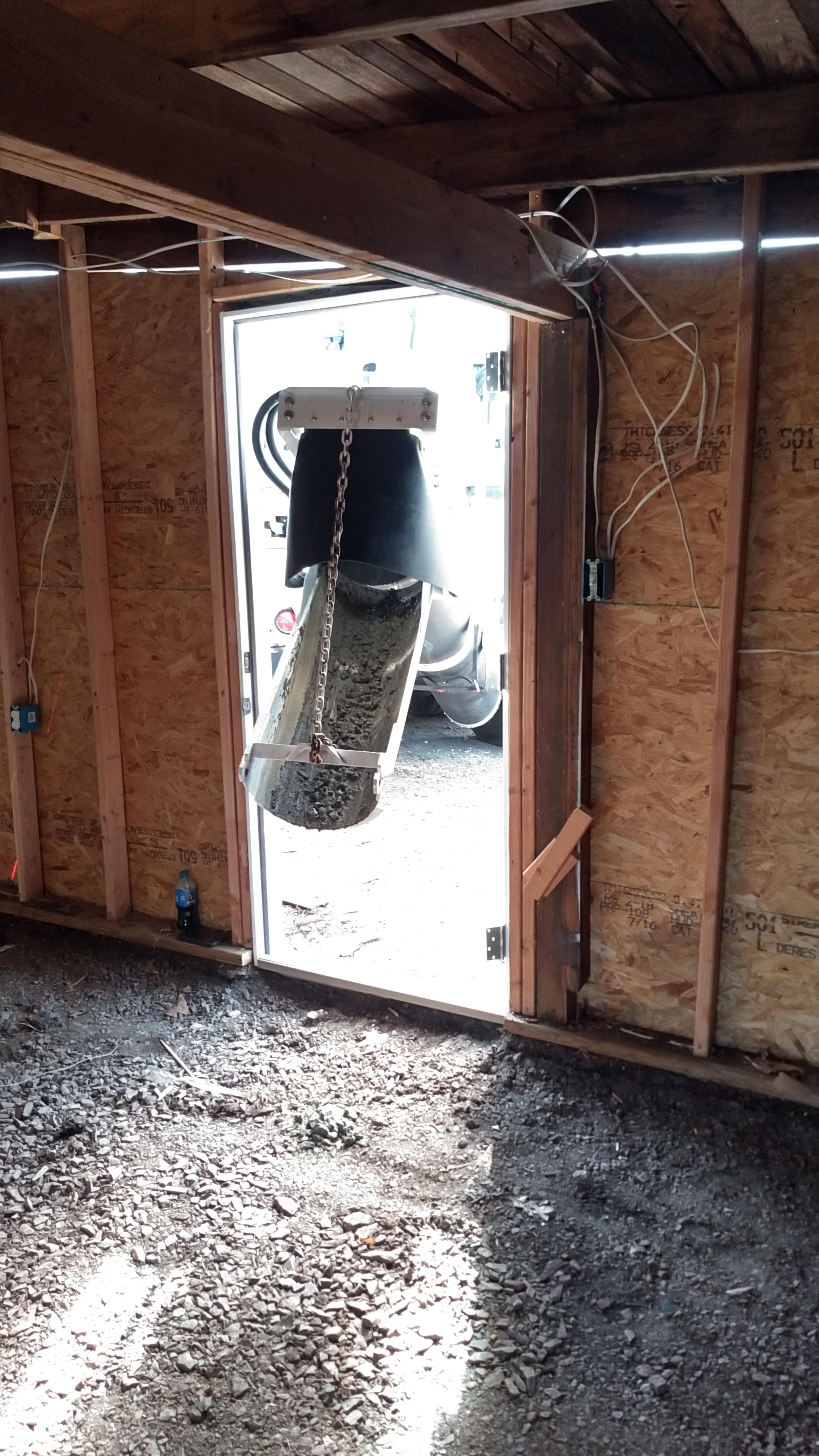

Filling wheelbarrows at a job
