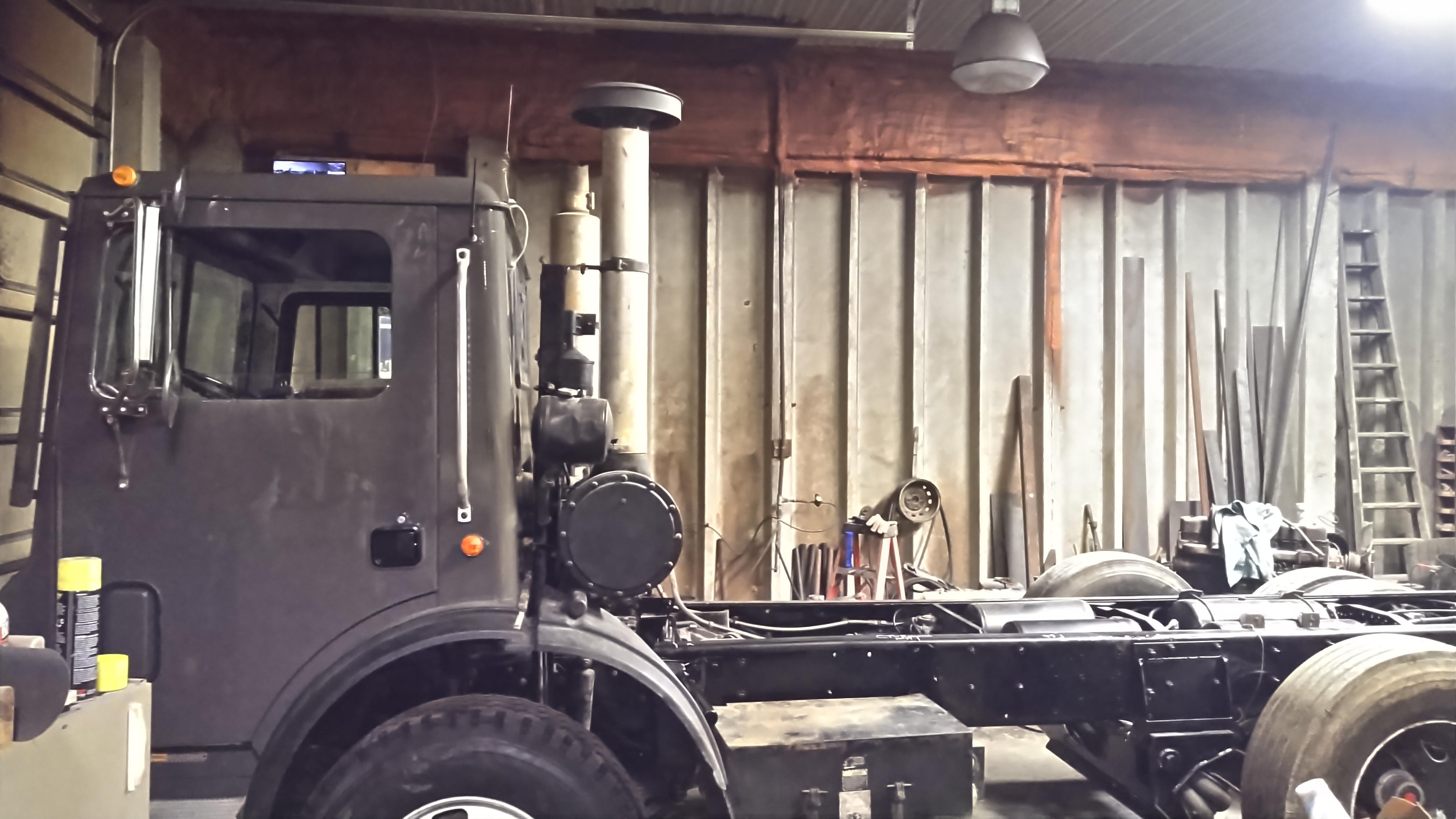

Trash trucks and concrete pumps. Same here.  The CemenTech mixer on a conventional cab would be about 3 ft longer than the RD model in the background, which has a 228" wheelbase and steers like the Titanic.

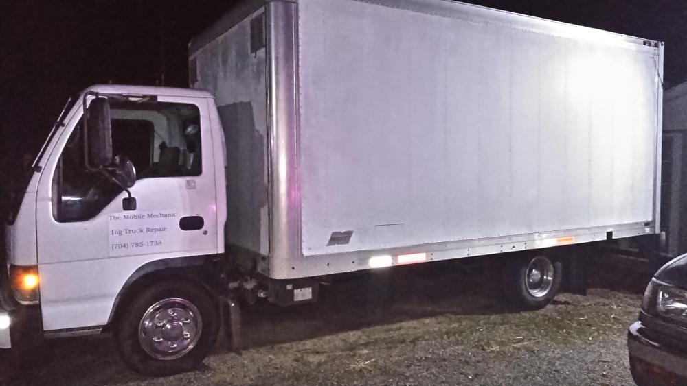

I drive an Isuzu NPR with a 16" box as my service truck. I love the maneuverability. However, I would love to have an MR with an E-7 or Early E-tech as my service truck.. It would be 'overbuilt' and that would suit me just fine..
Plus you would look real cool at all times… Bob

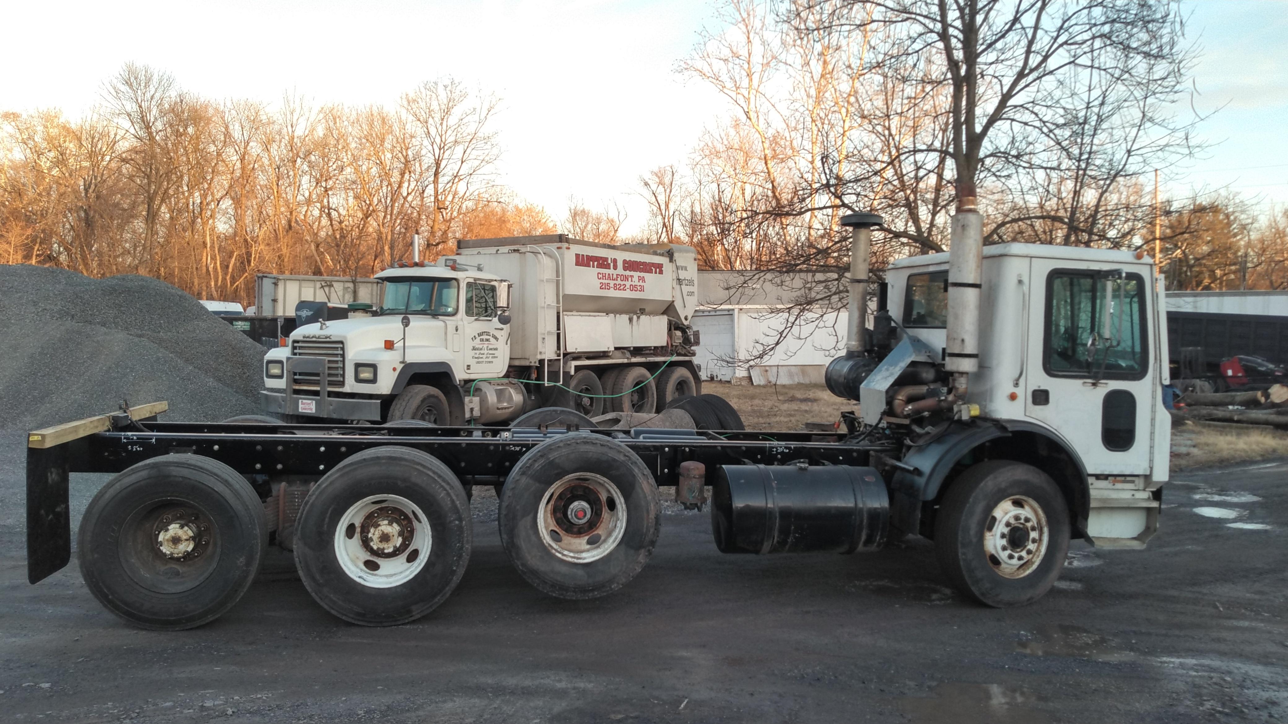

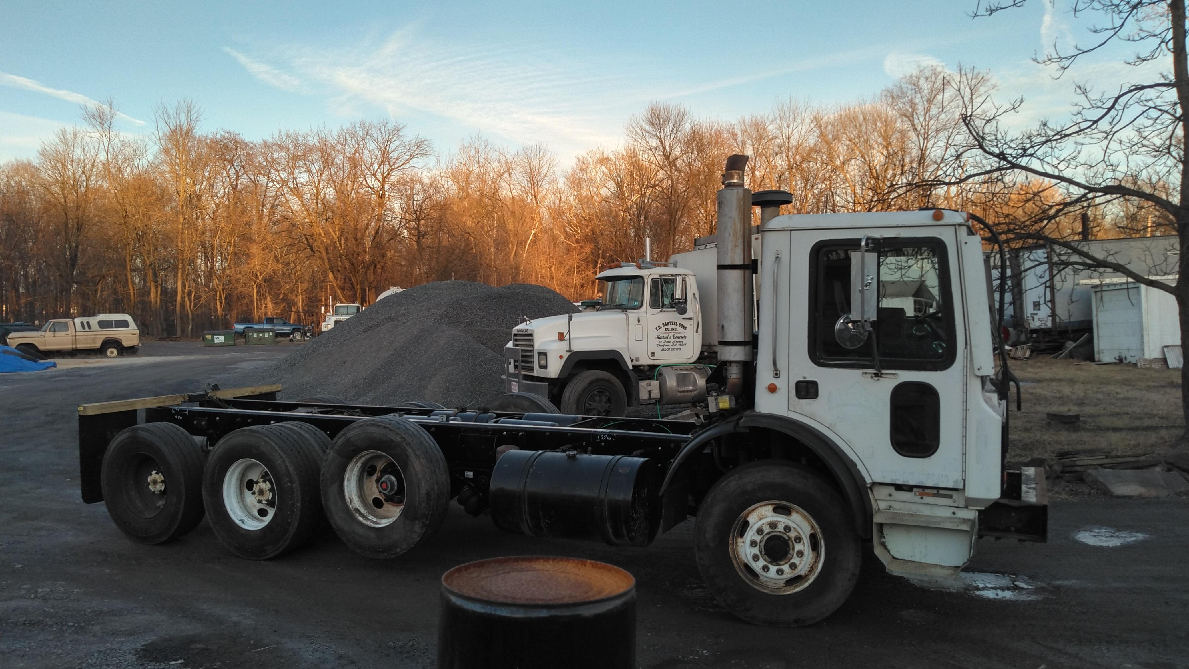

Is the RD the formerly green tri-axle dump that you had posted about previously @JoeH?  Looks sharp!
That's our 228" wheelbase Titanic, 1995.  It was white with green accents. We have a 1988 RD that was an H&K Locust Ridge truck, that was green. It's white now. The H&K truck has a 218" wheelbase and steers night and day better than the '95, but we have yet to complete the '88 project, so it's just sitting at the yard.

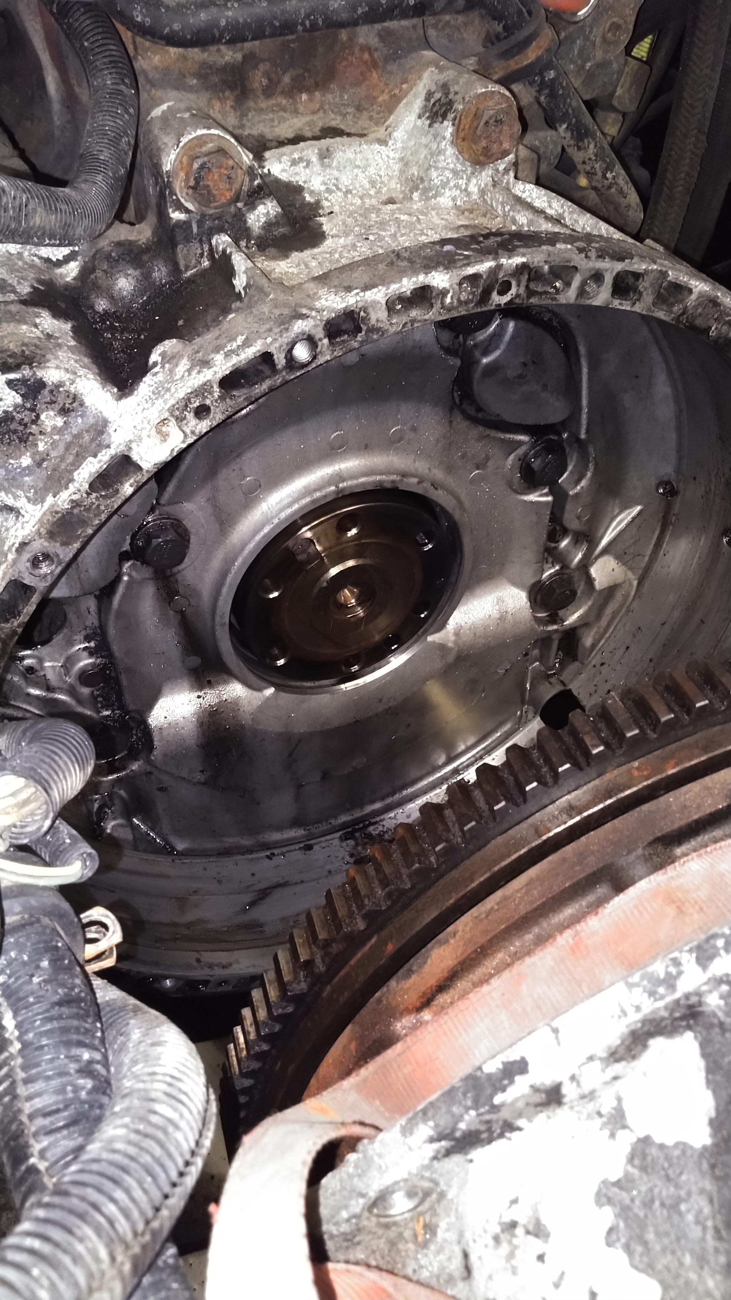

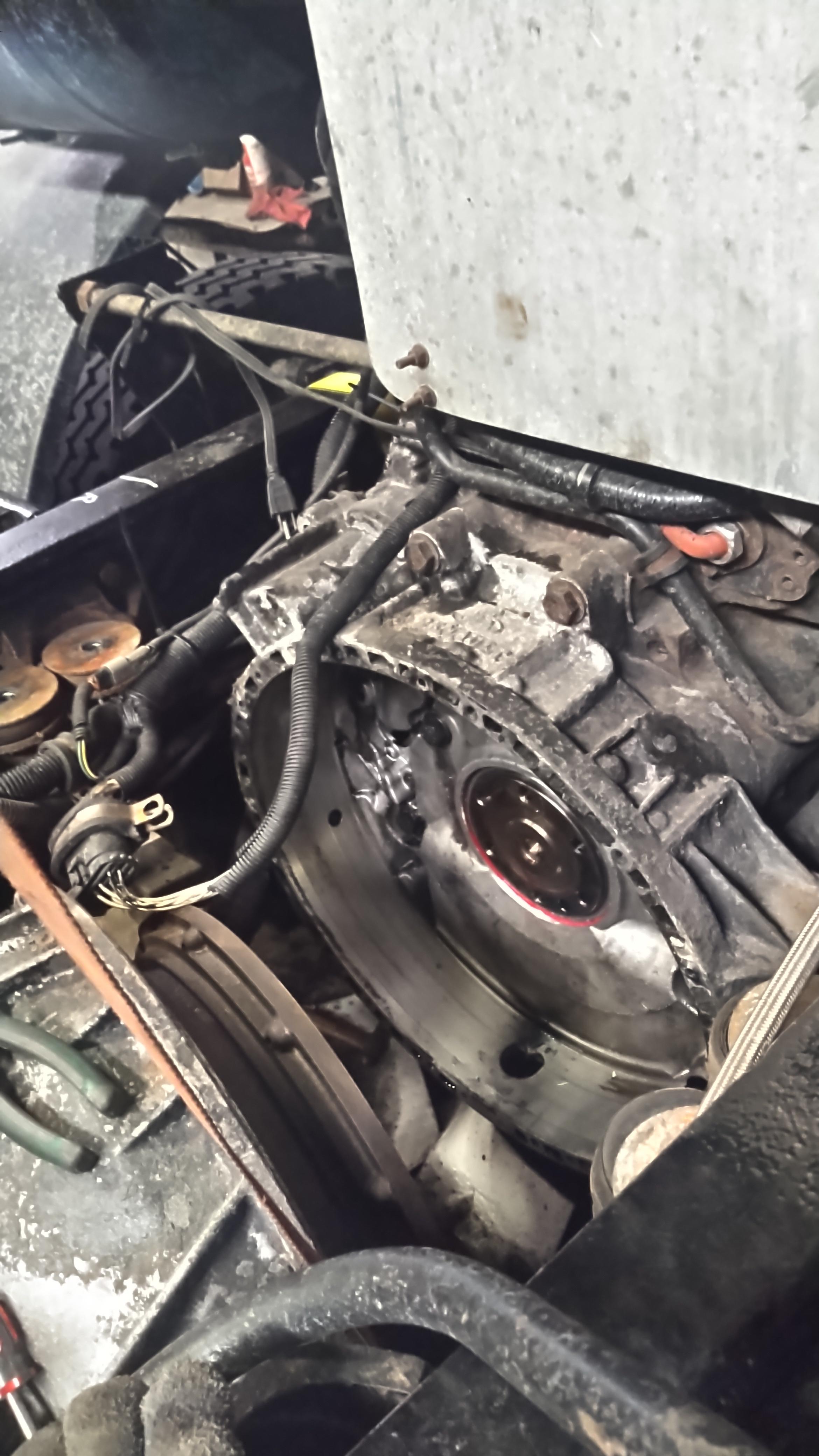

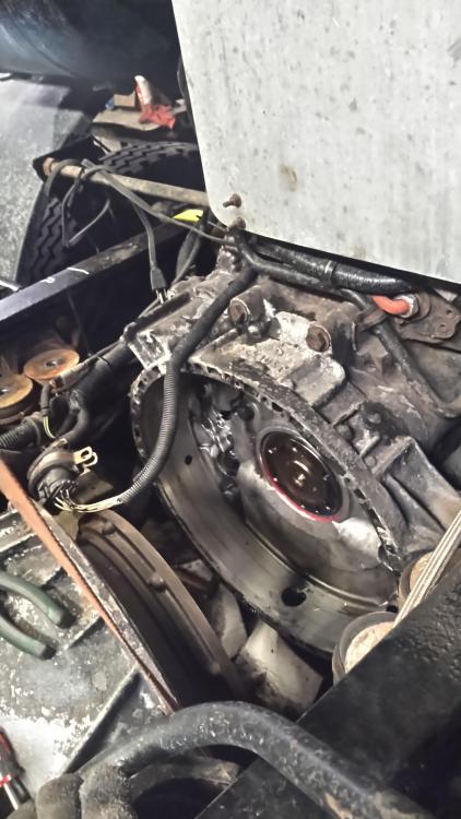

Was supposed to leave yesterday, but Illinois apparently doesn't sell trip permits, so we have to reroute an additional 500 miles to go around it, and we found a rear main seal leak so we have to pull the trans off today to replace seal.
This truck is a breeze to work on. First time we have had a transmission out and back in in one day. Old seal spun in the flywheel housing. We could move it by hand. New seal has Bearing Mount Loctite, and is recessed 1/4 inch per spec in our handy shop manual.

DOT # is at the bottom of the door; changed our # to "interstate" this morning. Since the truck has a PA only plate we have to buy permits for every state we want to drive through. Some states won't let you buy the permits if your DOT # isn't marked interstate. Some states don't care. Ohio cares, Illinois cares and since we have heard horrible things about Illinois roads the truck is going from Ohio to Kentucky to Missouri to Iowa.
