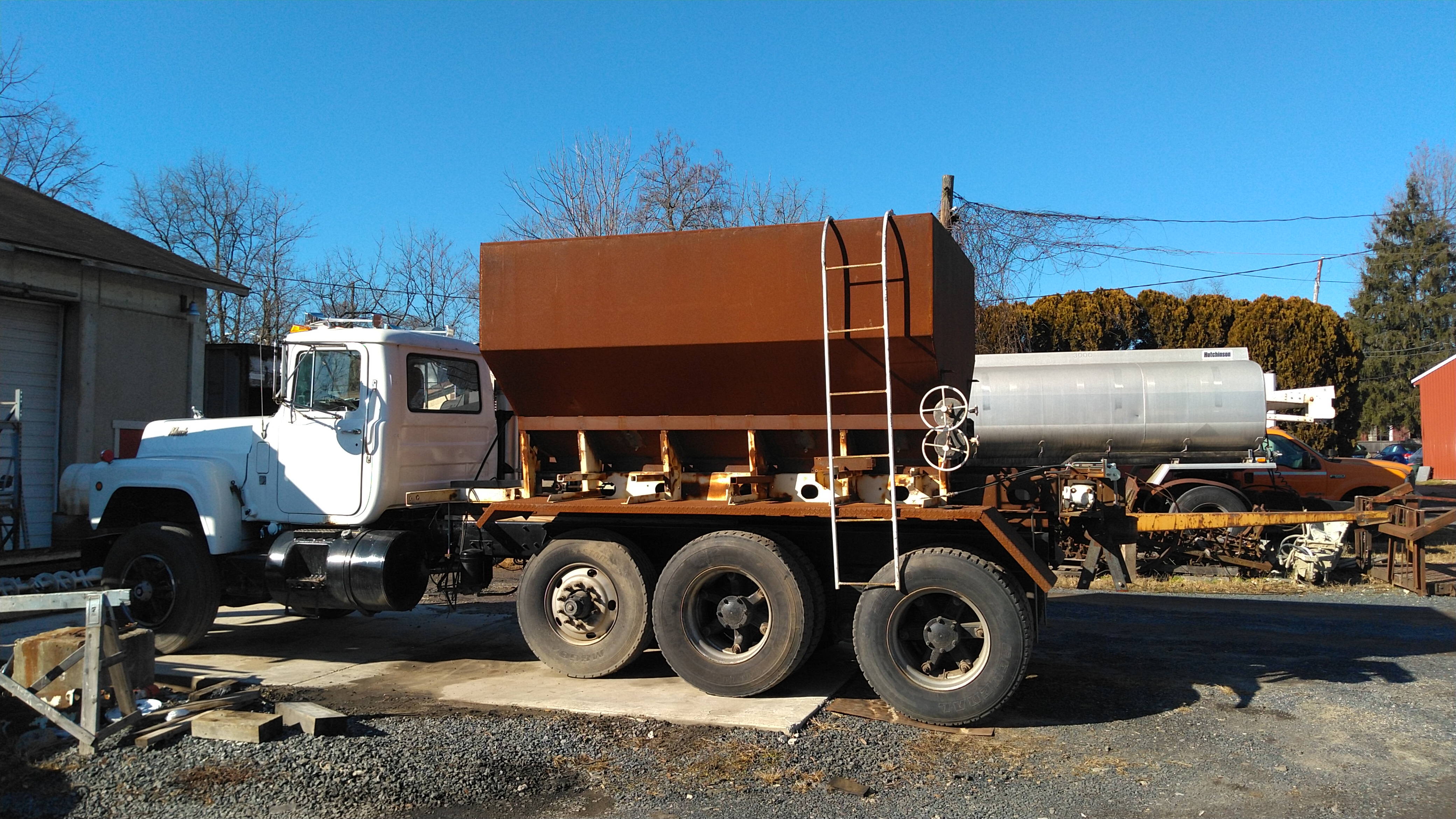

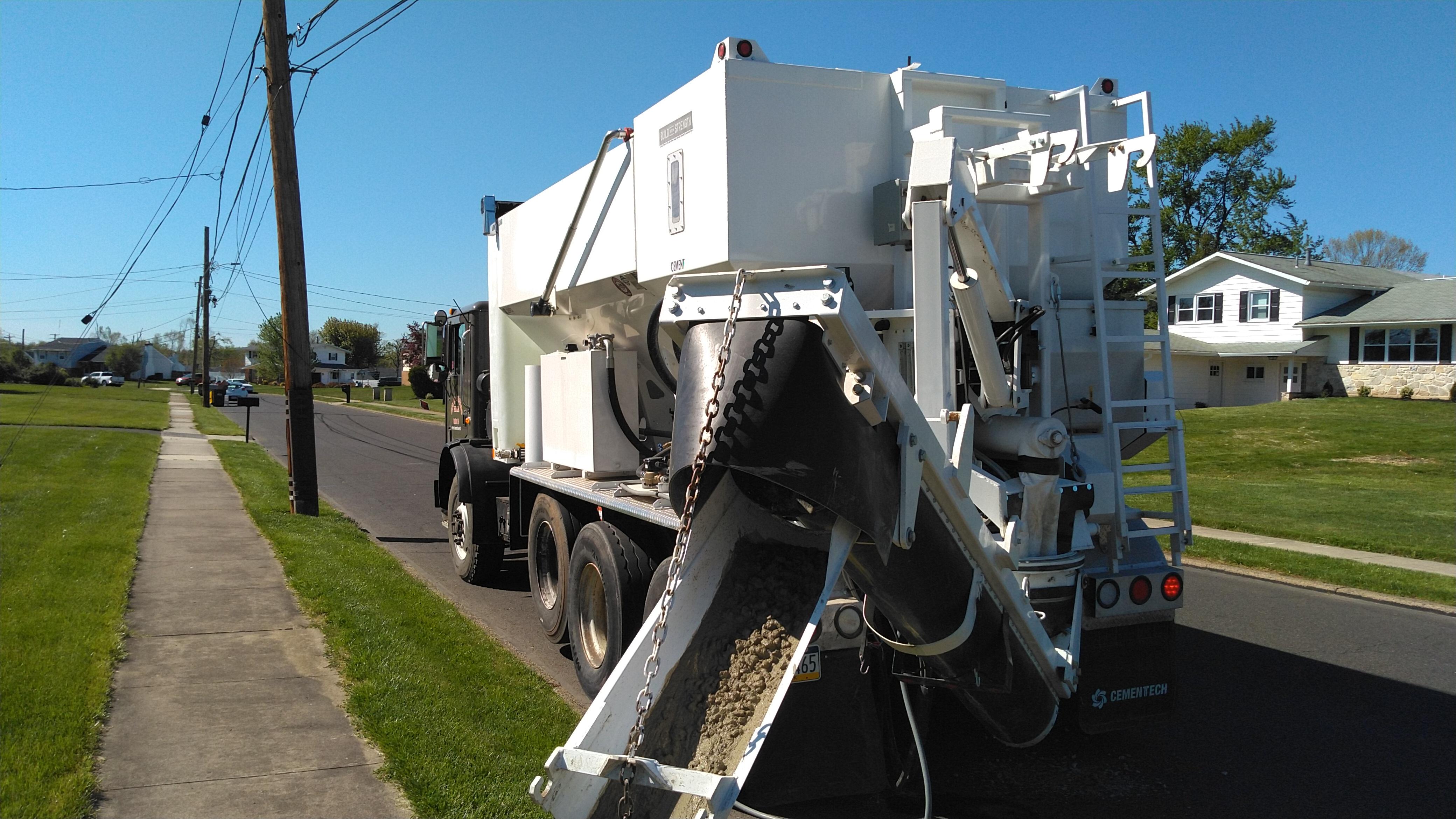

Truck is working well; concrete season is over, now we have to keep our heads low to pay off the mixer over the next 4 years.
This is our current project we've been working on. Hopefully we can get this mixer rebuild completed sometime in the first half of 2023. Less Mack related stuff on this build, so it probably won't find it's way onto the forum. The horse is a 1988 RD690S with an EM6-300L.
