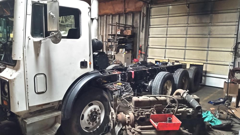

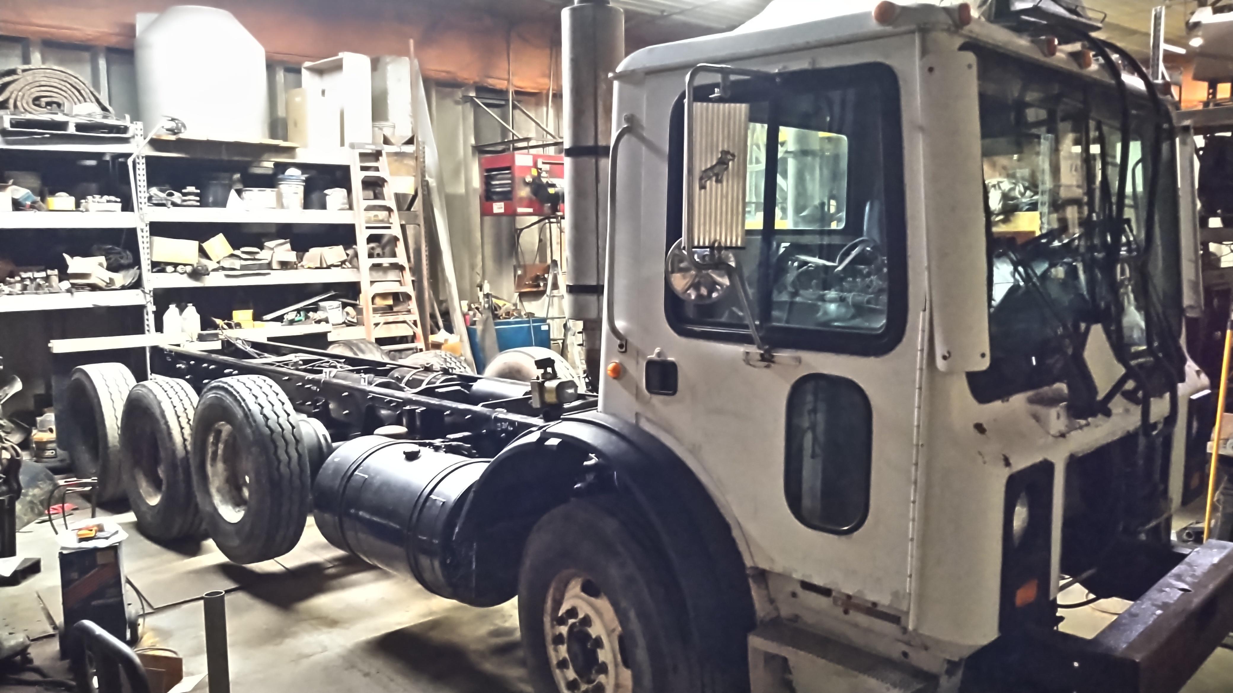

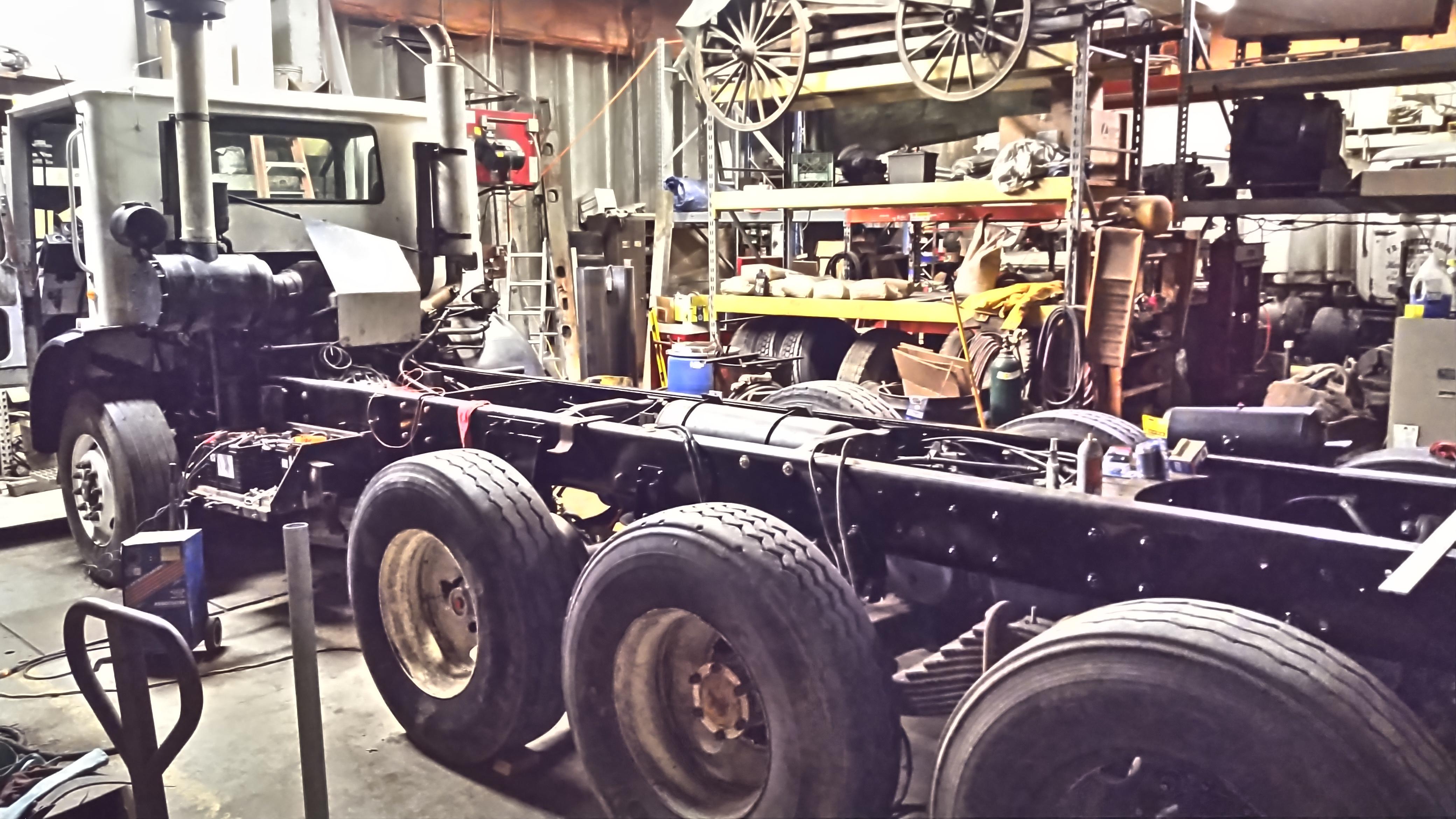

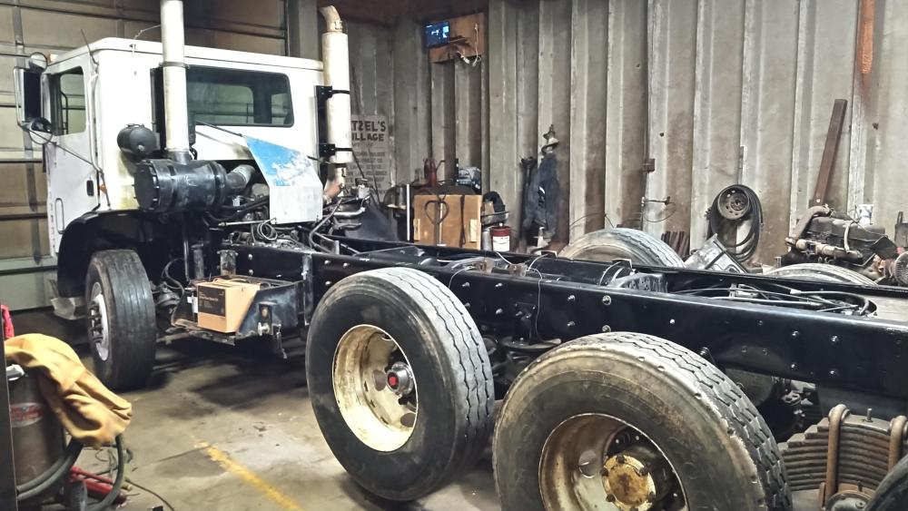

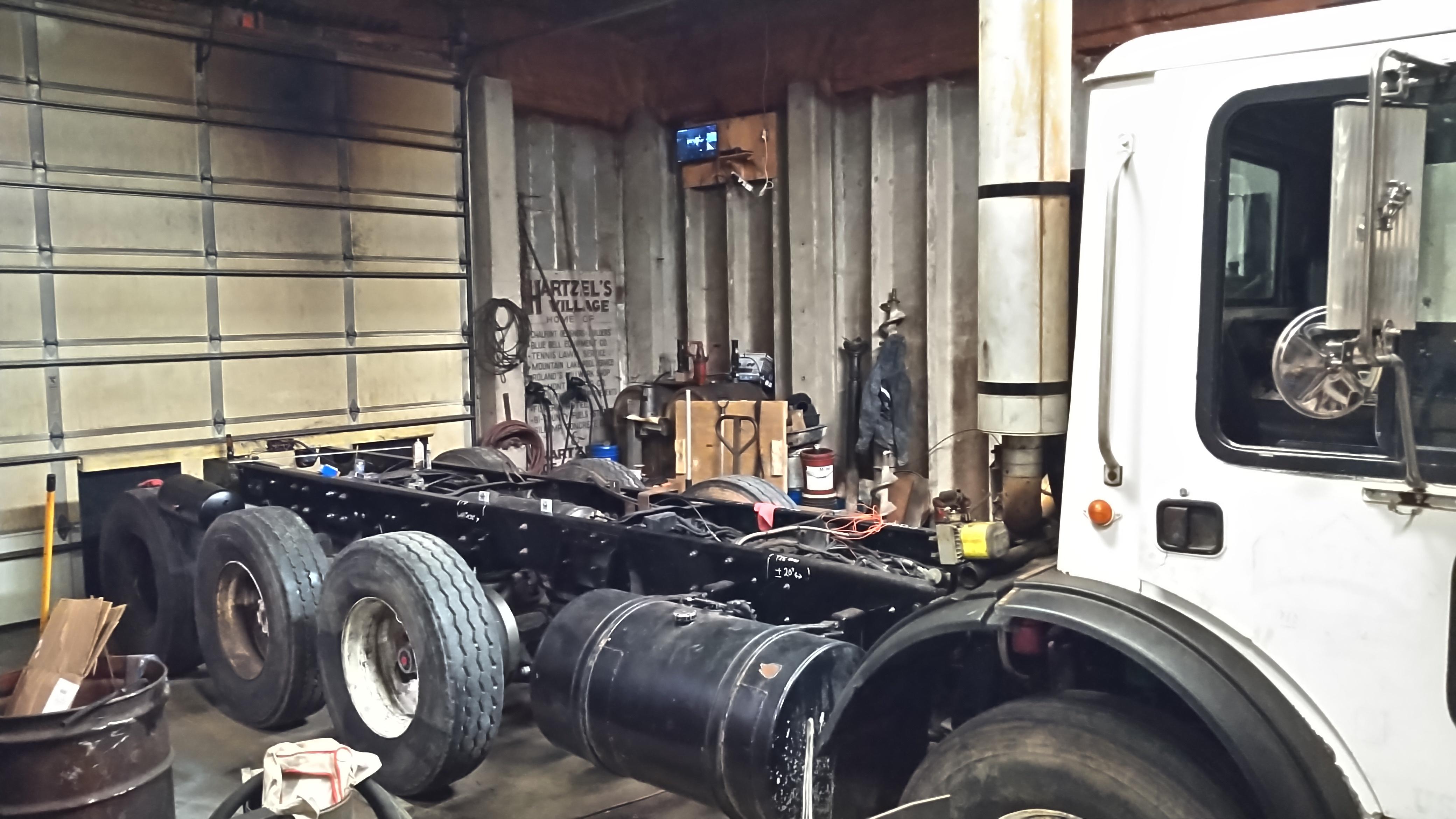

Lift axle bolted on.  Have the trans power sorted out, but now we have a blink code 6-4, cranks but won't start.  Mobile diagnostic guy comes out on Wednesday to try and figure it out. Yea, we're planning on driving this sucker out to Iowa (from Philadelphia area) by the end of this month... Call us crazy.  I'm not looking forward to a probable breakdown on the 20 hour drive...
I’m sure that you won’t encounter anything that you can’t handle @JoeH.  Probably some BMT members along the way that would help you out if needed.  I’d probably be more concerned about the weather and a light rear end with a bare chassis.
Good luck with the mobile tech. Hopefully they will be able to find/resolve your issue quickly. Looking forward to to more photos once you get her backed out of the shop.
Matt's Heavy Duty Mobile Diagnostics in Sellersville, PA came out this afternoon.  Tech (Cole) did a good job sifting through.  Scanner immediately showed no power to the EECU.  He managed to find the EECU power relay in the dash with no fuse/relay diagram, and found spread connectors for the related fuse. Truck is up and running! I think all we have left is to mount and plumb up air tanks and move the battery box as it interferes with the mixer peripherals.

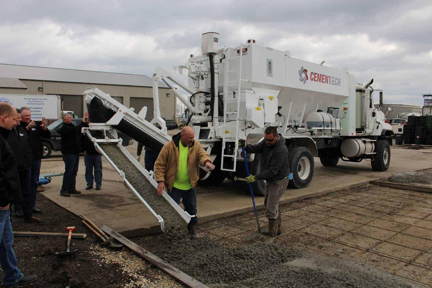

We're a small concrete delivery company, so this truck will be operated in a 15 mile radius. Tons of residential deliveries, backing into driveways, around houses, etc.  The maneuverability is going to be insane on this truck.  Short footprint has me a little worried about stability on a full load, but we'll just have to watch what we're doing a little more closely.
It's going to be a volumetric mixer, not a barrel.  Mixer holds sand/stone/cement/water/admixtures in different compartments then siphons them off as needed to make concrete. It all drops onto that auger on the back where it's mixed into concrete.  Perks are maximum working time (concrete isn't mixing in transit) and (if your driver knows what he's doing) control over every aspect of your concrete. Slump, sand/stone ratios (sometimes we show up and the customer needs us to cut back on the stone and bump the sand up to do an overlay on existing concrete).  We got our first one of these trucks in 1967.
This brand (CemenTech) is in Iowa, and the bulk of their sales must be in parts of the country where you have a mile to make your turn because they need 168" back of cab to center of tandem.  In the suburbs of Philly that's borderline impossible to get into people's driveways, let alone into their back yards! Hence the MR setup for this mixer.
