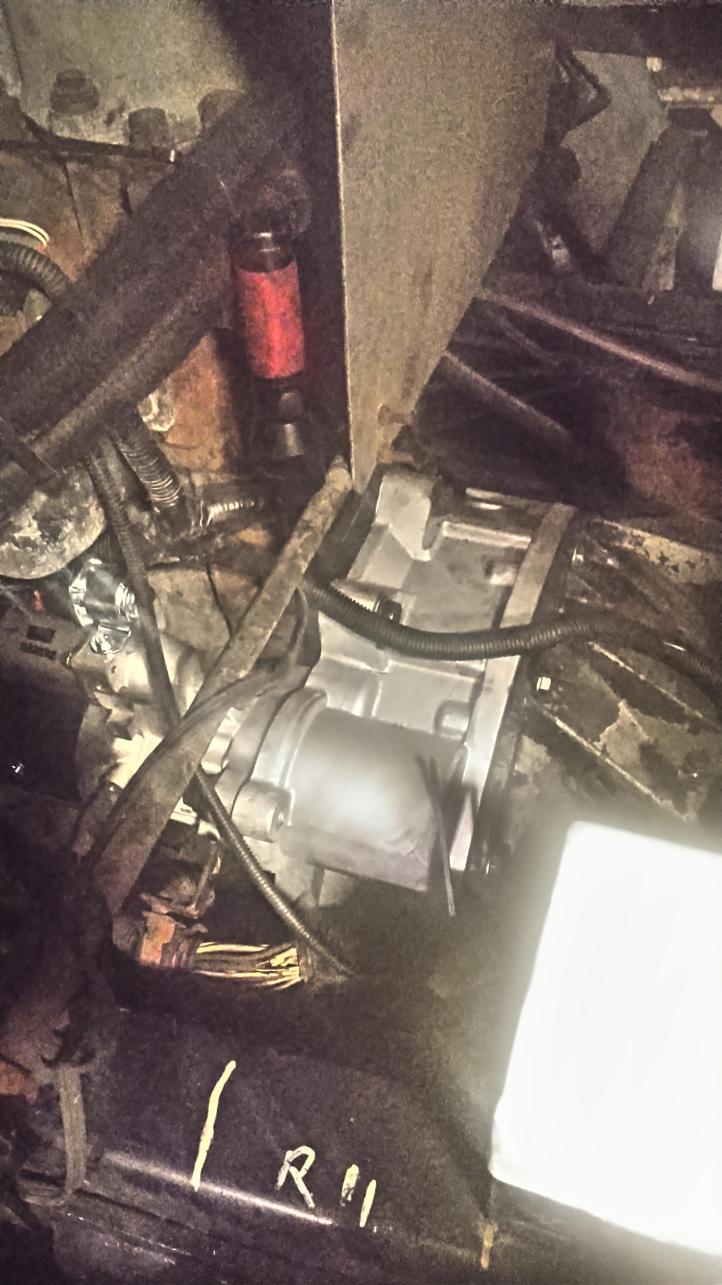

Broken lower right flywheel housing to block bolt.
How do we adjust flywheel housing runout?
0.022, 0.000
0.028, 0.013
Those are the runout readings on the four corners.
are these readings posted, as they were read on the engine?  is .022 at 12 O'Clock?  , then 3 O'Clock,  is '0' then 6 O'Clock is .013, and 9 O'Clock is .028?
yes to locating dowels,,  So the reading s you have may be good..  keep in mind that the crank shaft may move eliptically because of main bearing clearence, and wear..  You are allowed .020" of runout when checking with a dial indicator on the end of the crank shaft.  I can not post pics anymore, so if you P.M. your cell #, I can send pics from my Book..  there is also a specific flywheel housing for Allison's and the inner mounting bolt are specific,  similar looking bolts can bottom out and not tighten to around 170 lbft properly.. I hope I can help you,  jojo
I would have much rather had the Mack brand flywheel housing, but Mack has yet to get back to me on an ETA.
First Motion part number from online matched the Mack number, but noted that it wants 7/16 bolts for the flywheel to bellhousing, not the metric ones that Mack had. New flywheel housing is within 1/16th overall depth of the old one. Overall I hope I'm not screwed.
Trans is bolted up, torque converter is bolted to flywheel.  Time to torque up some things and keep working.... Late night...
So It seems like the housing is listing to the right.. When were the main bearings replaced?  I swear I am not trying to make a mountain out of this,  just asking..  engine runs clockwise, making the thrust side , the right side..  ?? the dowel that is a blade type is older but not sure if it correct, I see full round pins in E-Tech's,  the bladed pins are to be installed vertically..  the bolts on your engine are METRIC..  i dont get the 7/16 x 14 size.. I'll be right back... I will get the bolt size in a bit... jojo
ok... My Mack book shows the part # for the inner bolts w/Allison tranny as: 429GC23M...  That bolt is 2 inches long..  I cant imagine it is an SAE bolt..  jojo
Check out Dowel pin # 183GC237.it's the later pin after 1992..  I believe it is a full round pin.. The bladed pin you have is ok, but you may feel better with the pin I posted.   I'm into this,  post, so keep asking questions, and If I get off track, let me know..    jojo
Edited by Joey Mack
Poor spelling
My dad cut out around 7, I put in another 4 hours trying to get dumb stuff done that doesn't need 2 people.
Remaining:
Trans mount bolts
Battery cables to new starter, tie up wiring
PTO shaft & drive shaft
Rear oil pan bolts/readjust gasket
Reinstall the water tank for the mixer body
