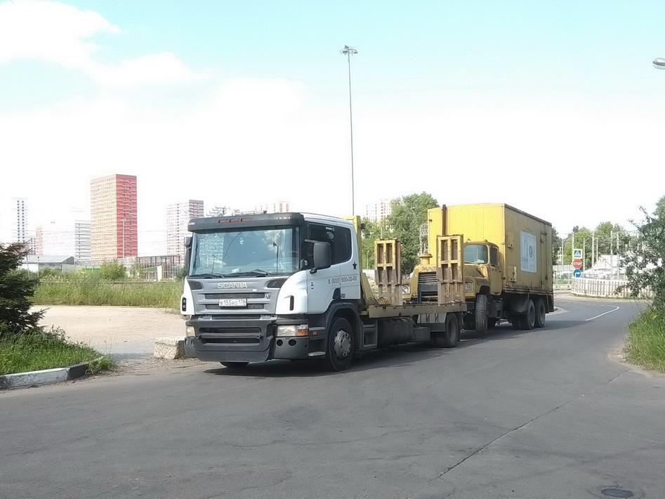

We always enjoy pictures of your countryside!! Whether on a truck retrieval run or just a Bike / car ride.. I have forwarded you earlier topics pictures to my son-in-law who is 2nd generation Ukrainian.
That wrecker looks like a cross between what we call a roll back and a ramped low boy trailer, with an under axle lift mounted on the back??  Got some more pictures of it???

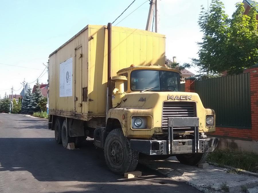

Thank you Keith. Yes, honestly I hate the look of the front wheels of DM when narrow 20 inch wheels are fitted on spoke hubs. So strongly going to put something wider and with positive offset. I'm thinking of 385/65R22.5 so far but found out Dayton rims wider than 8.25" is hens teeth in my part of the world. The only option I found so far is a set of 14" wide rims somewhere in Siberia and they asked nearly $1K for 6 rusty barrels. 14inch seems to wide for my blood and another possibility seen is cutting centers off 11.75 trailer wheels which are pretty common here and weld in a fitting ring off 8.25 Daytons. Big lathe is needed to do this job and and all those spoken wheels to buy. So looks like an entertainment you should get prepaired for and much better to avoid it at all purchasing ready rims instead.

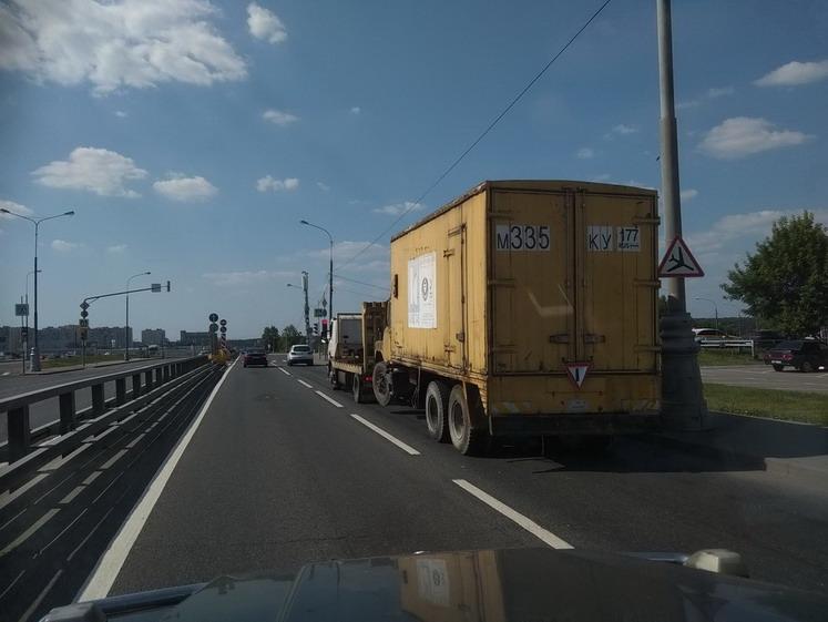

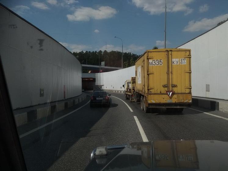

Mike, I hope I will make a few more long journeys in my life. Sometimes you just should force yourself to do crazy things to fill up the life with bright colors. Although the trip was short I made a few pics down the road anyway. Mack didn't have any lights at the rear (someone found another use for them) and to my surprize the wrecker guy didn't have a light panel to temporary install on a towed vehicle. So I preferred to follow him all the way being that light panel.

The wrecker was a single axle roll off truck which also had hydraulic arm to put under a front axle for towing. It's called "brill" here for some reason. So the truck could transport light vehicles on its bad and tow heavier ones at the same time. The driver said that Scania was originally a car transporter tractor-trailer and was refurbished into the current shape by a shop. Honestly I got surprized when the driver said he was eager to tow the Mack since it was definitely heavy for that wrecker. But he gave my attractive cost and it was his business not mine.  Also a good point was the wrecker wasn't long. There's a sharp corner when you're entering my street and he had better chances to slick into the curve than a bigger size unit. I had a MH-model purchased a few years back and it was delivered by a wrecker. It didn't go into my street and I had to pull the MH with a rope by my 4x4.
That's cool. I'm glad to hear of anybody enjoying my posts. Mentioning Ukraine I personally don't like the way of things my country currently gets into relating that country but I would like to keep away from political discussions. Sorry no good photos of the wrecker excepting the posted ones. I described the most I could about the truck in the post above.

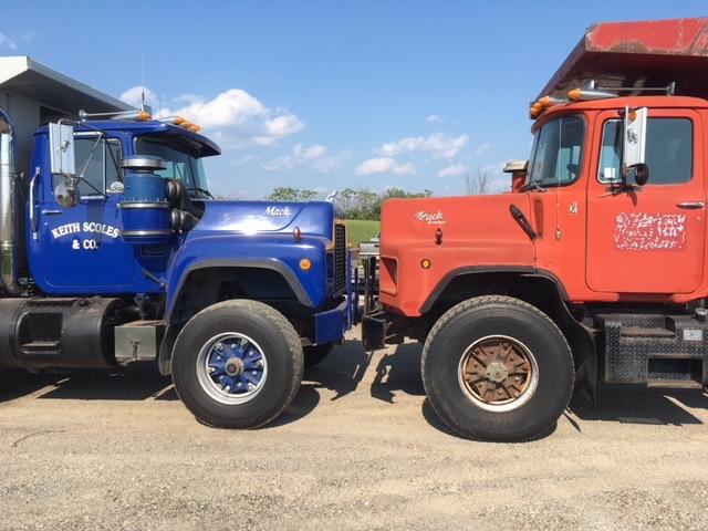

Heres a pic of some 385's on my RD compared to 445 's on the DM .
You mentioned your specs. It made me curious as to what rears were in my DM .After checking , It has 5.55 rears. I didn't know but after checking BMT , it turns out its kinda common with a T2070 and 300 maxidyne . I learn something new every day on this site .
Keith

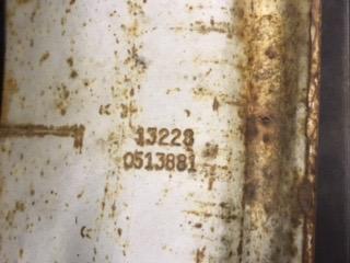

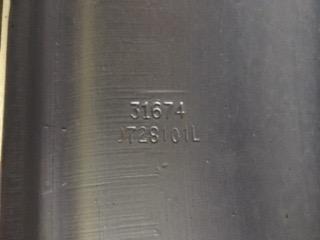

I got the size wrong Vlad. After checking , I was able to get you some good info that may help you .
The RD with 385's has a part # on it of 31674.   Thats a 22.5 X 12.25 rim with 3 inch offset .
The DM with 445's has a part # on of 13228.  Thats a 22.5 X 13 with 3.94 offset.
That number is no good any more . But by dimension I was able to get a new number.
The new # is 32201TK .
The rim part numbers are Accuride  numbers . And the way I understand it . The offset is from the centre of the rim , not the outside edge.
But I could be wrong , lol . Ive been wrong before .
Hope it helps.
Keith
