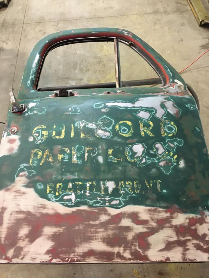

Also...cab is ready for primer!
That door picture is quite a find. I hope that guy does have a picture or two of that truck from when it was in service.  The repair on the bottom where the red putty is exposed would almost suggest that was done late '70s or early '80s (???)   probably lead based paint on the lettering. You could strip that door to bare metal and you'll still see that burned into it.  May want to have a good mask on when sanding 😷

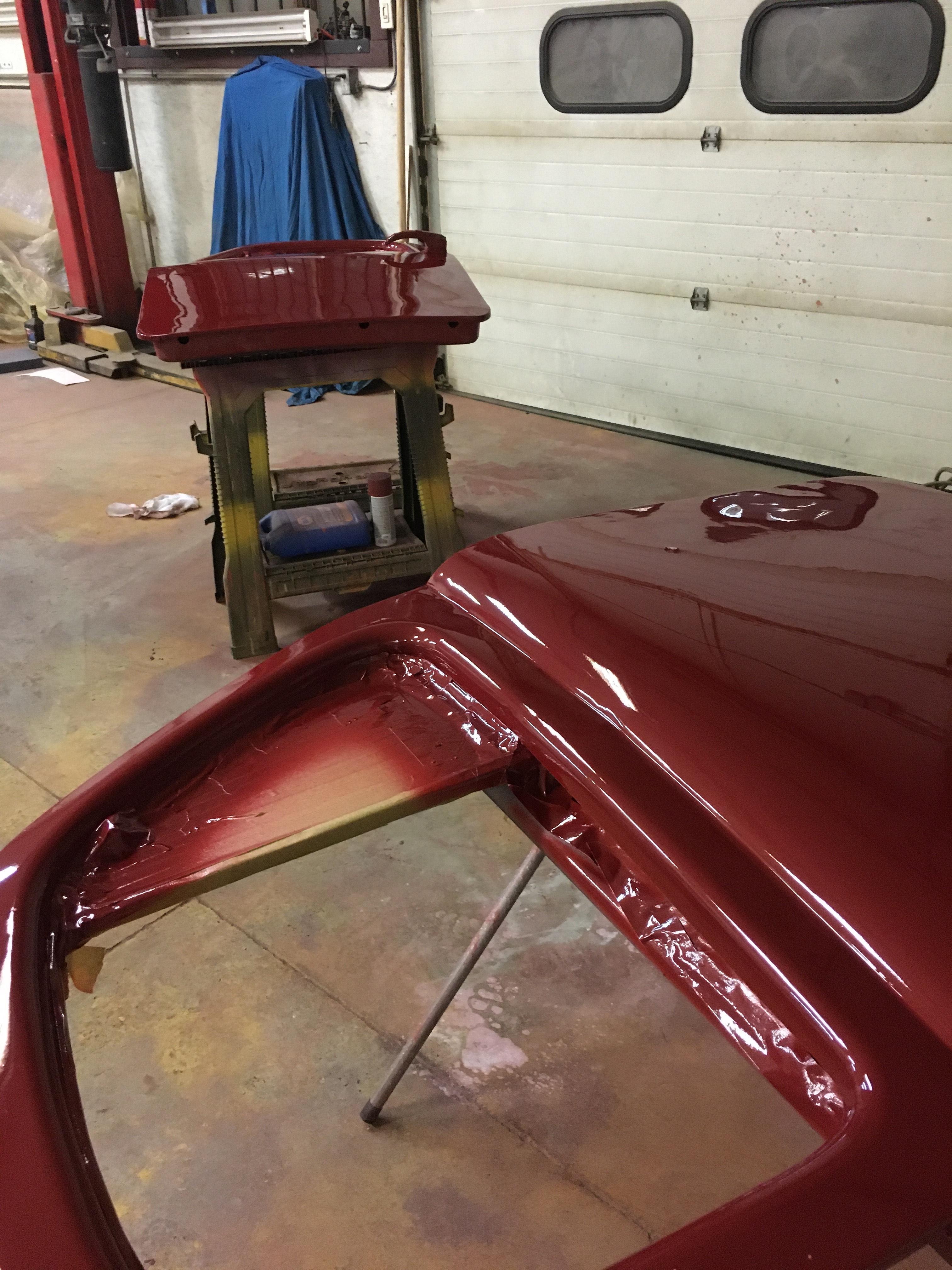

The paint under and over the lettering definitely aged differently - really cracked.  I did get it all off!  Got both doors repaired (glass and Bondo) and did an initial rattle can primer this weekend.  I detailed the lingering scratches with Nitro-Stan and wet sanded with 320.  Doors are surprisingly silky smooth - far beyond my expectations!  Oh, yeah!!  Tomorrow we'll spray the high-build primer and I'll be back to wet sanding on Tuesday.  Wednesday we're spraying top coat.  Things are feeling pretty real!
Today I also cut aluminum plates to cover the interior holes above the doors that housed the light fixtures (which were no good).  I was able to retrofit some LED license plate lights utilizing the original screw holes and they look pretty darn good.
Things are looking good for my mid-late April timeline.

That lettering will come off and all, and feather in. If you stripped the doors to bare metal ???  certain angles you'd still see it right in the metal.  Most likely old lead based from that era. You won't see it after prepping it as you have.  I'm wondering how the progress on this truck allows time for so many pictures ?? Think I can speak for lots of us here.....keep'm coming

We're spraying primer on the doors now!  I can't not document...drives my husband nuts, but then he's always grateful I have so many pictures of our projects coming to life!

Stay tuned for pictures of the doors with top coat tonight!  I CAN'T WAIT!!!
