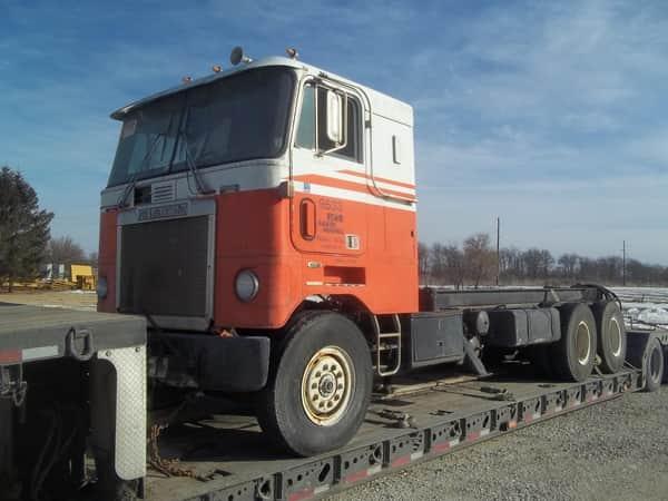

The floor is quite good and doesn't show any corrosion by the first observation. i sure will clean the dust off it and look more detailingly but it's shape seems promising. Some outer panels have bents and I would swap them by aluminium sheet since the most of the panels are straight cuttings. There's also a mess of rivets so better to install new ones instead of aftermarket spots. Of difficulties there's a lower part of the windscreen opening which has multiple cracks but I found out it's fiberglass so could be repaired. And the windscreens themself is one of the 1st points in the fixing list. I'm afraid I will need to bring the truck or the cab to a glass shop for fabricating well fitted windscreens. And this means I should fix the opening first. Unfortunately all that is not a deal of the day since plenty of current affair already take place.

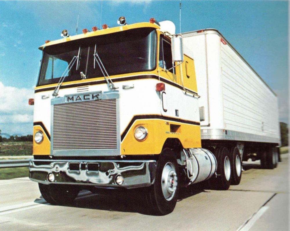

2 hours ago, kscarbel2 said:
From the 1982 second generation (Macungie production) Cruise-Liner brochure, this is my favorite photograph.
Great looking truck and I like the paint scheme.

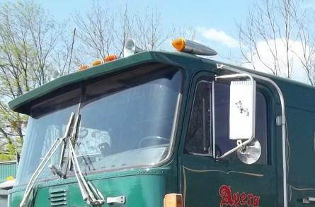

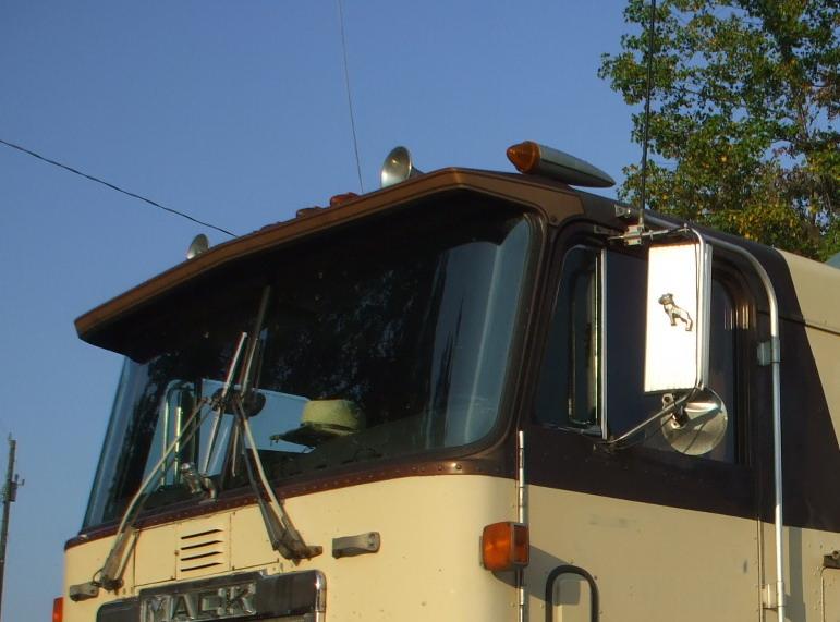

Any ideas on what the torpedo marker lights on Cruiseliner are? Some special style with the tail part hanging in the air. Never saw anything like that on other Macks nor another branded trucks.
As I recall, 38MO363RP3 for R/U/DM was supplied buy Signal Stat, which was acquired by Truck-Lite. The bottom has a slight curve to match the cab contour.
(The short version in the middle of an R/U/DM, ahead of the roof vent, was 38MO362RP3)
https://www.ebay.com/itm/Semi-Truck-Bullet-Marker-Lamp-PAI-FLR-4302-Ref-Mack-8154-51631771-38MO363-/253996119453
I can't remember if the Cruise-Liner's "bullet" lamps had a flat bottom or not.
I already bought a set of KD-516 (or so) from Truck-Lite to install on the R and also another set without the short light for MH. But Cruiseliners had something different from the factory. If you look at the pics and also the brochure photo of green cab you posted above those lights have mounting area at the front only and the most of their body length is "flying in the air". I don't remember seeing such ones for sale or installed on other trucks.
My new purchase has marker lights which look as Kenworth W900 fender turn light and I noted similar setup on other Cruiseliners. But those "flying torpedo's" are definitely a special and attractive thing.
You're right Vlad....my mistake. Those were supplied by KD, who was acquired by ATC.
I understand and agree. I still think they were KD though.
https://www.slclighting.com/shop?Collection=Cab Markers
https://www.slclighting.com/product-page/c-m-bullet-chrome-amber-incondesant-long-body

2 hours ago, Mike Harbison said:
Looks like a sister to mine,sounds like the same specs too,1078 main,1241 Spicer auxiliary, heavy frame.
Yup, pretty sure.
Also square fuel tanks and the air tanks removed from under the battery boxes and installed on brackets to the chassis. Plenty of minor similarities too.

What's the last 4 numbers of the VIN? Mine is 1022.
