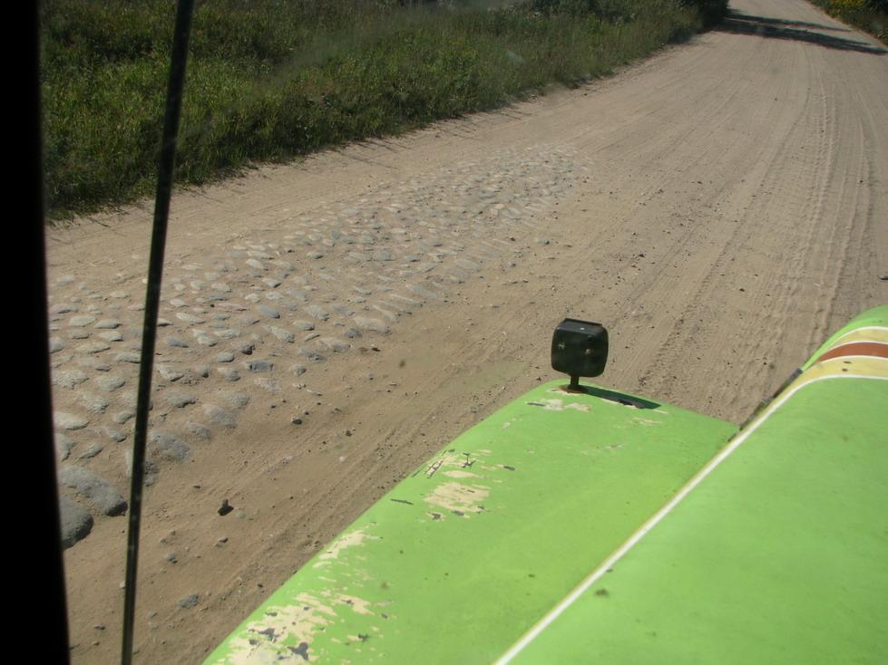

I posted this below pic a few years ago when asked a question on the same matter.
Dropped the pressure down to 2,5 bar in the rears (don't remember how many psi) and got much happier. But the wheels were 11R24.5 tubeless.
On 6/24/2020 at 4:21 PM, Vladislav said:
Ha-ha-ha:):):)
Rough looking road! 2.5 bar is 36 psi.
That trip I covered nearly 40 kilometers of that dirt road. It took me one and a half hour plus a 10 minutes relaxing stop. Rears were inflated to 4 bar/59psi and the truck was really shaky. Fronts were 6bar/88psi. Having that pressure I noted rear tyre's shoulder areas didn't touch pavement when you're on a highway keeping dust on. After home I deflated rears to the pointed above 2.5 bar/37 psi and felt much better with tyres making contact by full width. Was going to drop off more down to 2 bar/ 30 psi but just didn't do that. Cars drive with 2 bars in tyres but car's rim has humps for better sidewall lock and truck whells don't.
