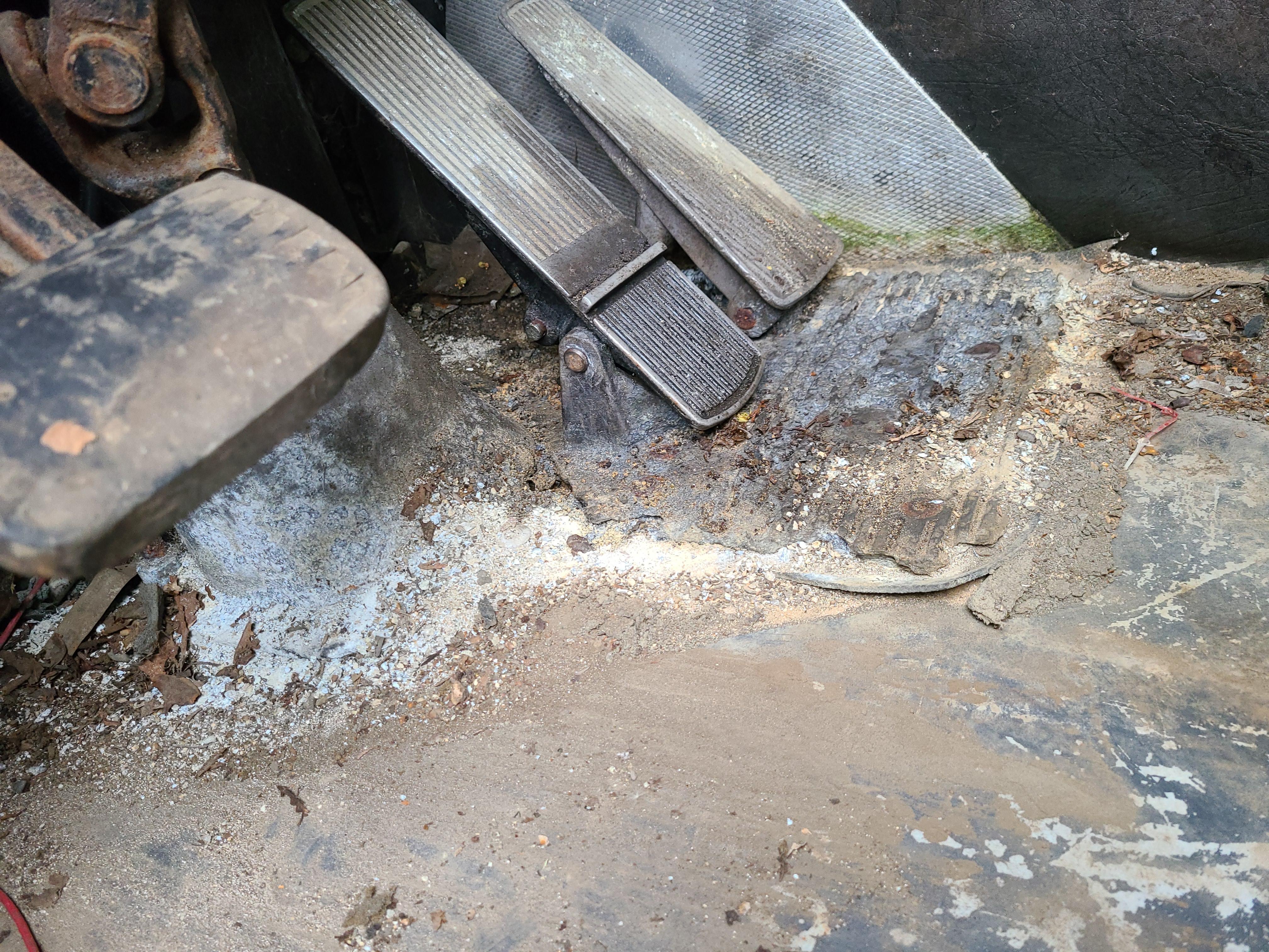

1. raising the cab, it says on the jack there is a manual release but I cna not find one anywhere, other trucks have them box on the passenger side. Either way this will not raise. The pump could be bad or there is a catch somewhere I am missing. I would appreciate any help.
2. the brake pedal is stuck solid and the alluminum base is pretty corroded. Are these still vailable?

The brake pedal gets seized in the aluminium base. There's a steel piston inside a cylinder bored in the pedal base which pushes the threaddle valve when you push the pedal. You need to remove the base from the threaddle valve and get the piston (actually a tappet) free. Hitting, heating, WD40 penetration are the ways to go. After it's loose sand off all oxidation from it and the cylinder surface and apply grease. The base and the tappet are NOT interchangable with R-model (RW, RD, DM etc) but unique to MH. And too probably not easy to find. The threadle valve is a standart brake valve, same as in R. The big pedal base with MACK script has tendency to corrode due to moisture in the floor mat. A difficult to find part either.

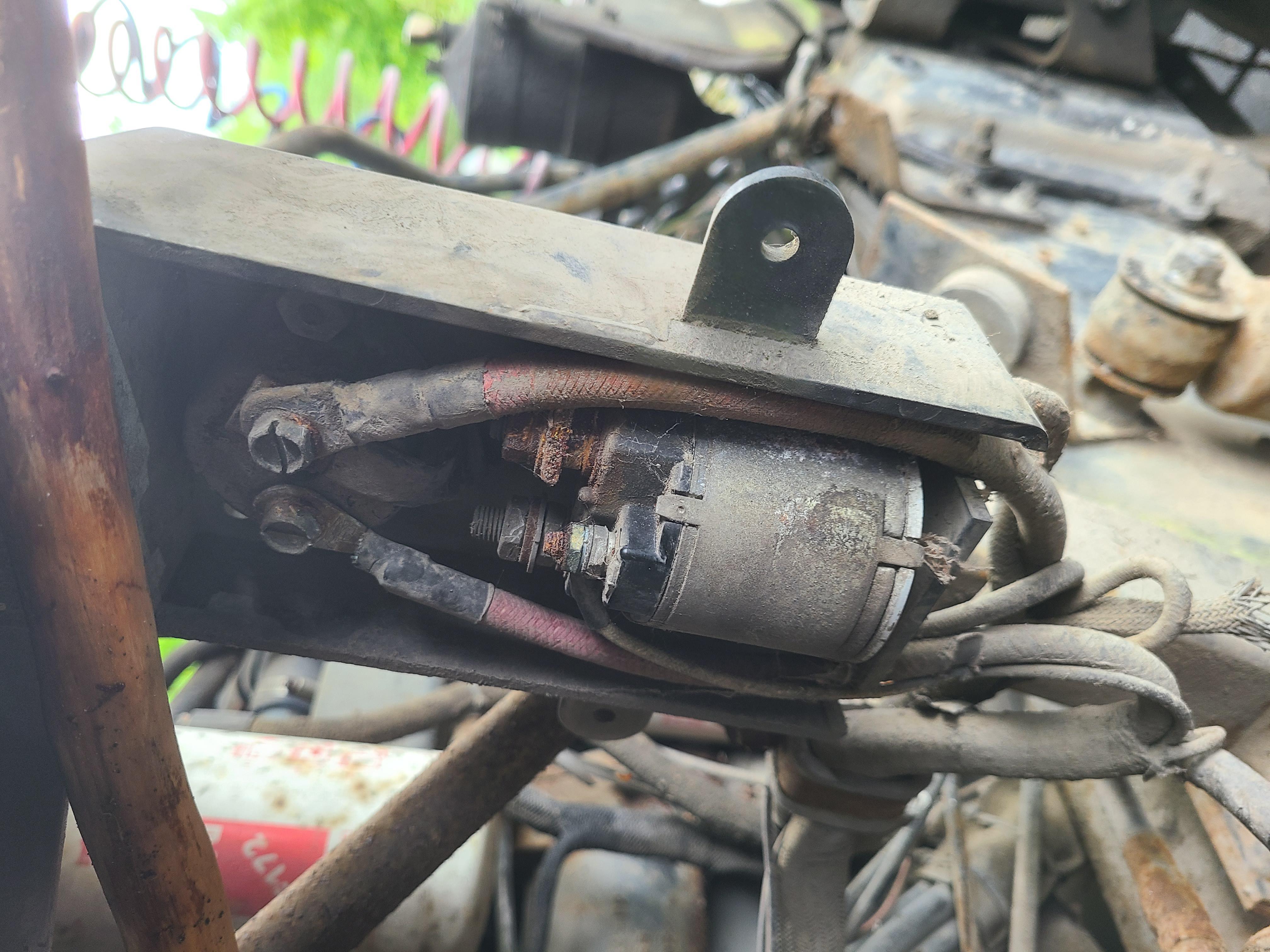

Well, that pedal plate is killing me, and the electrical is also giving me some problems today. There is a solenoid, pictured that I think might power the cab, no ideal but it looks it has 12.8v to one side and 0 to the other with 9.2v to the small post. I might put a wrench across it and see what happens but I have a feeling something got hot at one time so I wanna take it slow with that one.

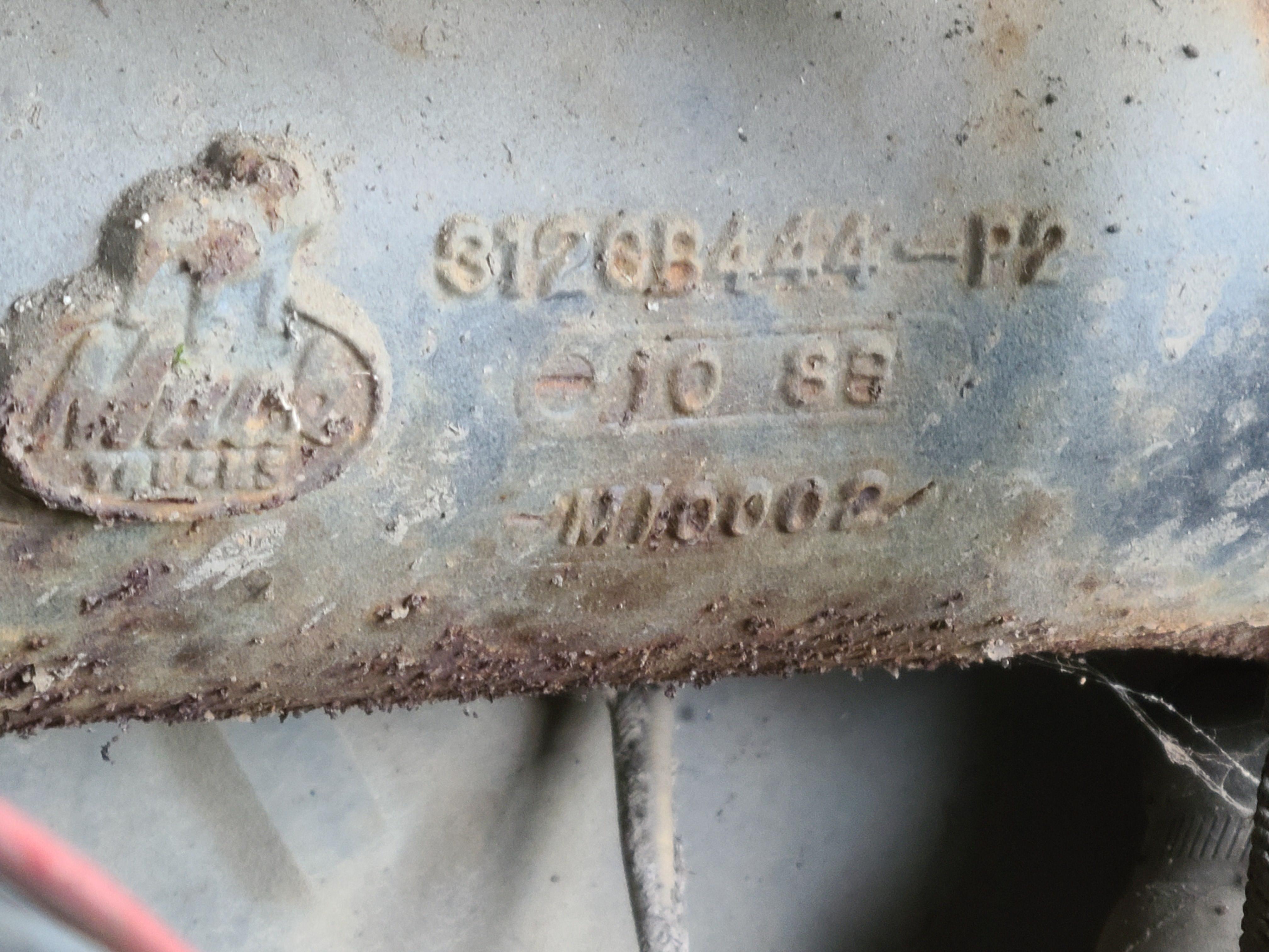

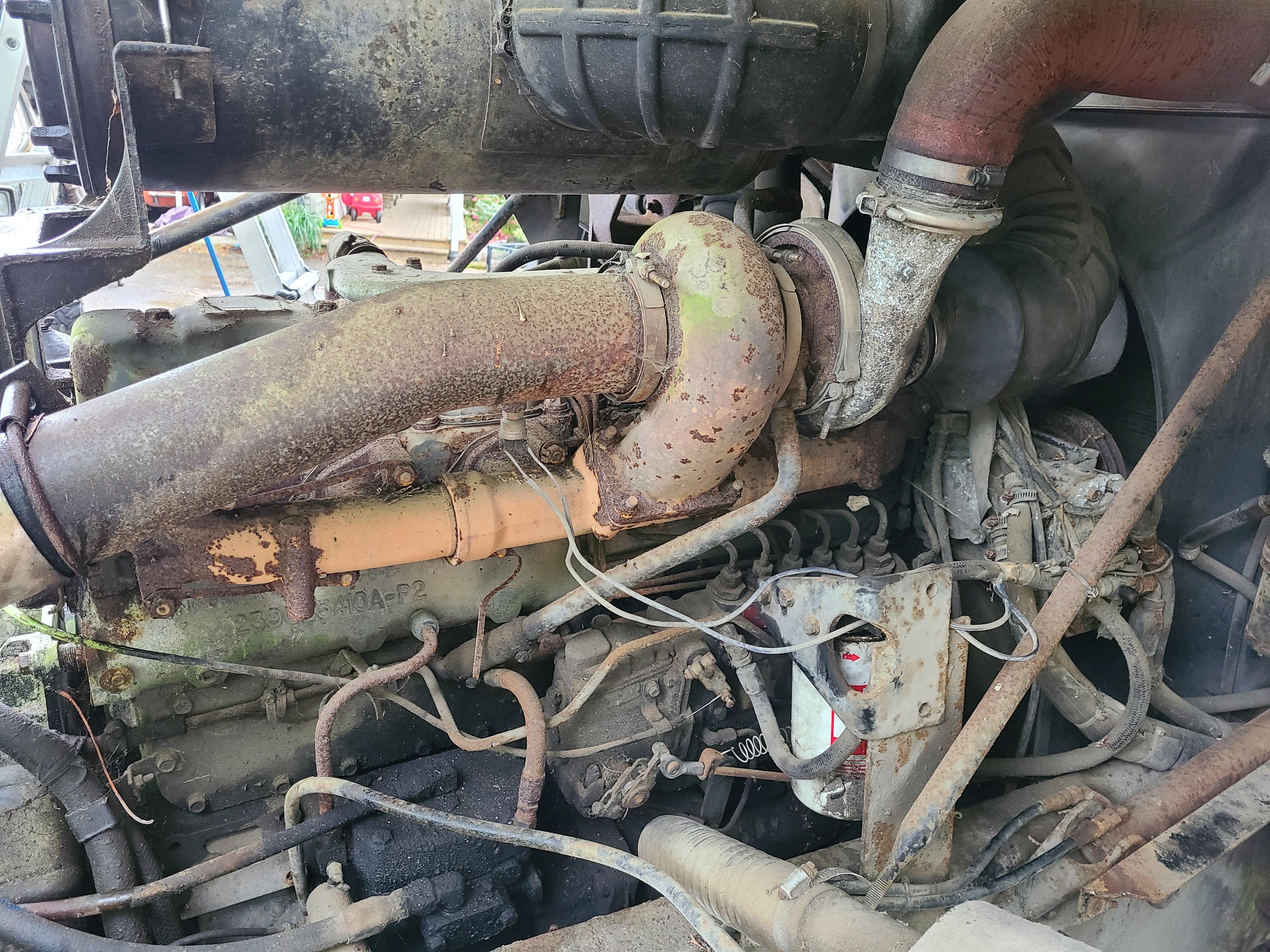

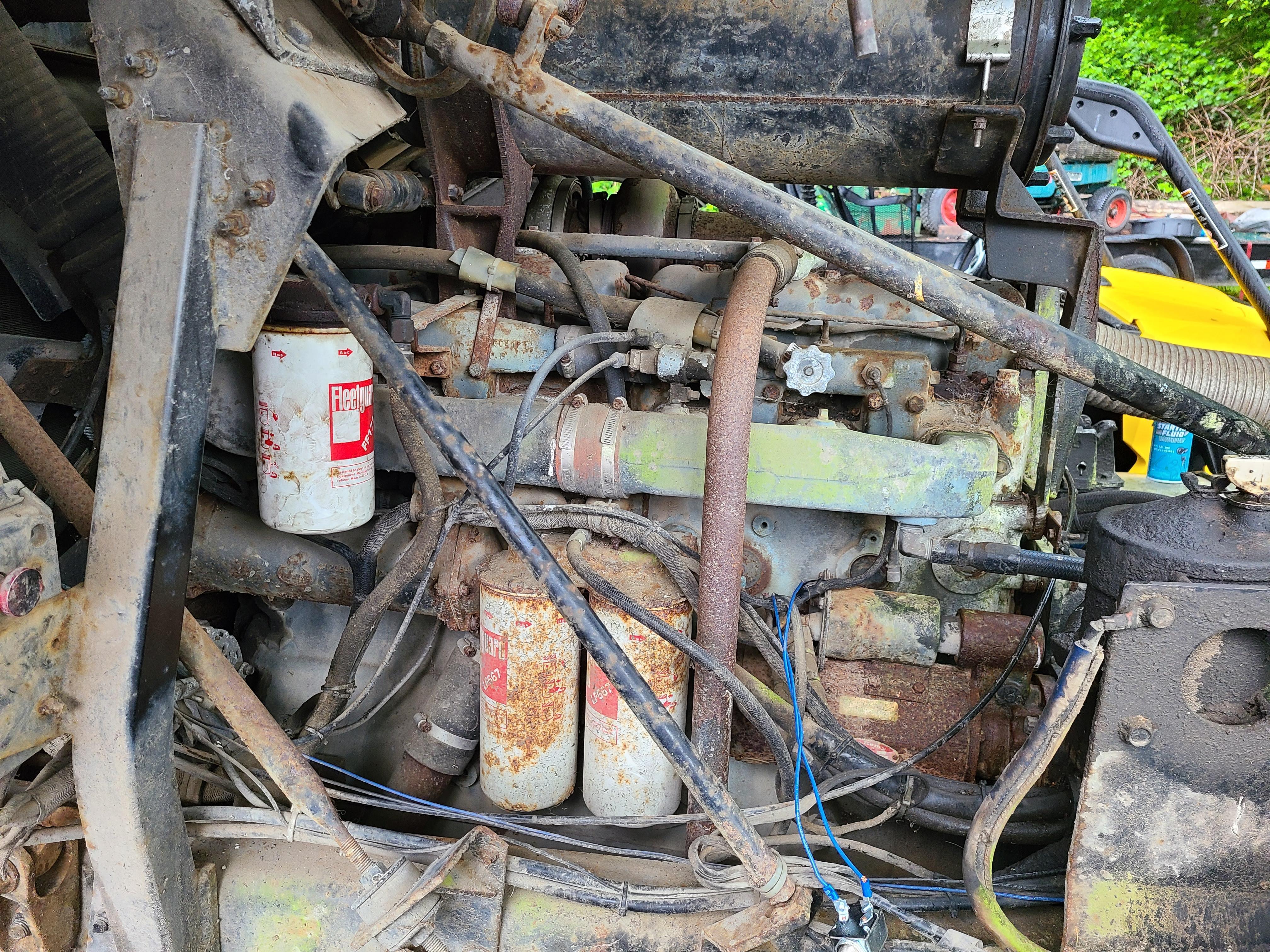

The pic of the number off the motor , I believe that is just the oil cooler part number . The "   10   88  "   in the middle line is a casting date. Which could mean your truck is newer than you though . Or, it was replaced at some point. I have the same numbers on my oil cooler. Its an E6 350 4 valve.
If you take a pic of the motor , I'm sure we can help.

Do NOT just wail on the end of that pin with a hammer. You will either break the mount or mushroom the head and it will never come out. Put some heat on it and some vise grips on the big and and try to spin it to break it loose.
Here are some photos of the motor and of that pedal, the base is pretty corroded so I want to source a replacement somehow. I will try to put some heat to it today.
