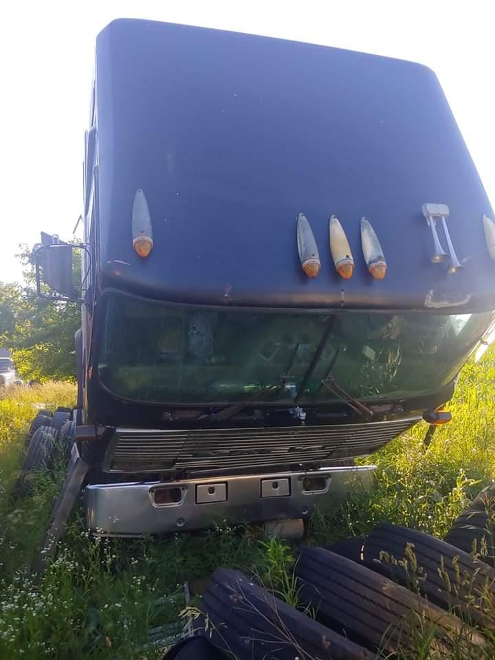

The MH is a Mack Ultraliner.  To my knowledge, it should fit fine.
I might be confused, I thought the MH was fiberglass composite cab and the ultraliner was aluminum cab?
If they are the same that widens the search :)

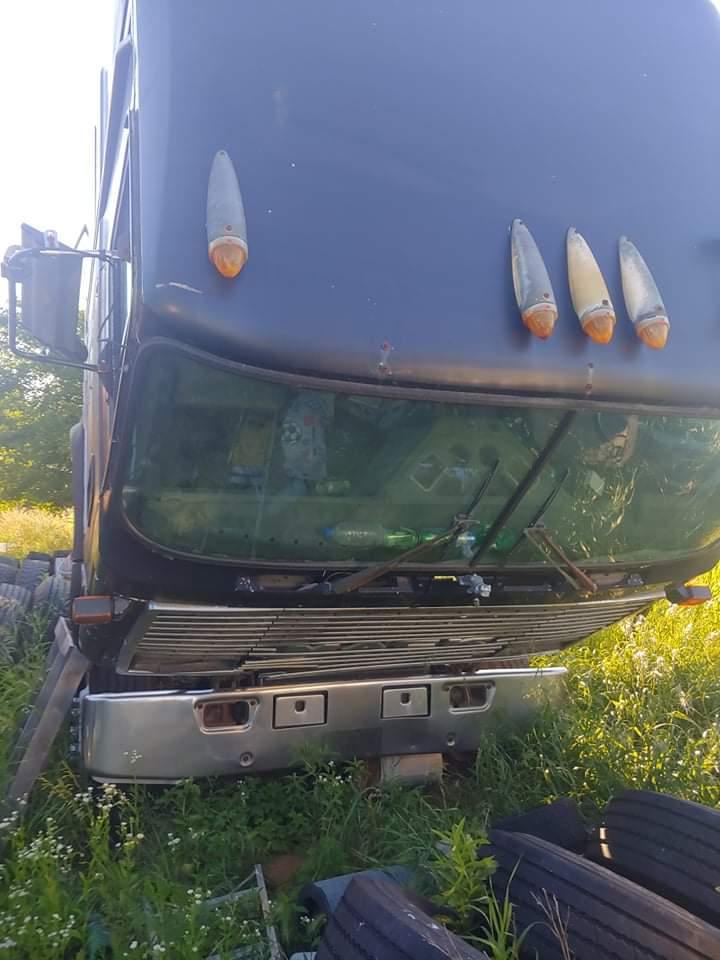

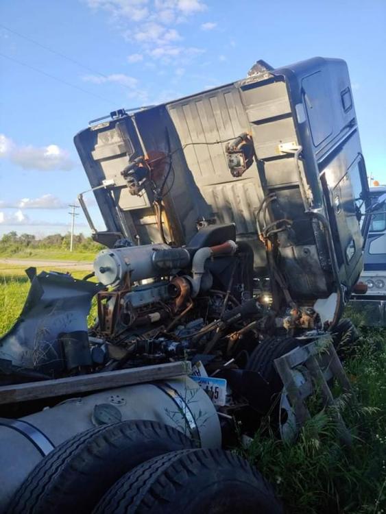

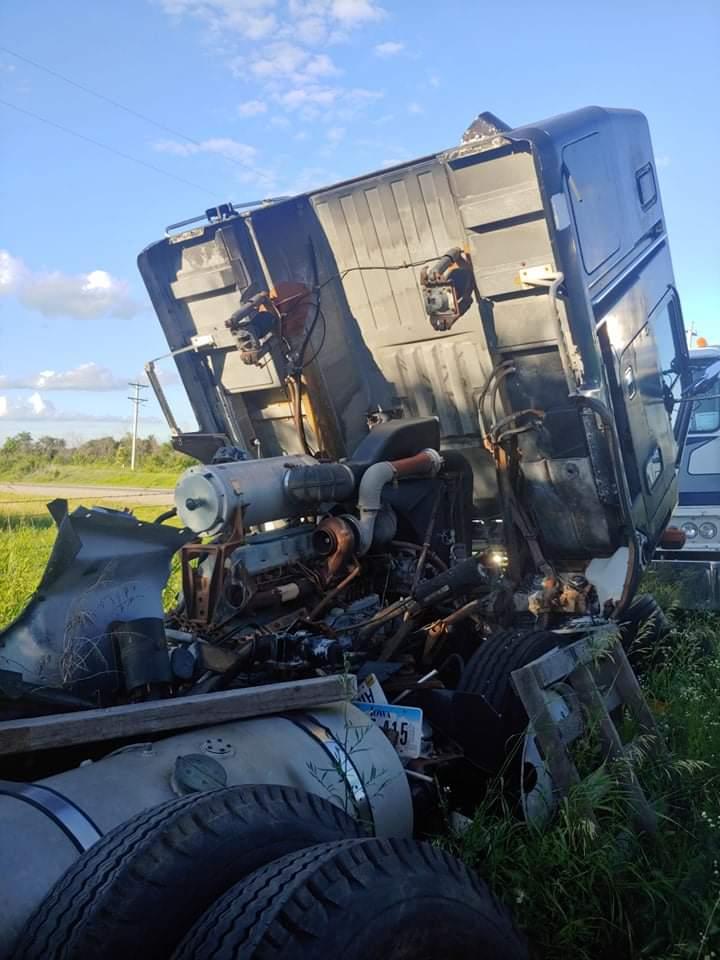

What a shame to read this, & look at what it is today

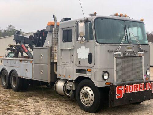

Are you talking temporarily or permanently?
My wife stopped that threat after I built this. It’s nice enough inside that she stays with me at shows now.
That is Noiiiice!!!
