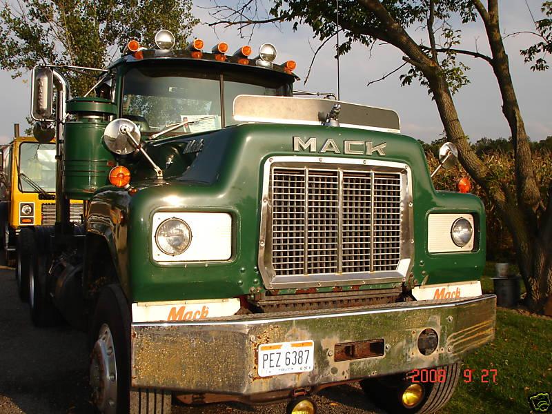

When did Mack introduce this style of grille?
I thought that Grill was used after shutters went out and before Mack realized that the Grill shouldn't tip with the hood.  I could be wrong.  Friend had an 81 with that Grill.   Personally I like it along with Alcoa wheels.   Like the white r with the big fuel tanks. That's cool

That's a standard grille for Eastern R700 with longer hood relating to R600. Sure it was used on F-models originally but fitted to R700 for some reason. If you look at the pic of red truck above you can see the hood has a rib, a kind of a pedestal over the grill opening where the grill attaches. Eastern R600 nor Western RS/RL600/700 never had anything like that.

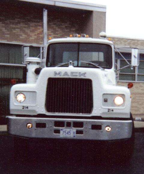

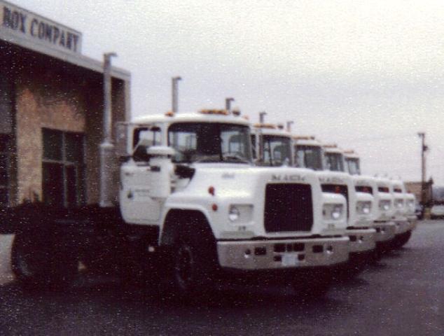

White R600 with red and black stripes has different grill which doesn't have big framing. In fact that one fits straight onto the intercooler and stays in place while the hood tilts. The spoken R700 grill goes down together with the hood when tilting.
that white trans provincial truck is not the fake lookin put in grille were talkin about. the white truck has an early 80's stainless grille that was attached to the air to air condenser. the red truck has the grllle that goes on the outside

I like them all. I both drove and pulled for Trans Provincial and for another local company and ran R's identical to that one. With both spoke and budds on the steers and some with straight pipes between the cab and bunk and some with the stacks behind the bunk. Those R's all pulled heavy. Multi axle trailers pulling steel and dump trailers.

When Mack brought out the Higher mount R700 in the 70's they must have kept the same radiator as on the earlier models. This meant that the lower edge of the radiator top tank became visible at the top of the opening in the hood and the only way to disguise this was to apply a grill.
