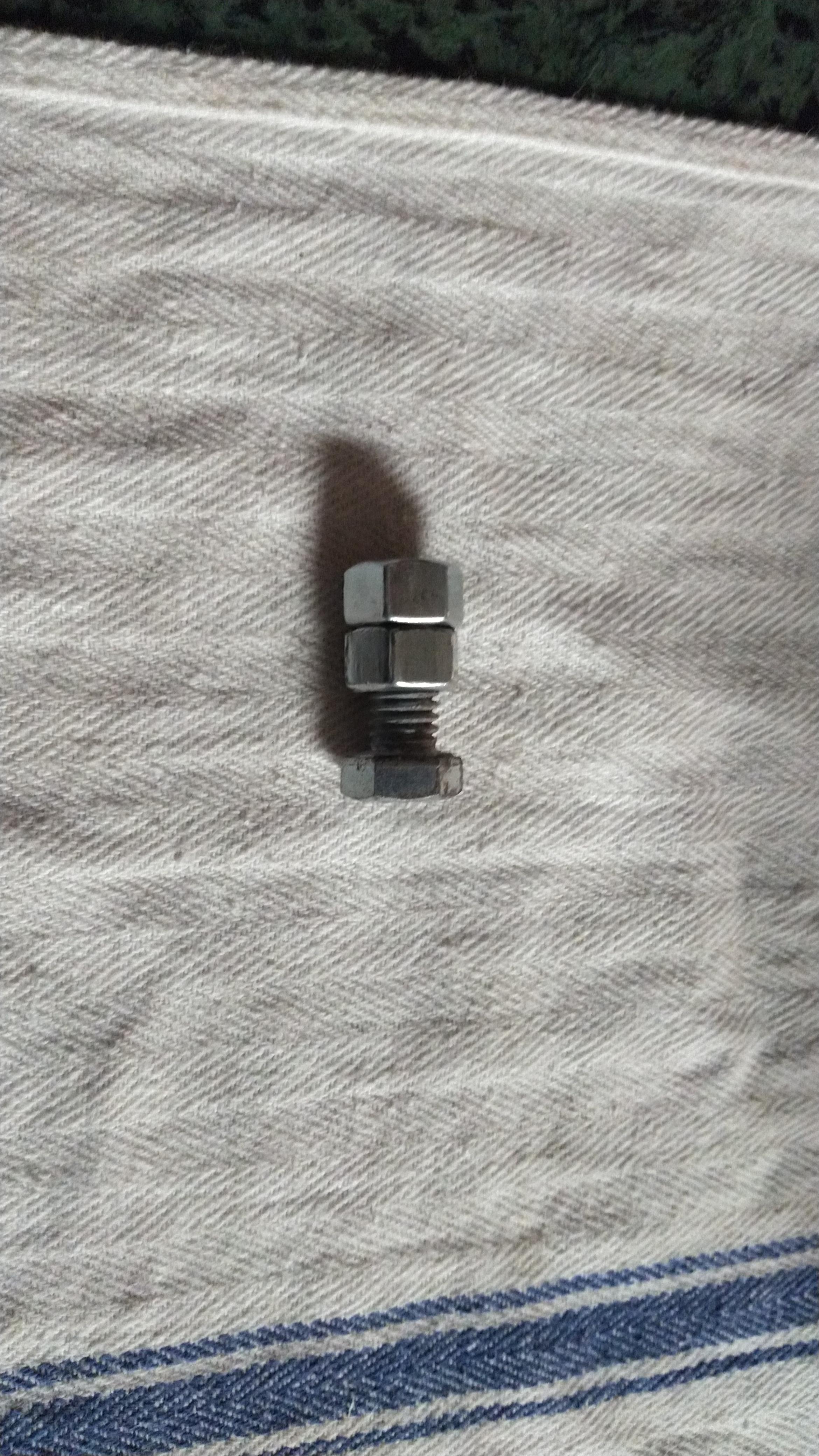

Red
9/16"  i made an allen socket of  sorts with a  3/8" bolt and a regular nut and a lock nut and screwed them on the bolt and jammed them really tight in a vise, so they can take the 50 lbft of torque...  jojo
here is a sample...  sometimes I put a spot of weld on them to make sure it will hold, especially if im taking a pitman arm off, and on...  If it breaks when the job is done, so-what..  or just buy the real socket. I guess it depends on how much downtime you can afford..  I guess this is my Boyscout way of getting the job done.. :) Jojo
Lol..I did this once to take the cap off the pitman arm on my  the steering box .thanks to the magic of Amazon prime , a 9/16 Allen wrench socket will arrive tomorrow at  my door.
Edited by R.E.D
I may have made a boo boo again.. is it 5/8" and you use a 7/16" bolt...  unbelievable..... i just did this 3 weeks ago and my brain just 'farted' I hope you get what i'm saying....  Too funny to me.... jojo
  • Confused 1
it's funny how i'm forgetting the sizes, when I change steering boxes and injectors in e-tech's often,  I can go right to my tool box and grab what I need first try, but forgot the sizes for this post.  i'm going to go to my service truck and dig out the tools.... Too funny, jojo
