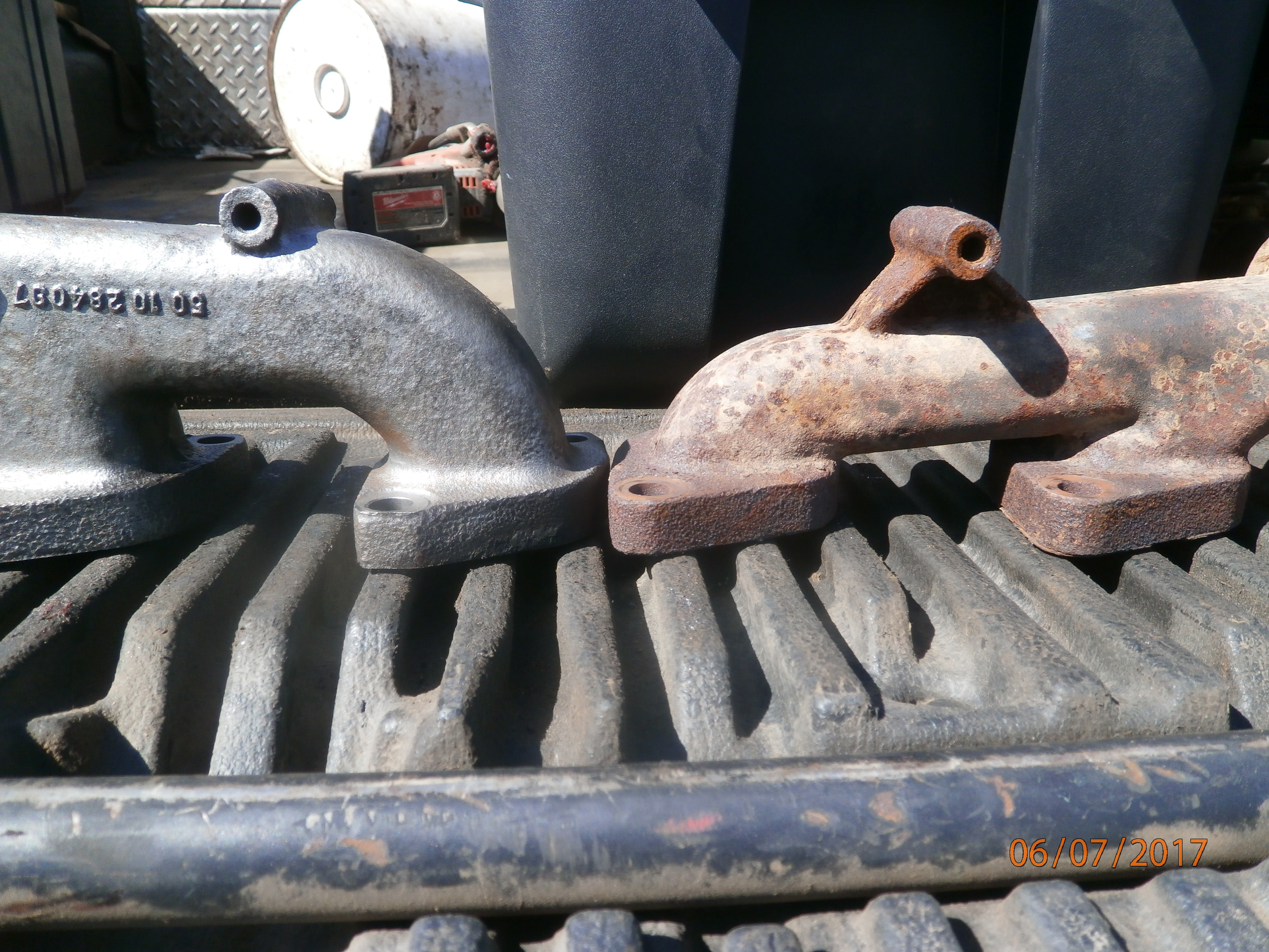

Mack Technician 1,770 Posted June 22, 2017 Author Share Posted June 22, 2017 (edited) On 6/21/2017 at 9:48 PM, nelm1994 said: Well its good to see you back. I was starting to think we were getting censored by some greeney . What year truck was the exhaust manifold from and what model. NELM! The only Greeney was the "green-horn" who didn't realize delete means everything! Mine was 2002 CH613. My old cohorts at the Truck Center said they grabbed manifolds all the way back to PLN..... Just watch out for CL chassis with E7 manifold which tilts upward. Edited February 6, 2019 by Mack Technician 1 Quote Link to post Share on other sites

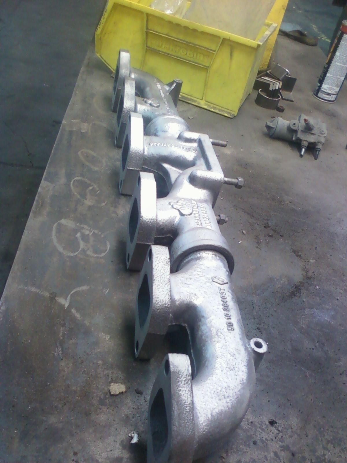

Mack Technician 1,770 Posted June 22, 2017 Author Share Posted June 22, 2017 (edited) Second, I did a sweep of the local Mack graveyards and found the fore-mentioned breather manifold (pre AI/AMI/AC) up at Scott's Northwood's Diesel, paid the man at the door $200, stripped it, bead blasted it to check for cracks and gave it an oil rub down. Perfect condition. Edited June 22, 2017 by Mack Technician 1 Quote Link to post Share on other sites

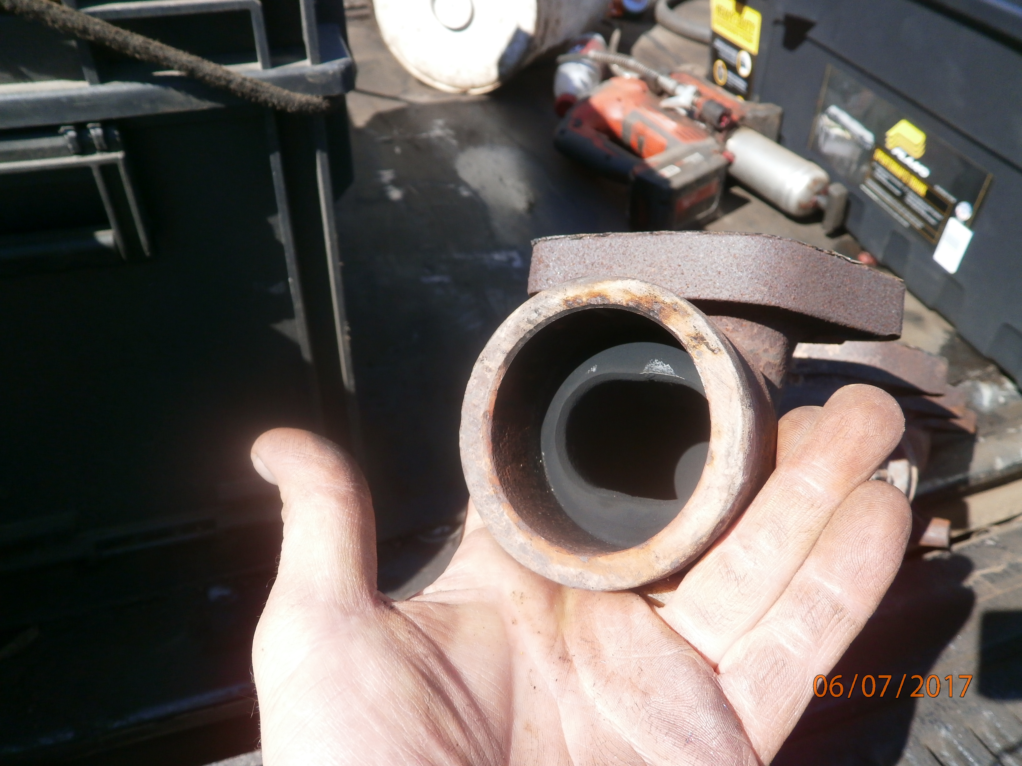

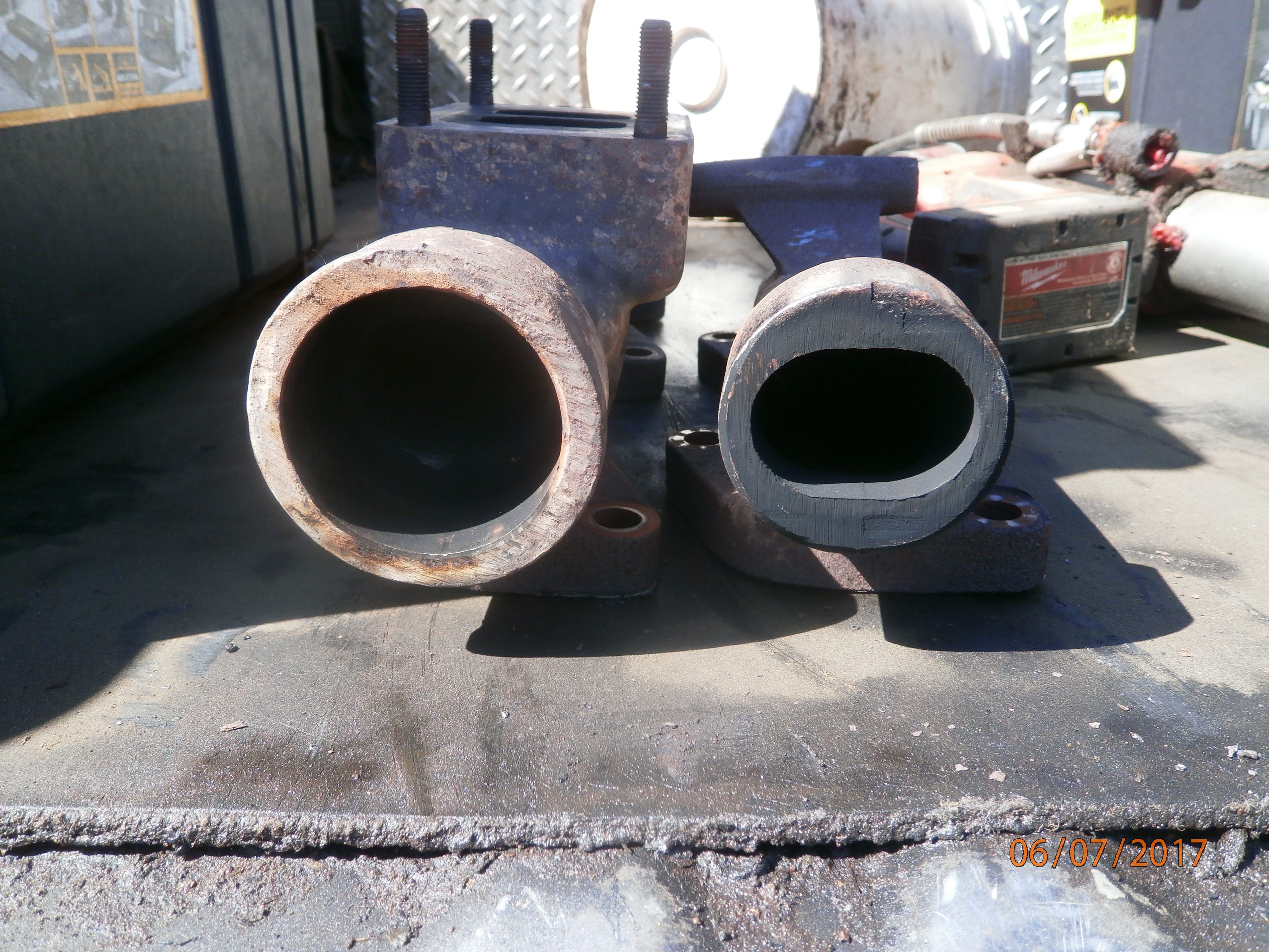

Popular Post Mack Technician 1,770 Posted June 22, 2017 Author Popular Post Share Posted June 22, 2017 "As a dog returns to its vomit, so fools repeat their folly." Proverbs 26:11 High Priority...............need to stop the Dog from eating it's vomit. The Camshaft bump is responsible for sucking back filthy, uncooled, exhaust gas causing high soot return and poor burn. The restrictor Manifold, 4" undersized exhaust pipe and restrictor turbo are all responsible for the back pressure needed to feed the 0.075" exhaust bump. Pre-AI manifold left, AI restrictor manifold right. 3 Quote Link to post Share on other sites
Mack Technician 1,770 Posted June 22, 2017 Author Share Posted June 22, 2017 AI restrictor left E7-Etech right Mounting height/depth/angle/position of turbo is perfectly matched, no adjustments needed. 1 Quote Link to post Share on other sites
Mack Technician 1,770 Posted June 22, 2017 Author Share Posted June 22, 2017 AI restrictions..... 1 Quote Link to post Share on other sites

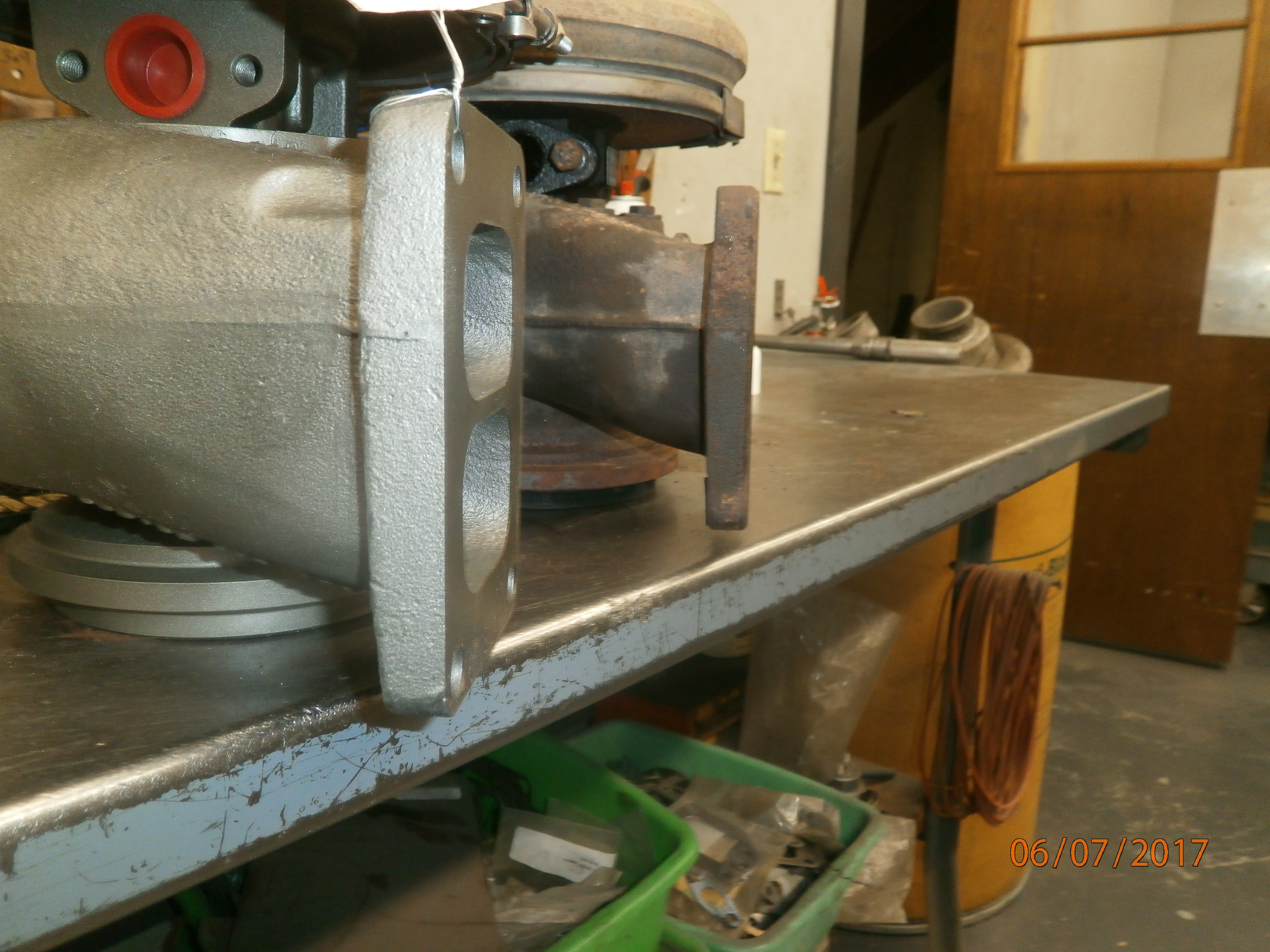

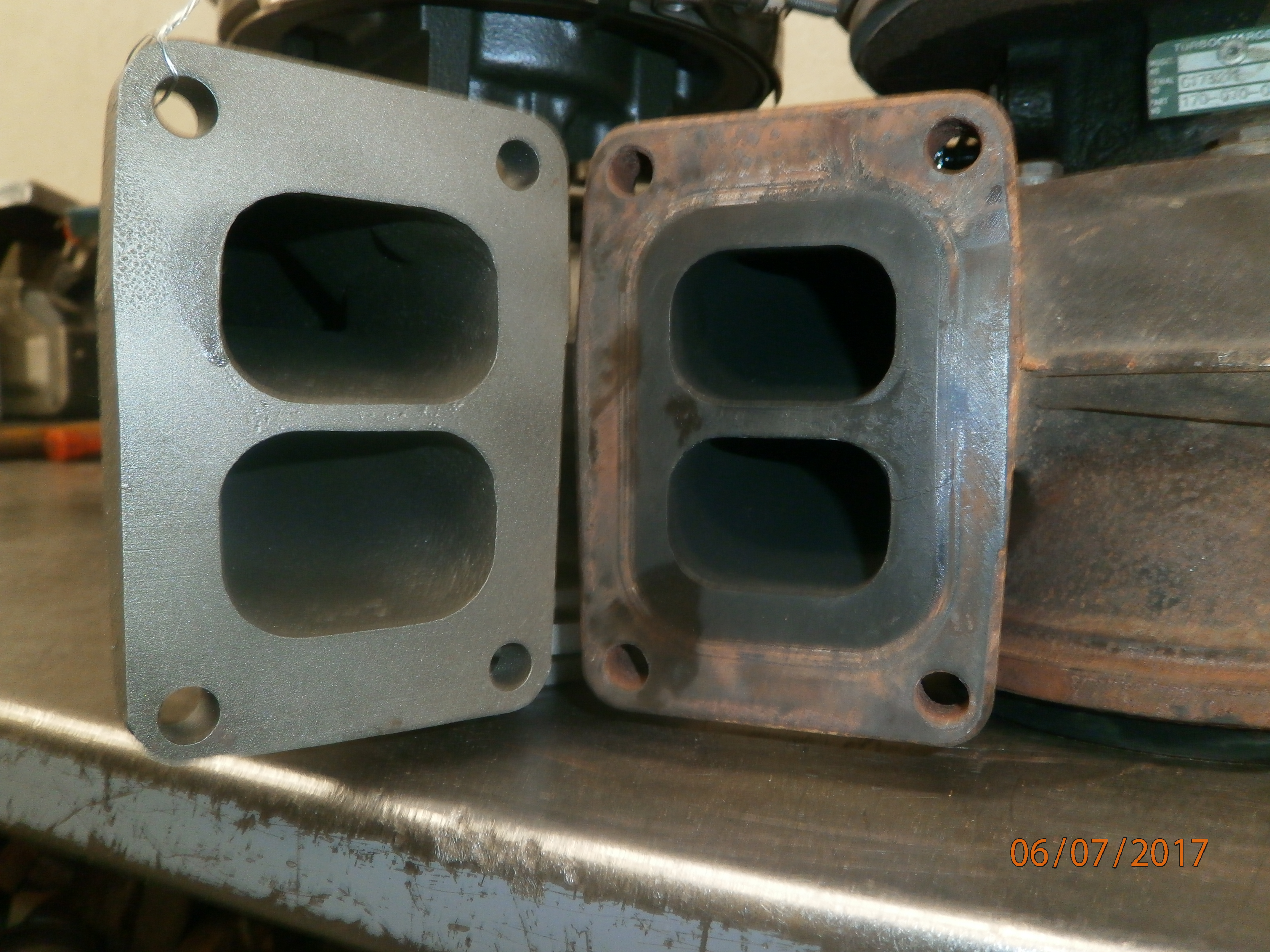

Mack Technician 1,770 Posted June 22, 2017 Author Share Posted June 22, 2017 (edited) Third, get rid of restrictor S300 turbo and replace with a breathable S400. Don't try to hog the S300 out to fit the breather manifold openings, doesn't work. There is not enough meat, they undersized the AI turbo casting. Left side non-AI Right side Stock AI Edited April 15, 2019 by Mack Technician 1 Quote Link to post Share on other sites

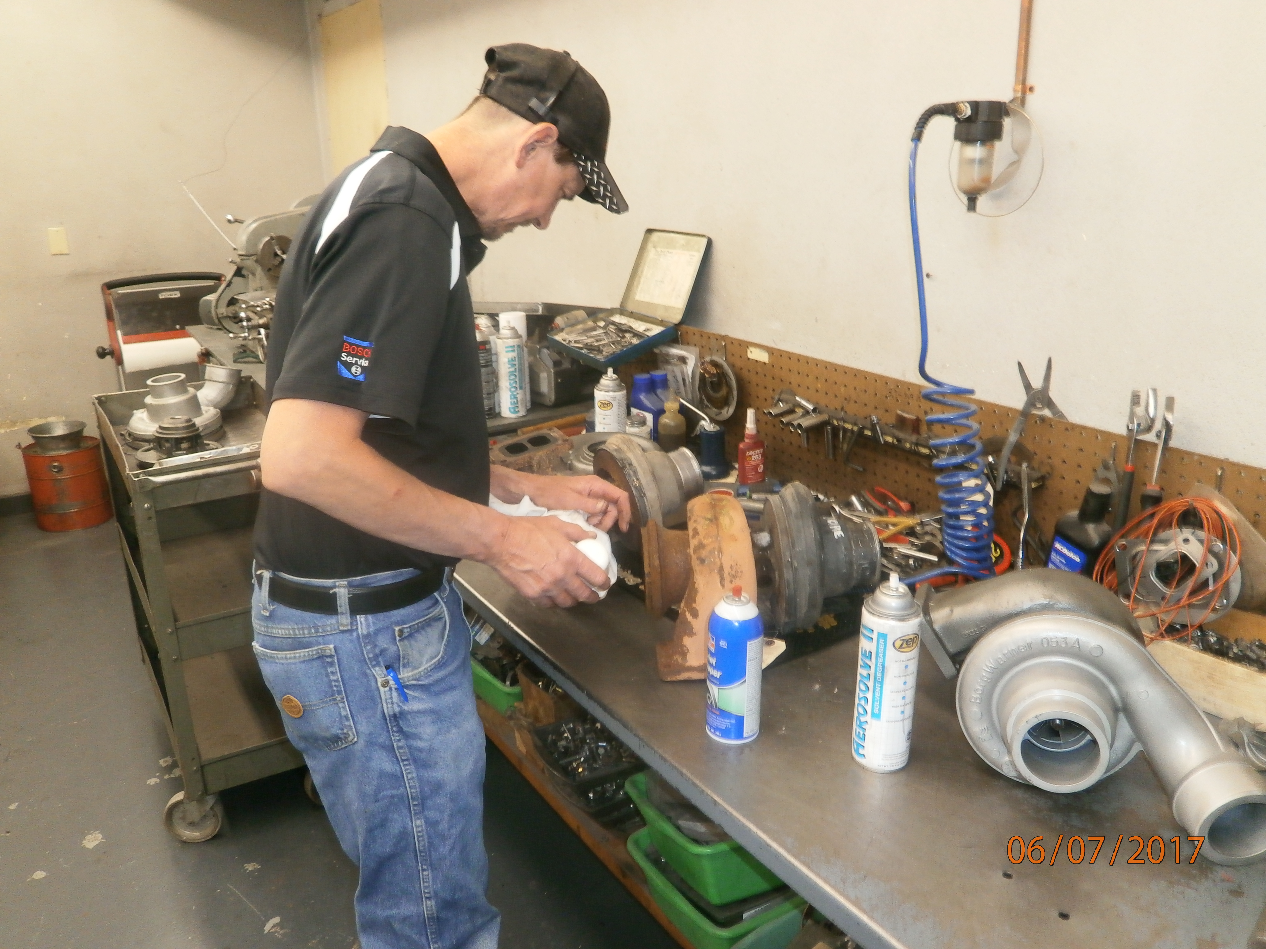

Mack Technician 1,770 Posted June 22, 2017 Author Share Posted June 22, 2017 (edited) No need for explanation...... Injection/Turbo shop guy, Mike, did explain that the 30 gallon recyclable aluminum(in the background) was predominantly S300's. He showed us the internal bearing difference and sold my buddy. For this AI460 and K&S injectors we went with a 631GC5153M turbo(NOTE: only use this number on 427/460HP engine). $1,200 for the new turbo, no core. P.S- In case your unconvinced I will be listing the S300 turbo for sale shortly. Priced to sell.... Edited June 22, 2020 by Mack Technician 1 Quote Link to post Share on other sites
