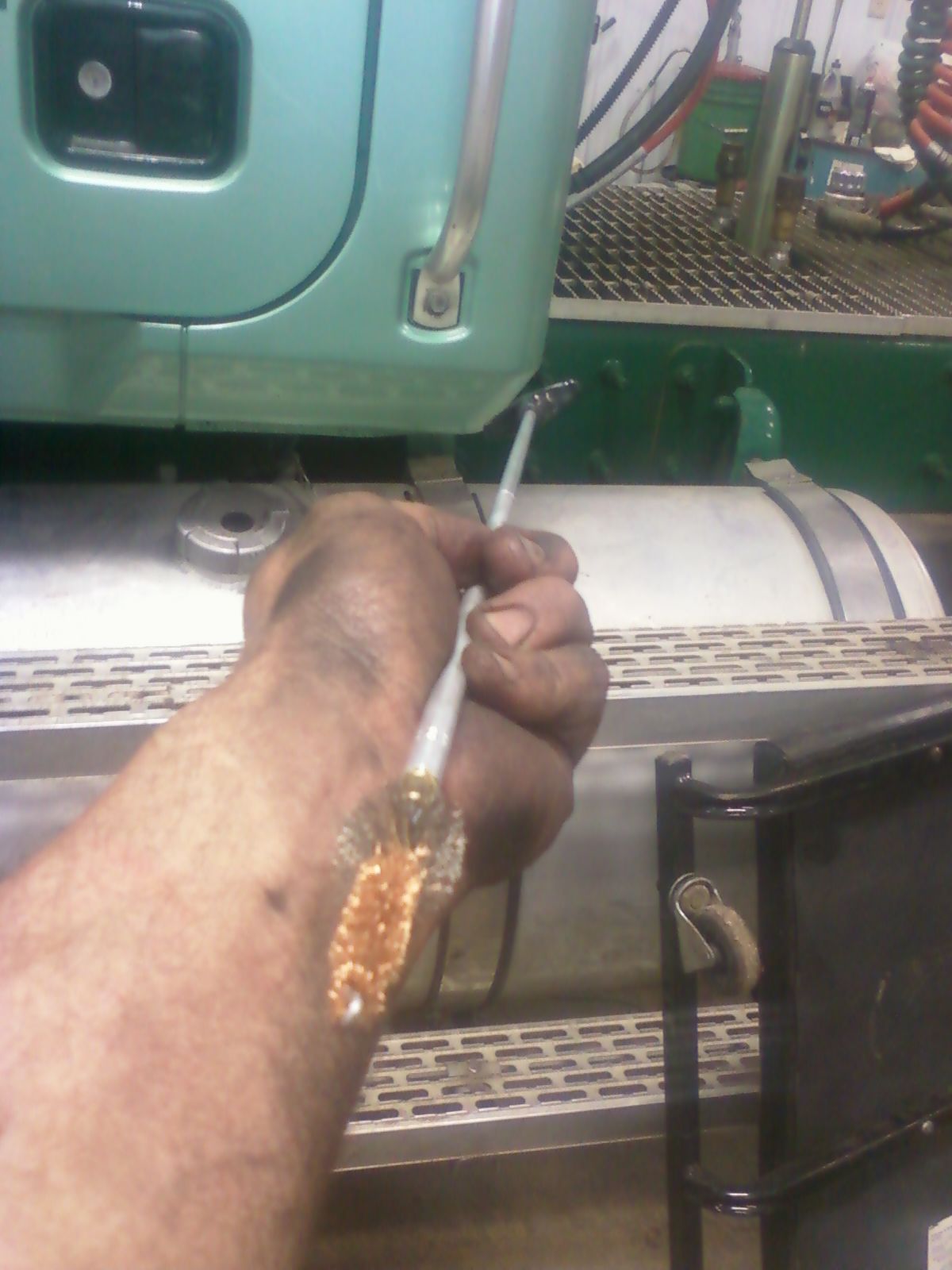

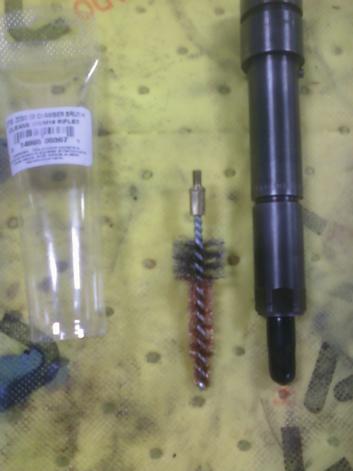

In case you don't have an OEM ream Otis makes a brush for cleaning M4 and M16 that fits the injector shadow well.
I did bend the bristles as far forward as possible to try to get some shoulder strike, otherwise they do nothing to clean the fire ring receiver.  You can't get the ramrod into #6 hole, so you have to cut it or punt.

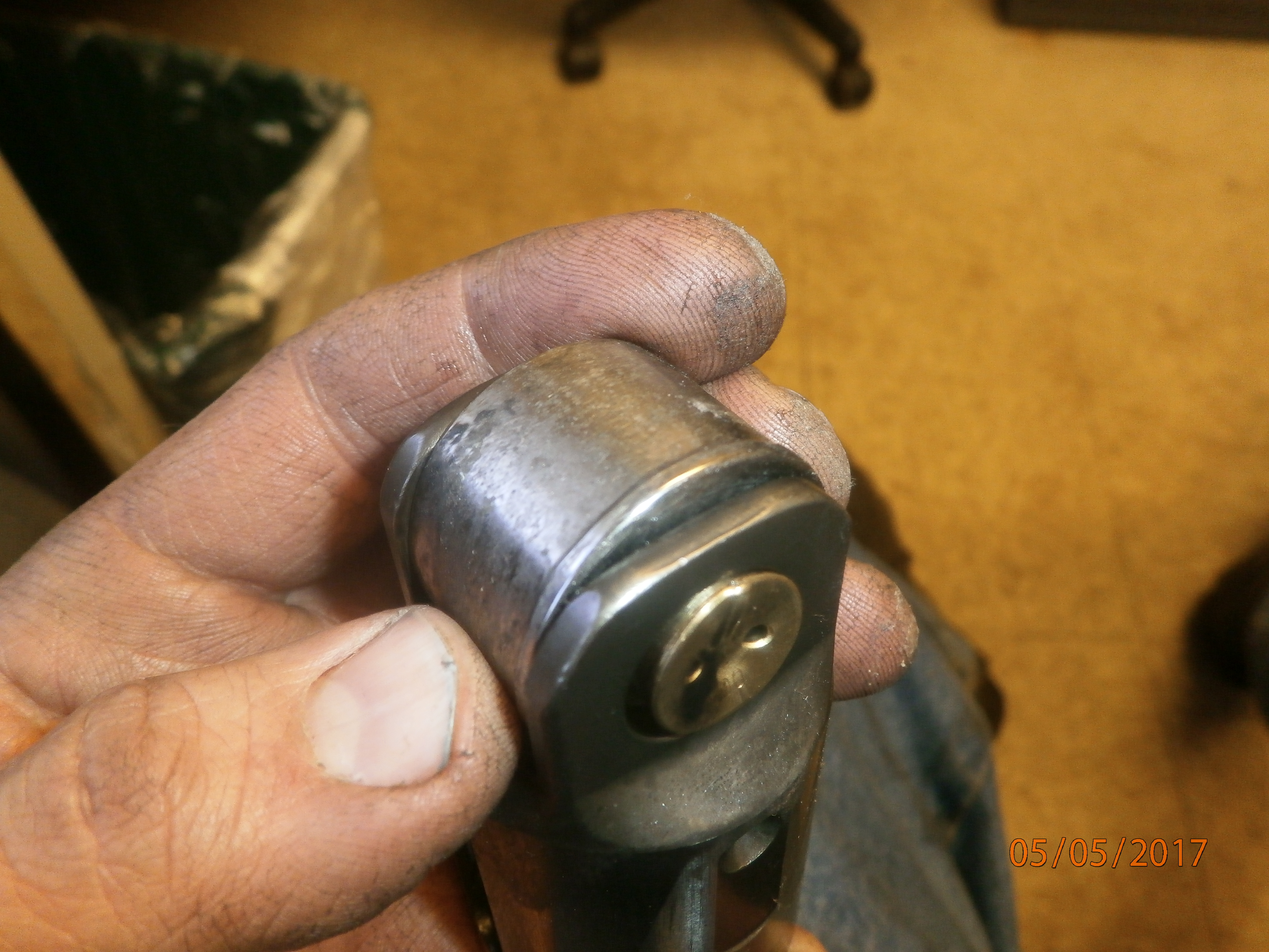

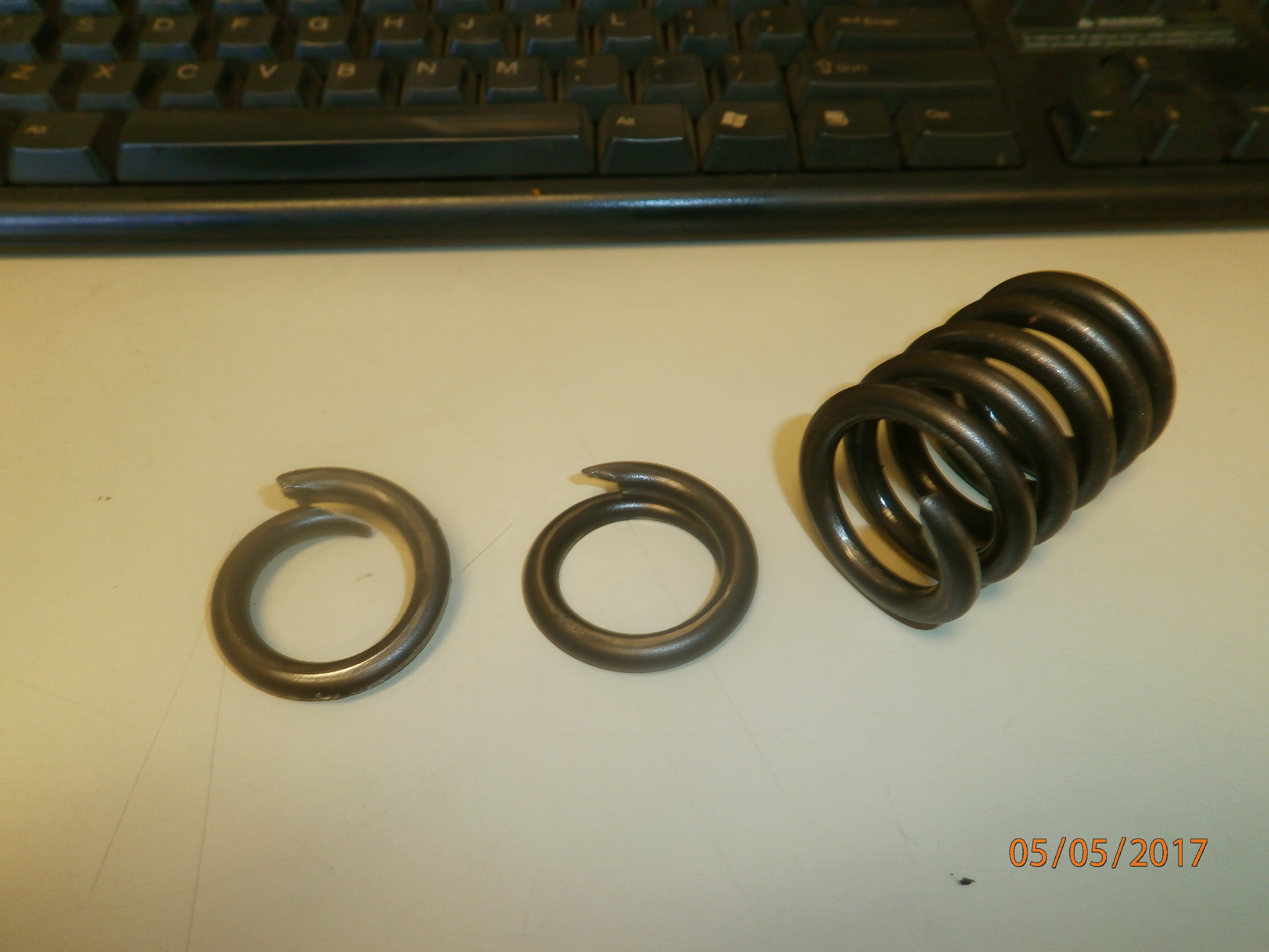

When you have your manifold pulled it is a good idea to check the condition of your EUP’s(and reseal them). If you have a broken spring on an EUP your on the way to a Camshaft replacement. A single break will keep you in contact with the camshaft and the engine will run fine, but when the second spring break arrives your camshaft will be hash. The good news is you could install a Pre-AI CCRS camshaft and be rid of the bump.
As the EUP spring parts pile up in the cup they also start to eat the EUP engine bore by hanging the spring over the side of the follower.
I pulled, inspected and resealed a few of ours, but stopped when I ran into some wire screws that were certainly going to snap off. Road Salt country!
This is a double EUP break I pulled out of a Swedish built 2011 Liehberr D936 last May. It took out the follower, camshaft and damaged the block (not a block fatality though). It lost the cylinder and started a  metallic hammer at point of roller unloading from the Cam. 15,000 hours on engine. Two of the EUP's had spring breaks.

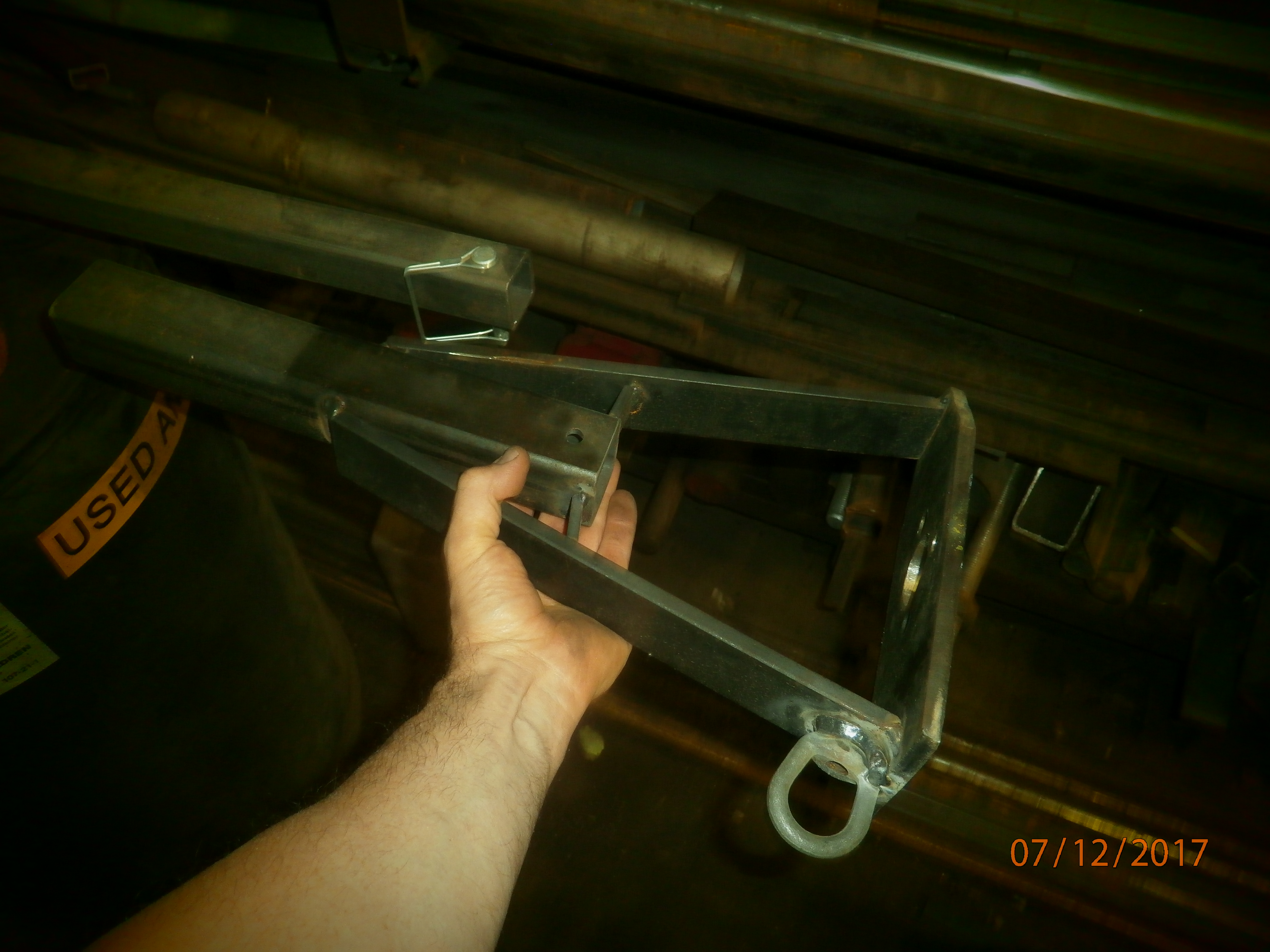

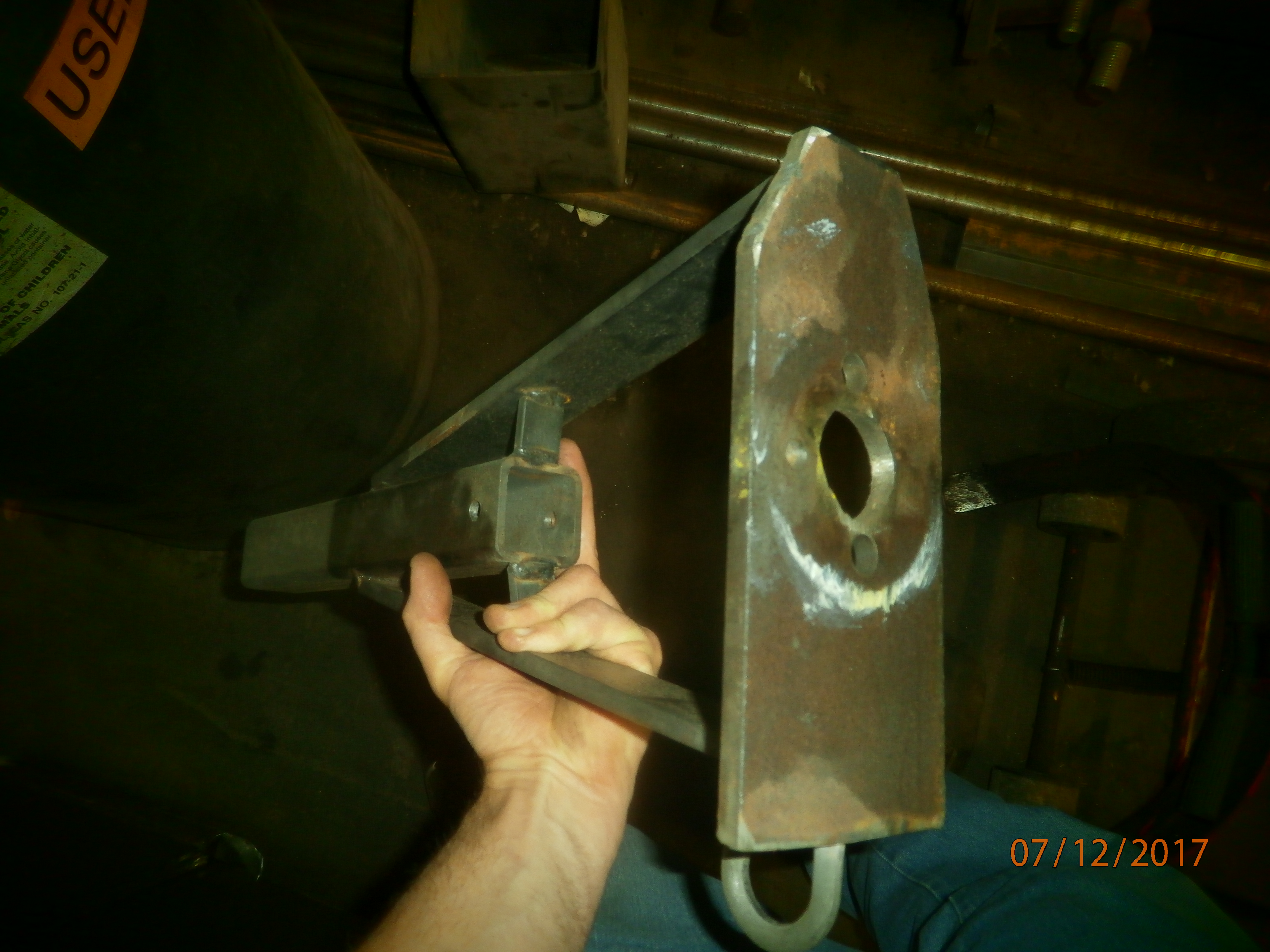

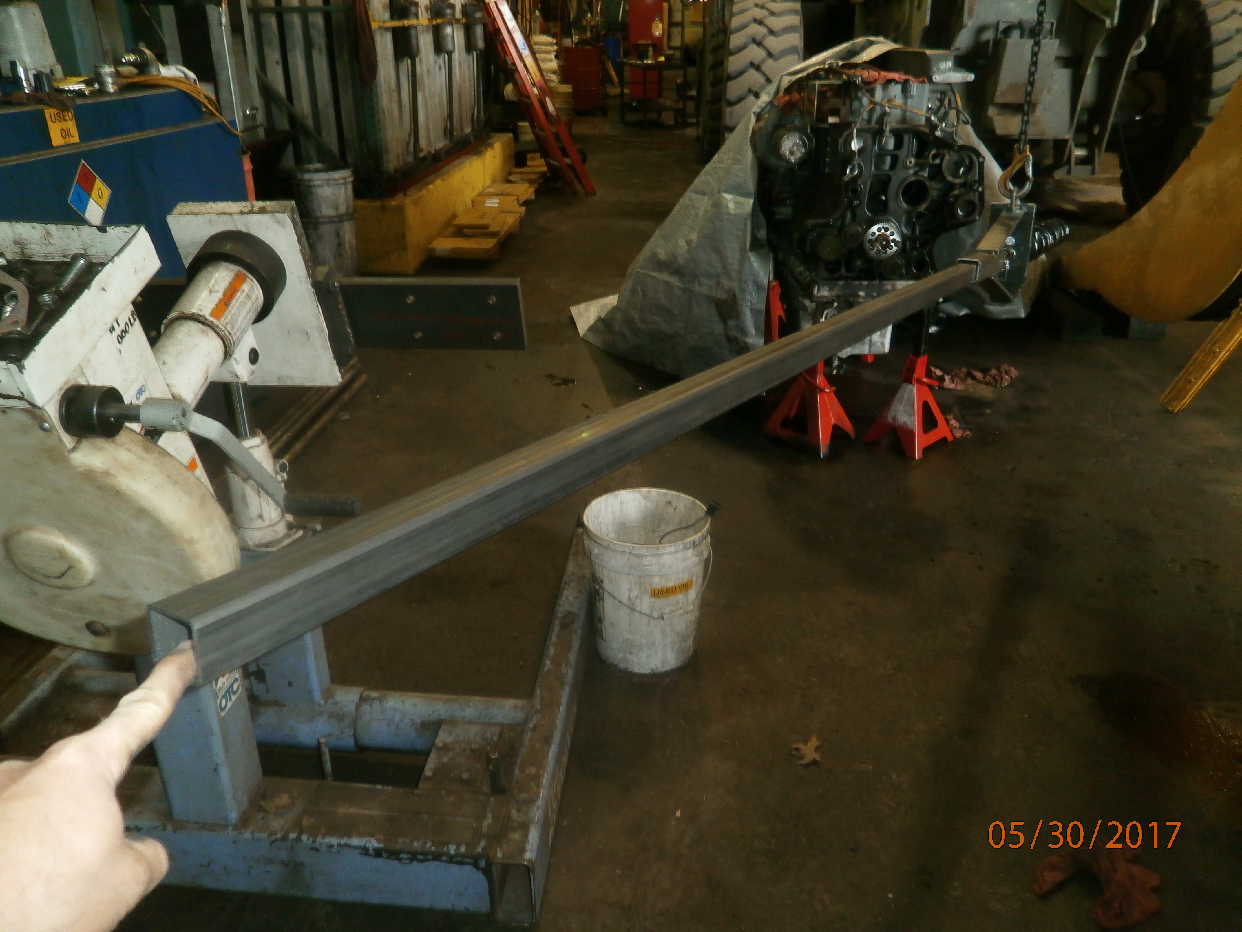

Missing my Mack camshaft removal shoe.....:(. Had to build our "Swiss magic zero-gravity wand" since the Germans are certain their cams never fail and there is no call for specialty tools.
I'd like to see more pics of your cam tool. We use the shoe and man handel it in. Back in 2000 through 2002 I was doing 3 ETECH cam jobs a week for weeks at a time , only to redo some as new updated parts came out. Wish I had that energy now!

Sorry man, it would not work on the E7 build since you have a sweat fit cam gear and no bolts. If I'm recalling back accurately the MP7,8,10 and Volvo D13E are top-loaded camshafts, capped, for overhead removal?
It really was fun and easy to install with this thing. I wanted to pull it back out and put it in again but it seemed wreckless. As I get older I can lengthen the beam ;).

Yep,  you heated the ETECH cam gear in a oven and dropped it on the key wayed cam shaft. Camshafts in the MP motors just lift off the top. I like thoses because you don't have to remove the hood.
