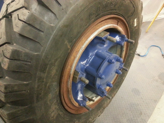

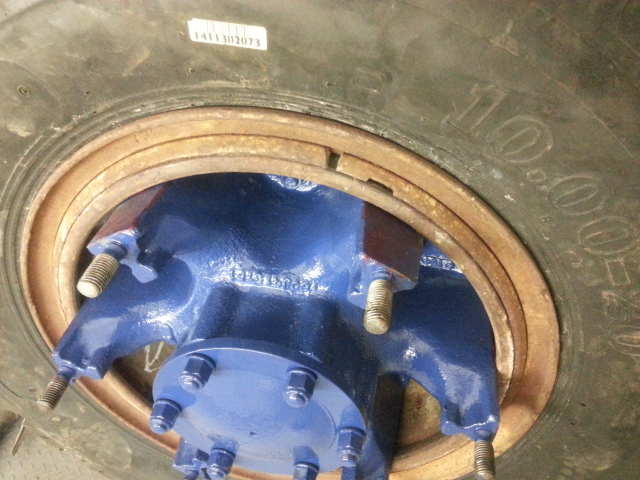

Some info please. I picked up the new tires after they were all mounted. Tried to put the rears on to test fit before painting. Well,the inner wheel will only go on less than half way and "boom". It stops dead and won't go on the hub farther. The outside of the spokes have no paint on them,  and I even tried to grease them.....no help.
Is there something I'm missing?  I assume they should fit snug on the hub but,  HOLY COW. I tried hitting the tire and rim with a rawhide mallet but still nothing.
Also, is there a difference between the front and rear rims?  If there is then I have to take two back and have them switched.
Lastly, should the bead lock on the inner rear wheel should face out against the spacer that goes between the two wheels?

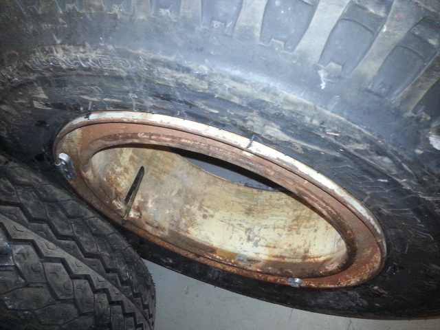

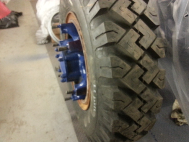

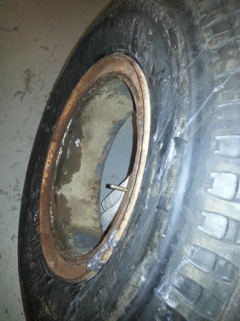

The last two pictures are the front wheels. See the difference between the two outer edges?  One ring looks like it stands out in relation to the tire sidewall.

It just seems strange that the rears go on just so far and stop dead. They aren't even touching the outside of the spokes, it seems to be the slight lip and the inner most rear of the hub that is causing the issue.
 The spokes on one hub have absolutely no paint on them, and the rim has very little paint and no rust that would seem to be stopping it.
The pictures of the rear shows how far they go and it's as if something is keeping them from going any further.
Nothing has changed except new tires. :pat:  I'll get there eventually I think.
