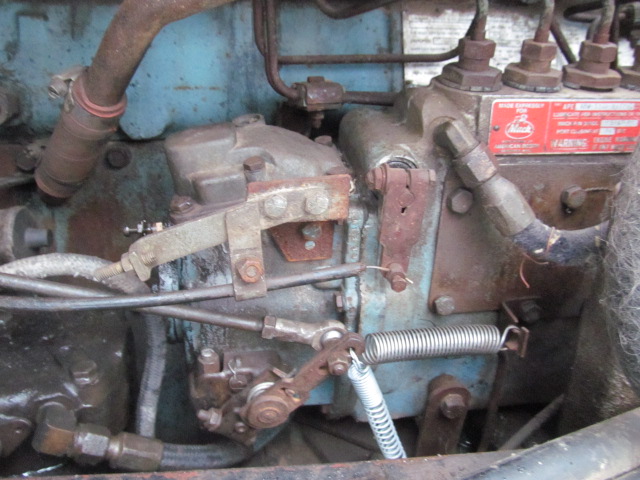

Ok so im due for new governor springs in my 79 RS600L, with an EM6-300.  Its doing the lopey idle thing with a lopey acceleration.
I have never done springs before and this is my first Mack.  So, what all is involved?  I will be having an injection shop do the work but I need to know if I have to remove the entire injection pump or can I get to the springs another way?  I don't even know where the springs are...

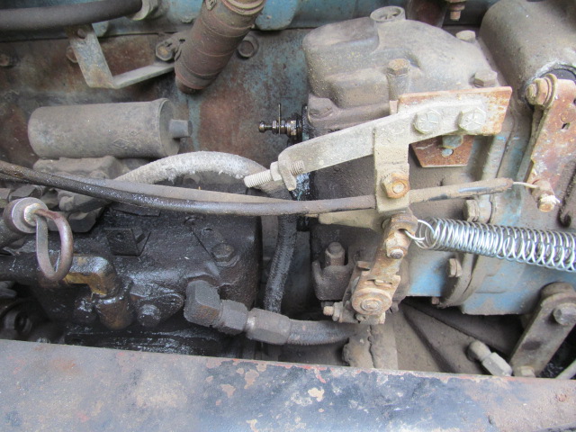

I could be wrong, but wouldn't the springs in question be the external ones in your picture? Where the excellerator linkage goes into the pump? I see you have one Spring hanging down.
Try installing that 2nd spring and see if it makes a difference. Will cost you about 2 minutes.

The external springs in the picture are the throttle return springs.  They are both new but the horizontal one replaced what was there from the factory, or at least it looked factory.  The other one is just an extra one that I put on for good measure, to be sure that this wasn't casing my issue.  All it did was make the pedal stiffer.
There is defiantly something going on as it hunts at idle and when I accelerate softly, it does it then to. Its like im going down the road and getting on and off the throttle every second or two, but in reality, im holding it as steady as I possibly can.  The entire linkage is tight and no play anywhere
So should I look at bushings instead of springs??  I have no idea where to start
Ok so pull the whole pump and have it checked out, ok.  If I knew it was the springs, does the entire pump need to be pulled anyways? or can the back part be removed from the main body of the injection pump?
