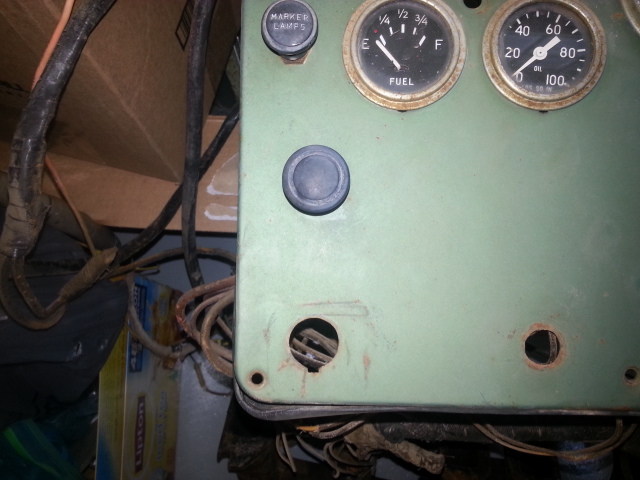

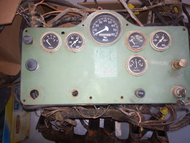

My b 42 has a foot operated starter push button mounted on the firewall just below the steering column. I've noticed others have a push button in the instrument cluster. My cluster still has a hole where a button could have been.
Which one is correct? The floor mounted one looks like it could be original and it's a pain in the behind to operate. You need to be a contortionist with one extra foot to reach it.
I think that's the way to do it. This truck is supposed to be a 1960 model. Kinda old technology for that year though.
I'm still waiting for the information from the Mack museum to find out the exact year of this truck.
What gets me is the hole in the cluster looks like it had something in it at one time. But the starter button on the firewall looks original as well.
The panel or the cab or both could have been swapped out at some time but who knows. I'd get the panel switch which is available and change it out...These are not 1000 point show cars right? It will be correct and aid in functionality at the same time...now if only we could erase this posting, nobody would ever know... :whistling:

To my knowledge that is the starter switch hole...no tachometer?
Most gas powered had no tach, it wasn't that critical for the power band. Paul
Was thinking that too Paul. Have never seen a tach in a gas powered Mack.
