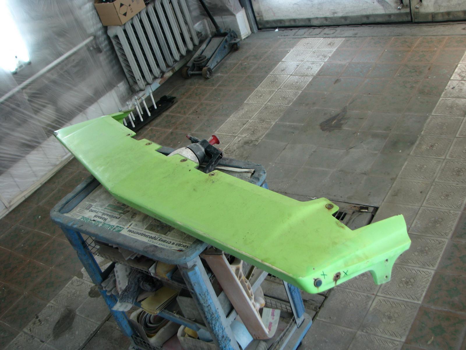

I finally found a fiberglass cab visor for my truck but I've noticed that some trucks have a little metal brace under the center of the visor that bolts to the cab right above the drip rail.
My visor doesn't have that piece. If I install the visor anyway, what are the chances that the thing will rip right off the cab without that center brace?
I have driven trucks with and without them. I did notice the wind will make them flex if its real windy out and your on the high way.
Thanks. I haven't been doing much highway stuff with the truck so maybe I'll put it on while work is a little slow and then maybe make a bracket for it at a later date.
Without it, will sometimes vibrate and make noise
yep I had that happen as well . its annoying as hell!!!
I had a IH with a stanless steel visor do the same thing depending how hot it was out. It even with the center brace installed. Made for some long trips out west in the summer time. And nothing made it stop besides if the temperature dropped. I put a bunge cord on it. stuffed tennis balls between the cab and visor. it just would warp when hot out and vibrate for miles.
