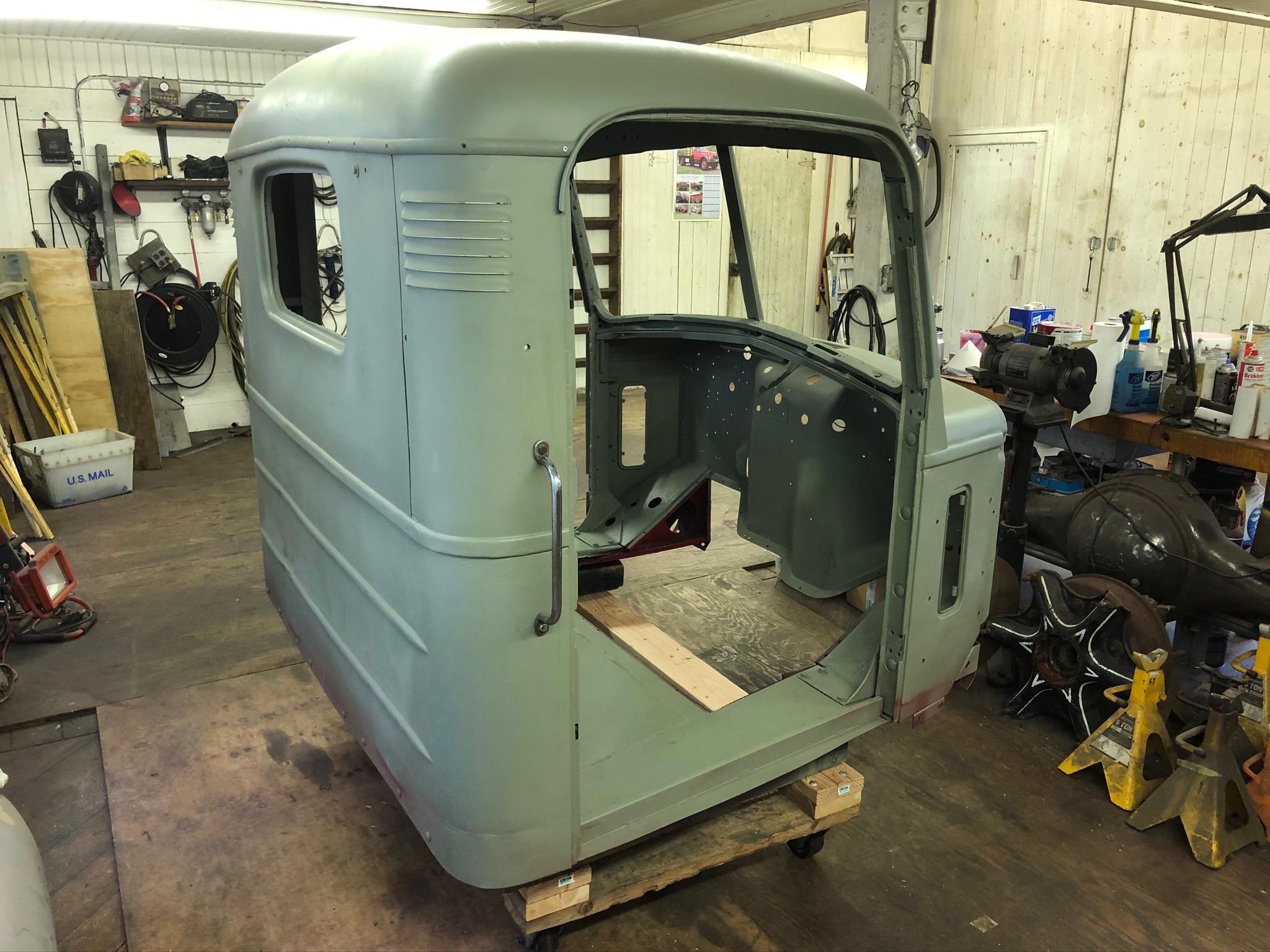

I was, but you beat me to that rearend so now I have other things to do, LOL. While this truck was mostly there when I found it, it was really used up. Everything I’ve worked on needs attention and that takes time. It wasn’t designed for construction, which is where it spent its final years. The good news is that it will be literally brand new when I’m done.

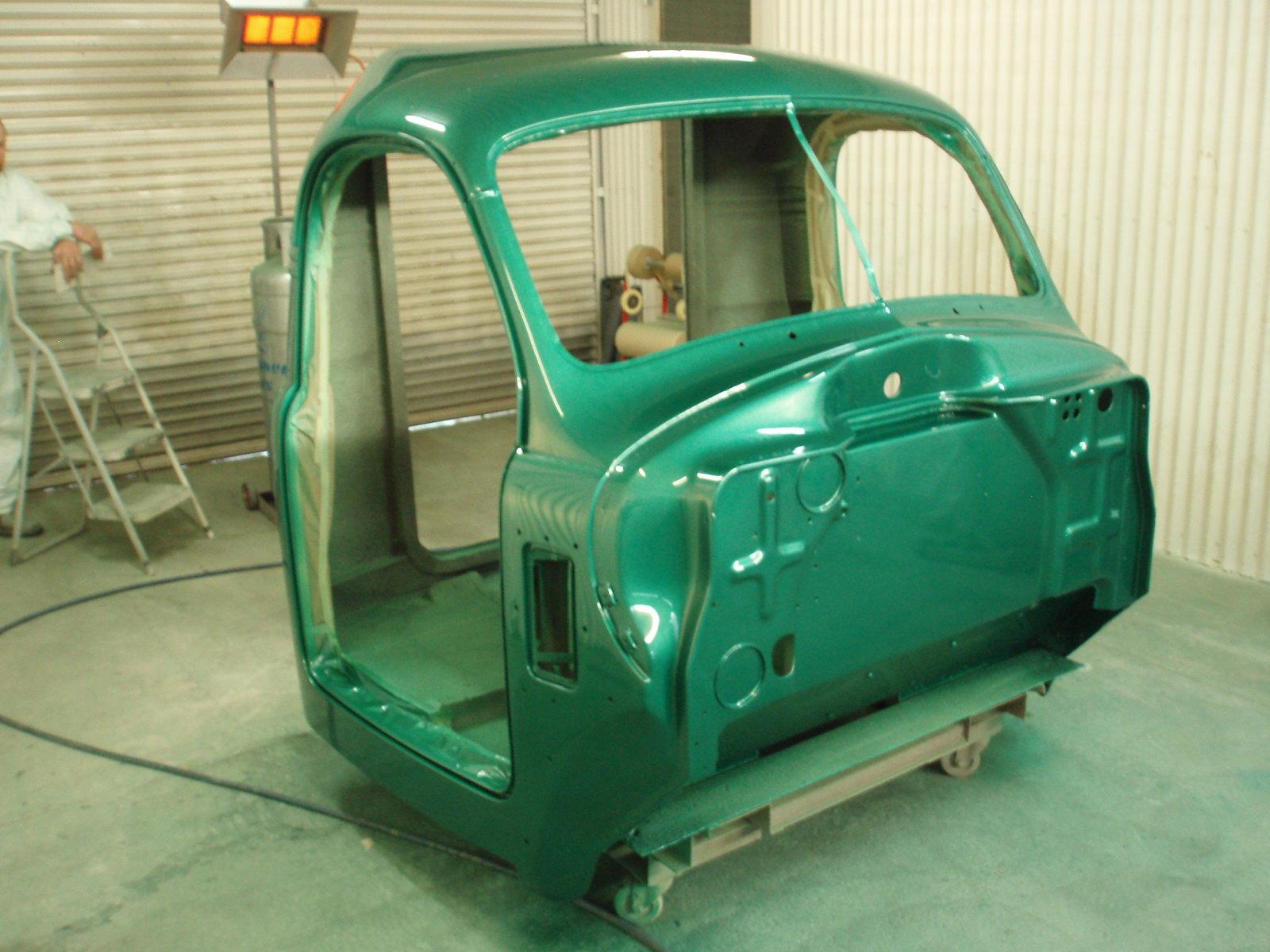

I may be repeating my previous posts, remember if you plan to apply to the engine bay side of the fire wall and then apply finished red paint over the LS, you have to apply a mixture of hyfill and about 35% flex additive first over the LS, let dry and then rub back and most likely you will have to apply a 2nd coat of the hyfill and flex additive to get a smooth finish, so then you have a smooth finish to undercoat and thereafter the top coats. It will come up like the external panel finish, you will get the LS benefits and the fire wall behind the engine looking great.

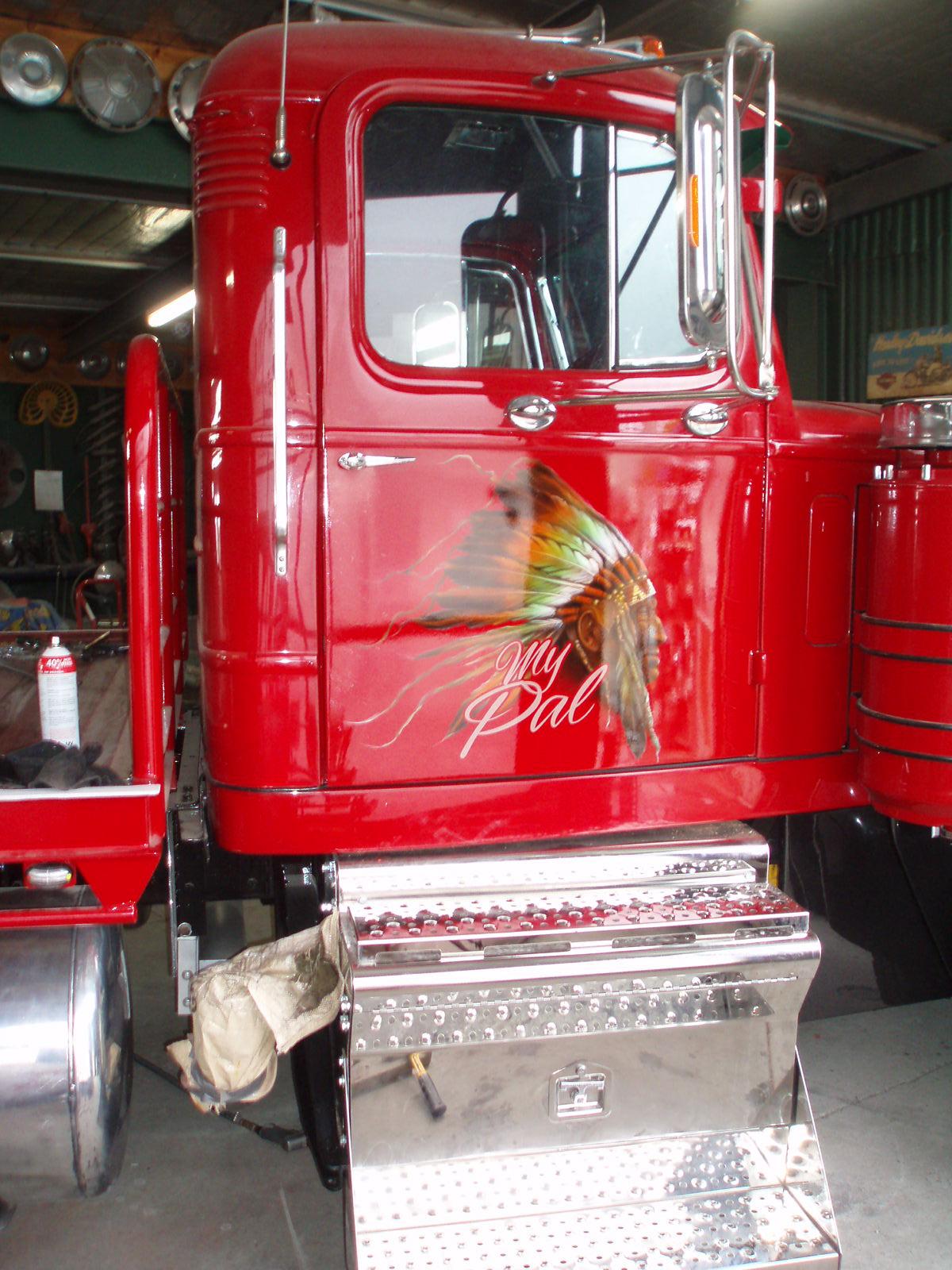

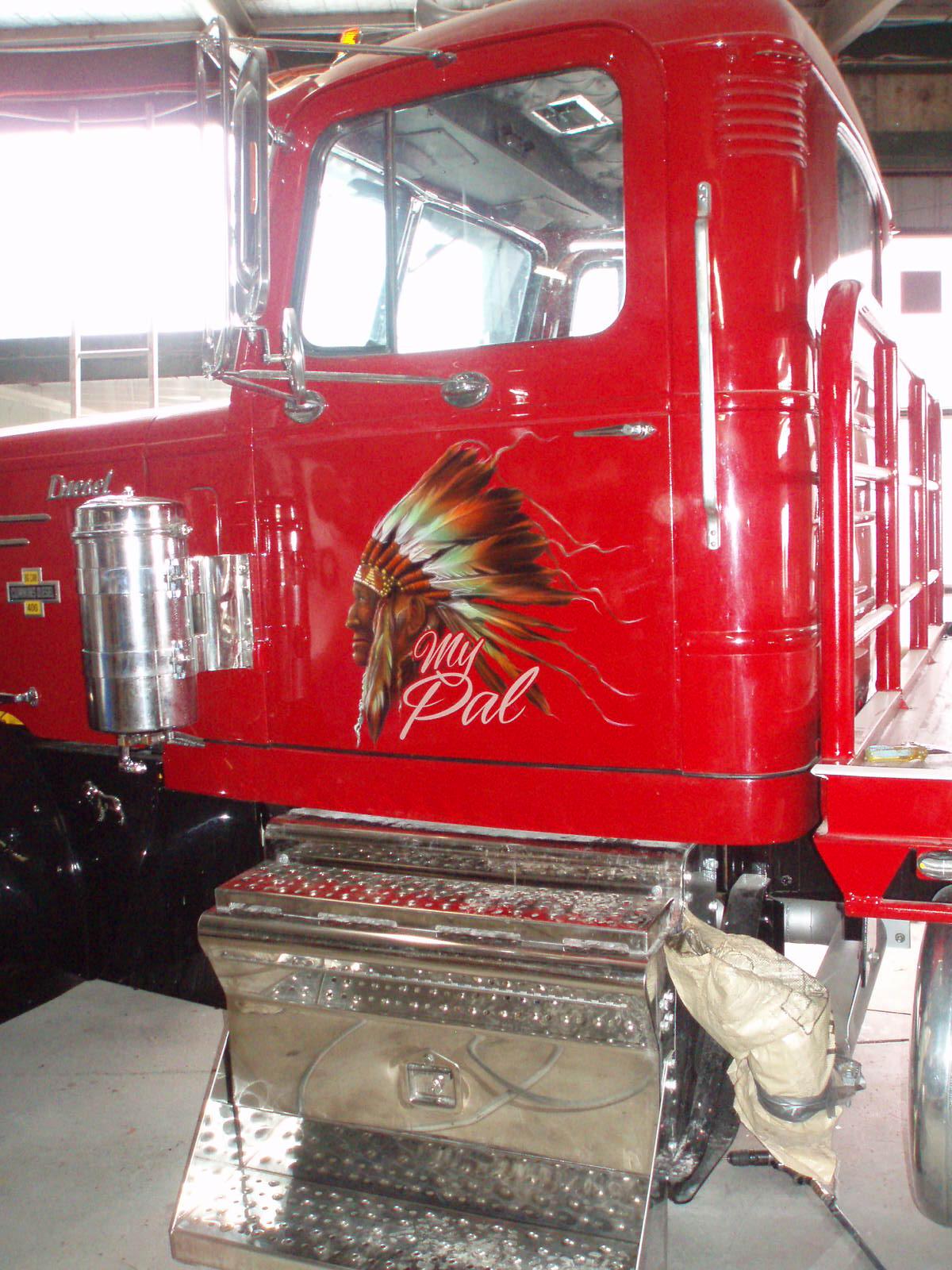

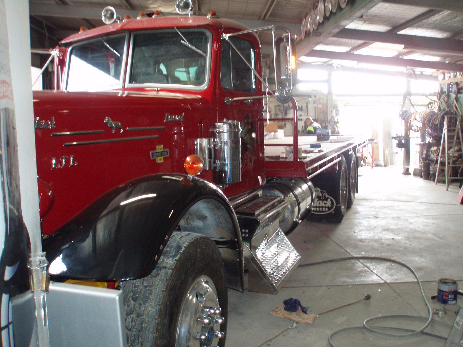

I look forward to soon see your completed cabin painted - our departed and missed dear friend Mack devotee "Ian Lee" always said - " trucks are red and tractors are yellow, if it's not red leave it in the shed"!!! Here is Ian during the build of his custom Diamond T - Princess Diana and his Pal, his Pal got a complete application of LS and Ian's favourite and only colour.

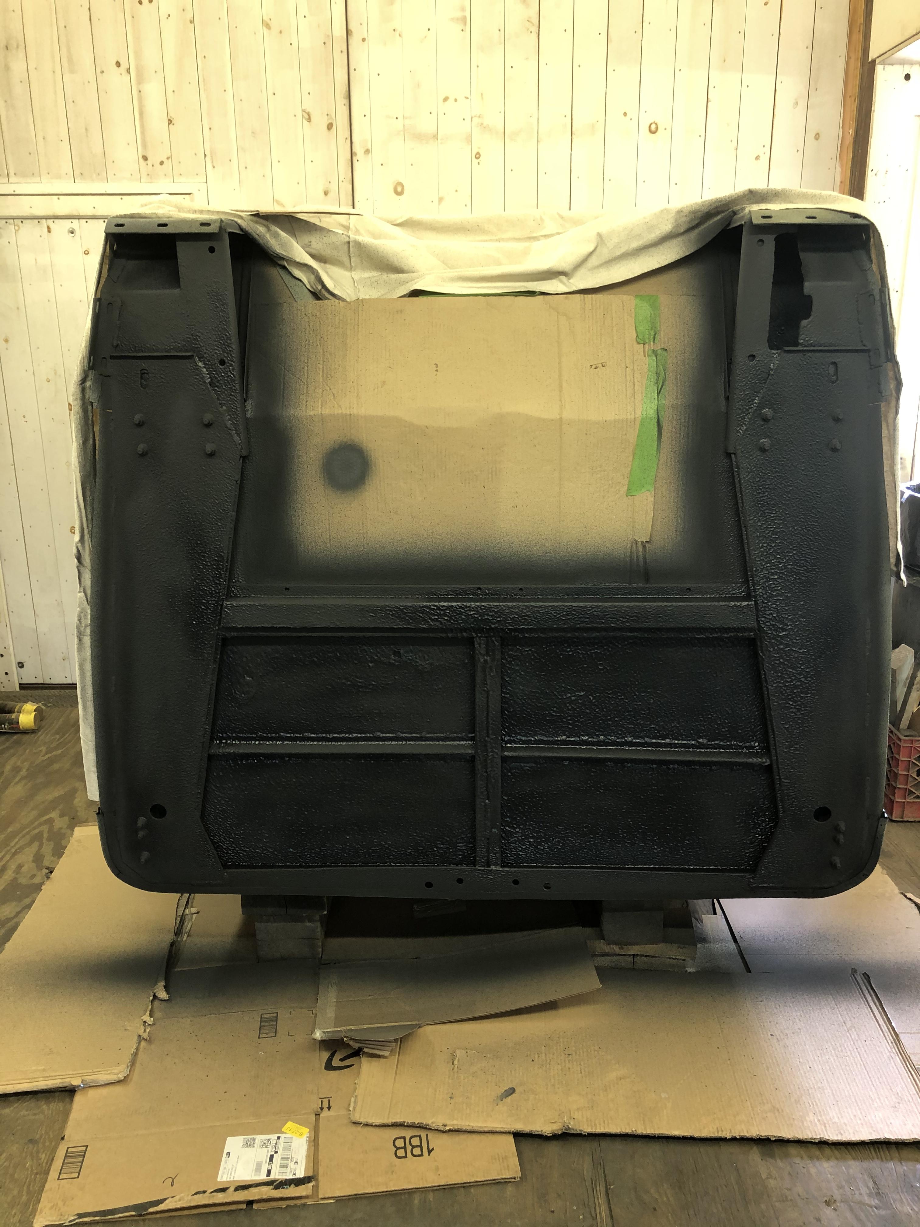

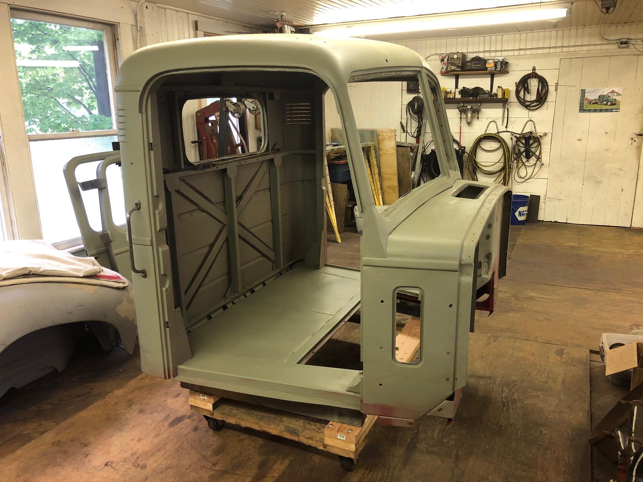

Yes, I spent a lot of time getting into all the nooks and crannies, making sure everything was well coated. I got a little overzealous in one area and started a sag by going too quickly. For the firewall, I’m going to do the inside and cover it with the firewall mat. My thought there was to use it to cover up all the unused holes and to better seal it. There’s a lot that gets mounted to the engine side an I wanted a cleaner look.
I’m also going to coat the underside of the cowl, back wall, roof and door inners. So far it seems like a good product. I’ll need more to finish, as I was surprised how much I used on the bottom of the cab.
Regardless, it’ll still have more soundproofing than the factory.

For your firewall please see our firewall, we have lots of fittings etc including our custom vintage air co fittings, but the smooth mirror finish is clearly seen behind all the fittings. The aim is to stop the sound and the heat getting into the firewall metal from the engine side, that is the best 1st action that is overlooked. Once the engine side of the metal is shielded, it is at least 75% of stopping heat and sound coming into the cab. The inside cab is about 25%. The same as the cab floor, you have applied LS to the underside, so the heat from the gearbox will not penetrate thru the floor. Same principal for the fire wall.
For the firewall holes, may I suggest that you weld a thin plate on the cab side over the holes that you will not use. Then you can apply the LS to the engine side of the firewall and then the hyfil to build up to a mirror finish.

Ian's LTL Pal had the LS applied same as our B model, it has straight exhausts and a 400 HP Cummins, he got same experience a I do in our B model.

Matt - what are you planning to do with the 2 vents on the rear of the cab? Ian welded a curved plate inside over both vents stops water and all else getting into cab and upholstery and all inside cab had LS applied
I dont have a picture of the plates he welded, but I will try ask his panel guy if he took some pictures.

I was going to cover the corner vents with a patch of Dynamat, until I found a better solution. I'm not sure if I want to permanently close them off, but still worried about sound coming through.
Also, are you saying just use a high fill primer over the LS to smooth out the texture and then paint? I was planning on doing an experimental panel to come up with a smoothing solution before paint.
Yes apply  the high fill in 2-3 progressive layers over the LS but you must add approx 35 of flex additive to the high fill because the LS is flexible whereas the high fill is solid, by adding the flex add to the high fill then the high fill will move with the LS - when I say move it means the product is flexible, and that is ok, after each HF you apply let it dry thoroughly then sand it back to even it a bit then apply 2nd HF with flex add, let dry then rub back, if after 2nd coat you have a smooth surface then you can apply an undercoat also with flex add, let dry and rub back to get smooth finish and then apply the final red paint with flex add in the red.
That is how we did our fire wall engine side and we have a mirror finish which you see in my picture.
If you need to apply a 3rd coat of HF then that wont hurt because you are building up in layers to get a smooth surface before  you spray the undercoat.
It sounds like a lot of work but the final result you will be very happy and get the benefits - once done you will look back and forget the extra work, but it is done properly, which is what the LS inventor, Bob Call advised me to do.
Remember the trick is to add the flex add so all the products can flex in parallel with the LS. And that is what I have seen with underside of our hood, it is aluminium we applied LS with some of our external green paint mixed in and the hood twists when it is opened and lifted, so far after 5 years no cracking or peeling of the LS because it is flexible - hence the name like the lizard skin.
With your cab wall vents they serve no real purpose unless you want a permanent air flow. If not seal them with a thin aluminium or metal sheet, painted black facing the vents, and stick on with a long lasting glue so you dont have water leaking thru into the cab, (when you wash the truck) and no bugs or mice to damage the upholstery, do this before you spray the LS over internal cab walls. That is how Ian Lee did the vents in his Pal LTL, from outside the vents look as original.
