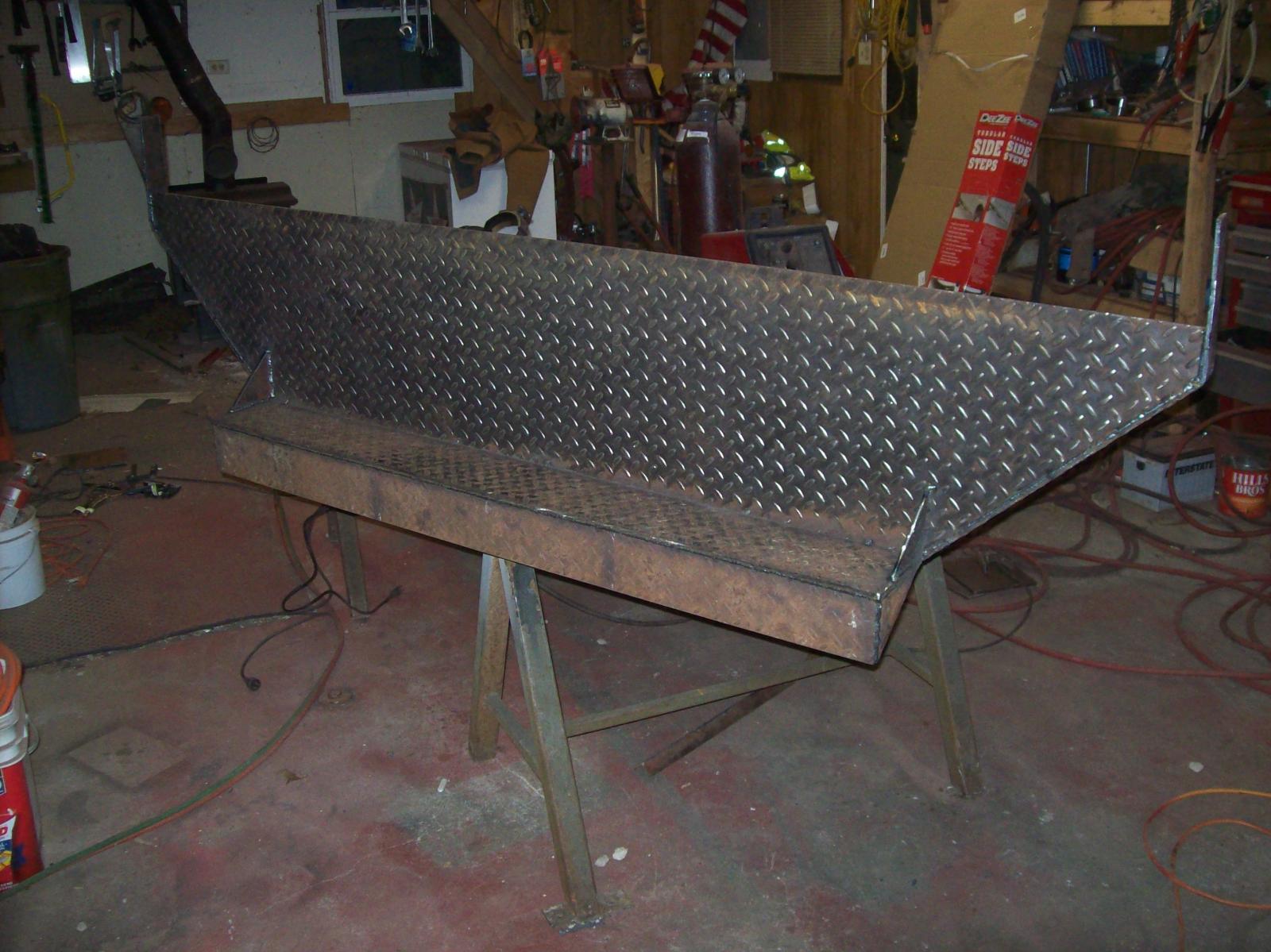

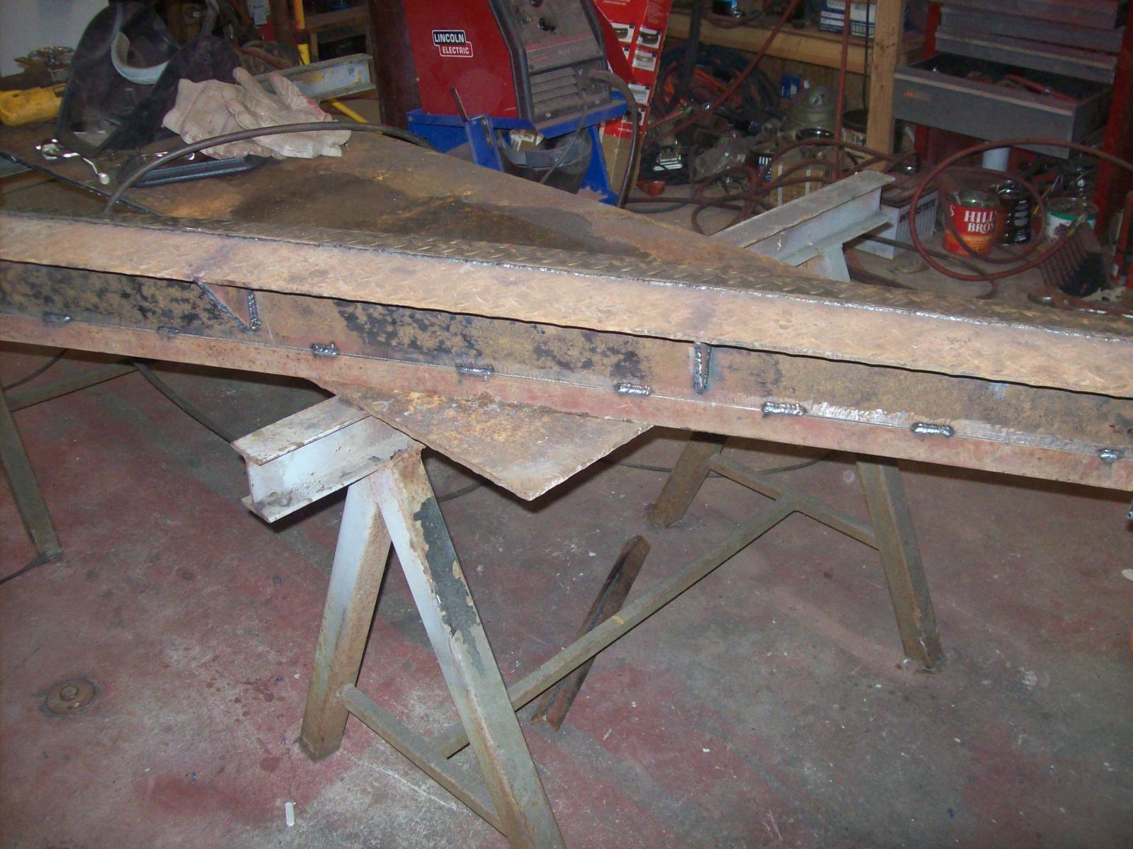

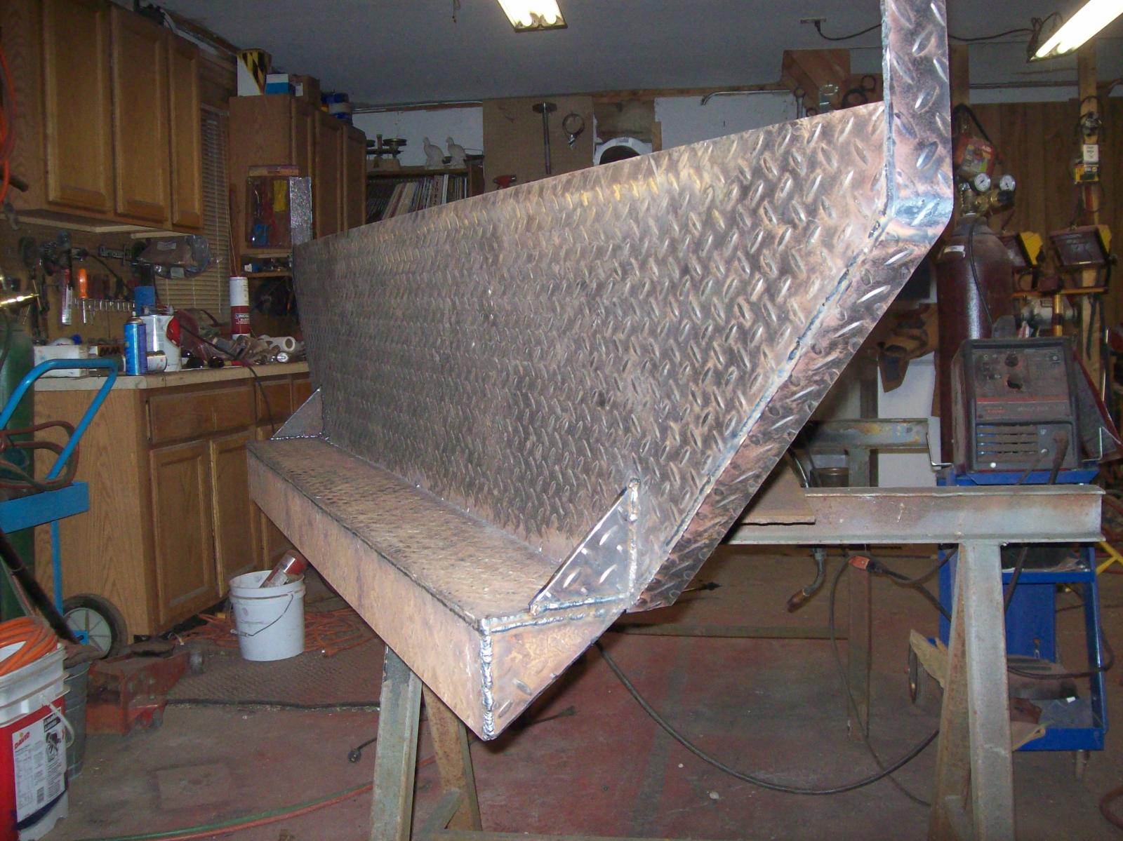

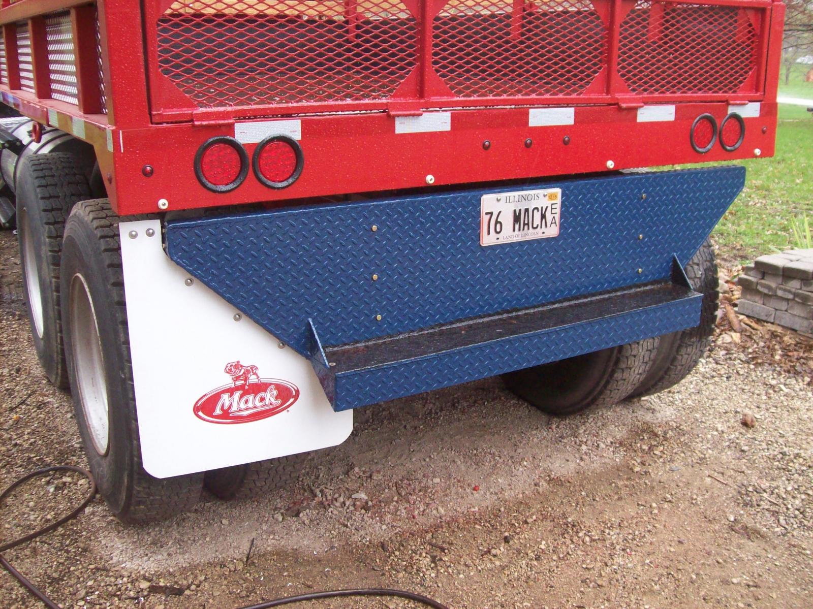

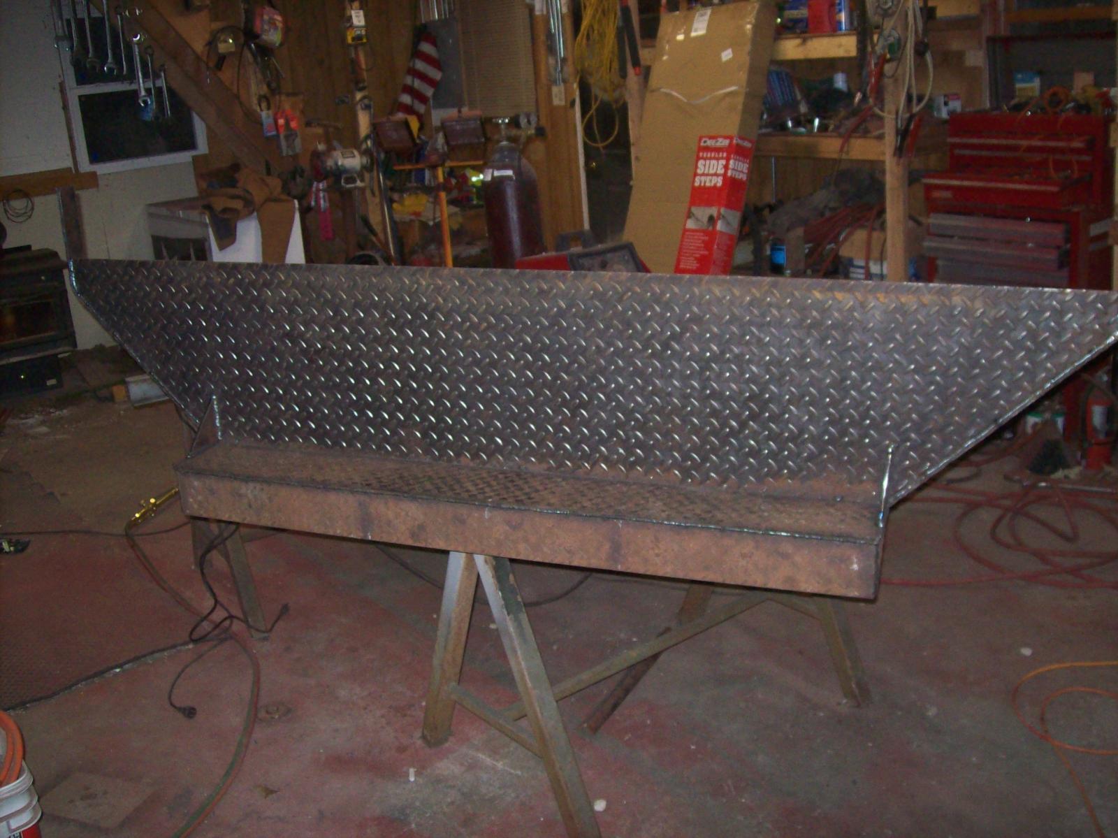

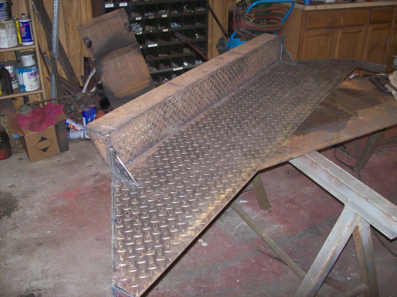

Got busy today made a rear step bumper and filler panel for the cargo bed all 1/4 inch diamond plate all torch cut then welded together I got all the pieces cut yesterday after work. I got lucky the scrap buyer down the road had several eight foot long by 24 inches wide pieces charged me sixty bucks which is a really good price I have been pricing new and wasn't to happy with the idea of having to spend that much and I have no problem wire wheeling the rust off to save some cash. I am going to make the brackets that bolt to the frame tomorrow after work this will bolt to them so I can easily remove it if needed I will rhino line the step and paint the rest red like the truck all that's left to do on this is run a weld bead along where the step joins the filler panel and weld on the top strip and cut off the excess on the side strips.
post-18980-0-93435400-1427674403_thumb.j
post-18980-0-21371600-1427674427_thumb.j
post-18980-0-07321200-1427674452_thumb.j
post-18980-0-15462600-1427674492_thumb.j
post-18980-0-28889000-1427674513_thumb.j

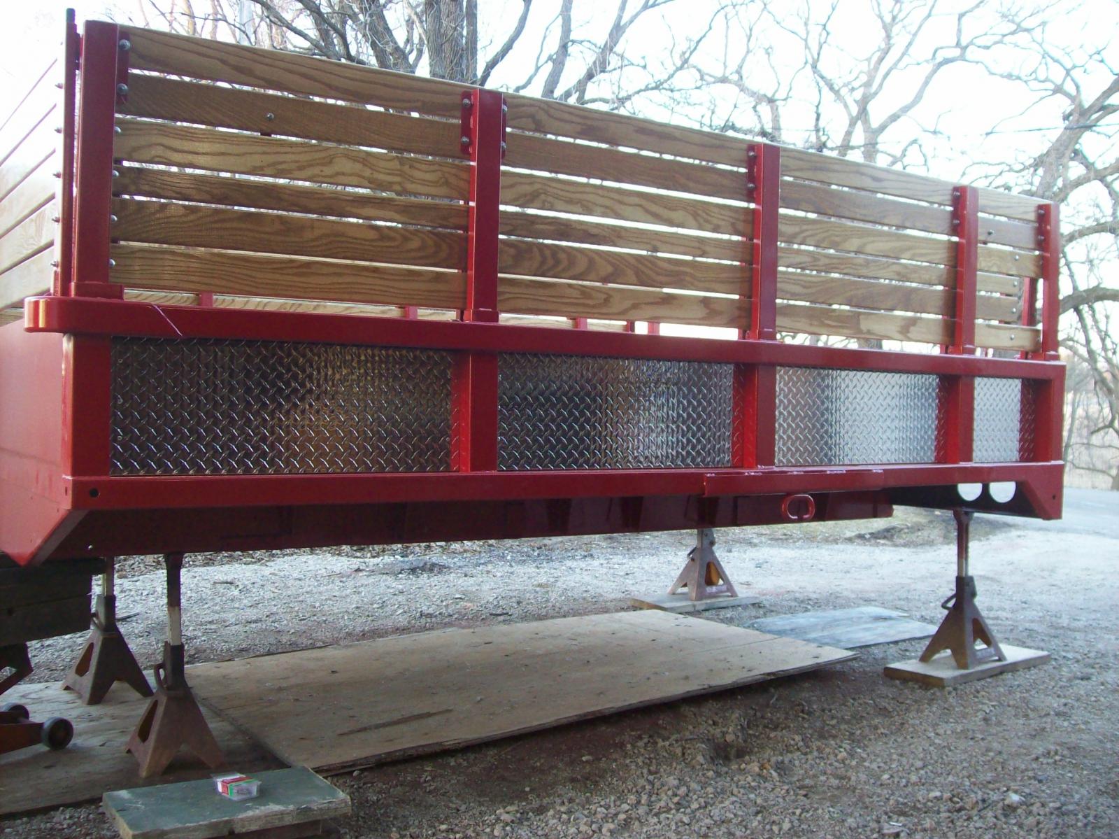

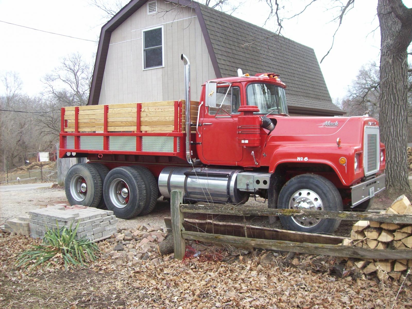

I like the way the truck looks with the bed.
It's short indeed but looks nice.
Wonder how it might look painted khaki... No, no, stupid thoughts :)
Looking good. Are you planning to put a weight in the new bed so it smooths the ride out. My RS rode pretty bad when it was just a rubber mount cab. The superliner air ride cab set up I installed took most of the kicking out of the bumps.
