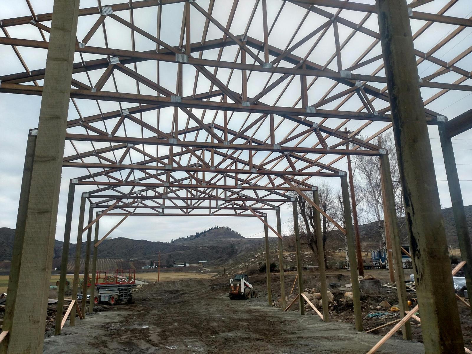

this was a engineered build. the county said any thing over 15'11" must be engenered. but a machine shed falls into the ag, exempt category so after paying 500.00 bucks for the engineer to say my idea was plenty strong, I decided it would be a machine shed , no building permit or inspections. as far as the Dry sprinkler system I have installed several and if the insurance co. makes it worth my while I could consider it. i'm lucky enough to have enough water supply (1000 gpm spring) but would need to add a booster pump.
as for the runway too many power lines next to the shop.............helipad .......hummmm?
ants.......don't have to worry about no stinking ants. the posts are 8x8's and set in 4.5 sack mix 30 inches deep with another 18" to go on top plus rebar thru the posts, (my thickened edge will tie into the existing postcrete.) plus the leanto's will take any "rack" out of the building. I also went 15lbs. heaver in snow load on the trusses than what is required for this area. steel would have been nice but the electric wiring cost go up a bunch (all in conduit) by code. wood frame\pole can be done in romex.

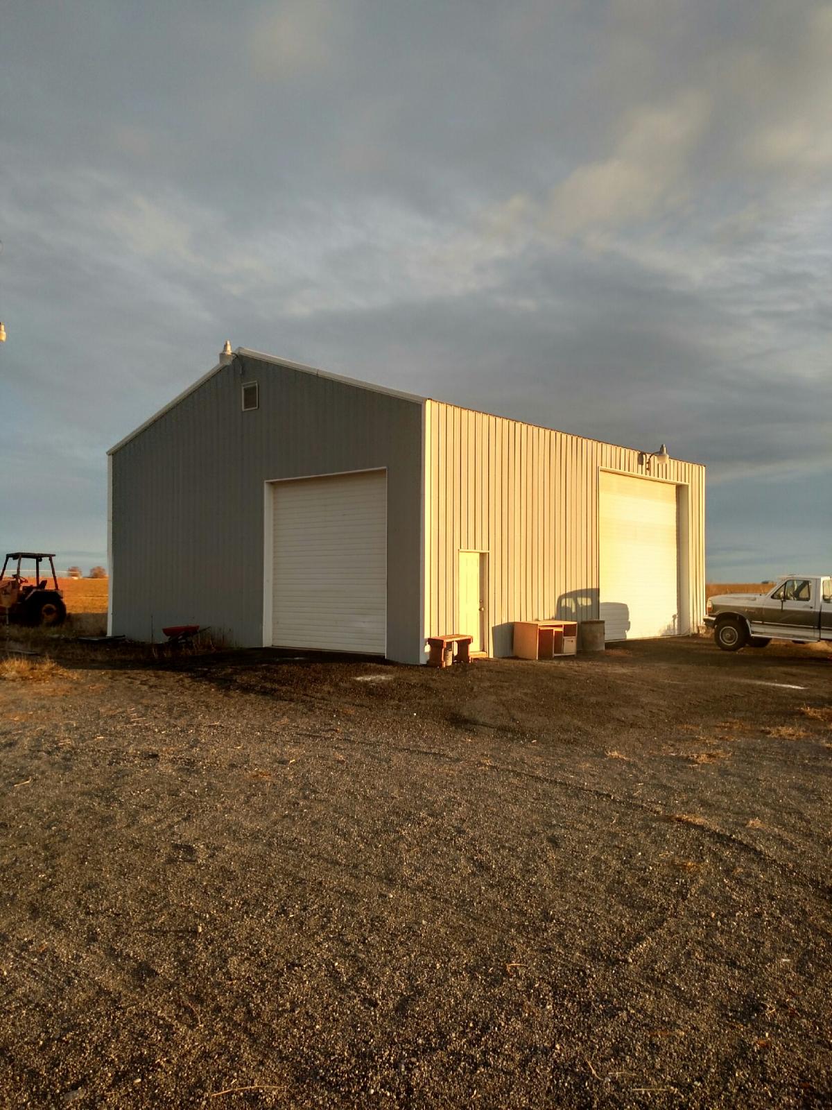

attached is a photo of the shop I built at my place in Moses lake it was a 36x40x16 built the about the same using 6x8 posts and in a high wind load area. ( several times I thought the 14x16 door was going to blow in) it sits on a ridge top , with zero protection. the new one is a lot better off that way! just as long as we get it finished before it gets put to the test!

That's awesome, I'm glad somebody can get that done and have room for their toys. As for rock....quit crying, here in TN I can't dig em up, it's all rock. I have a foot or two of dirt in the good spots but its solid rock all the way across if you start digging.

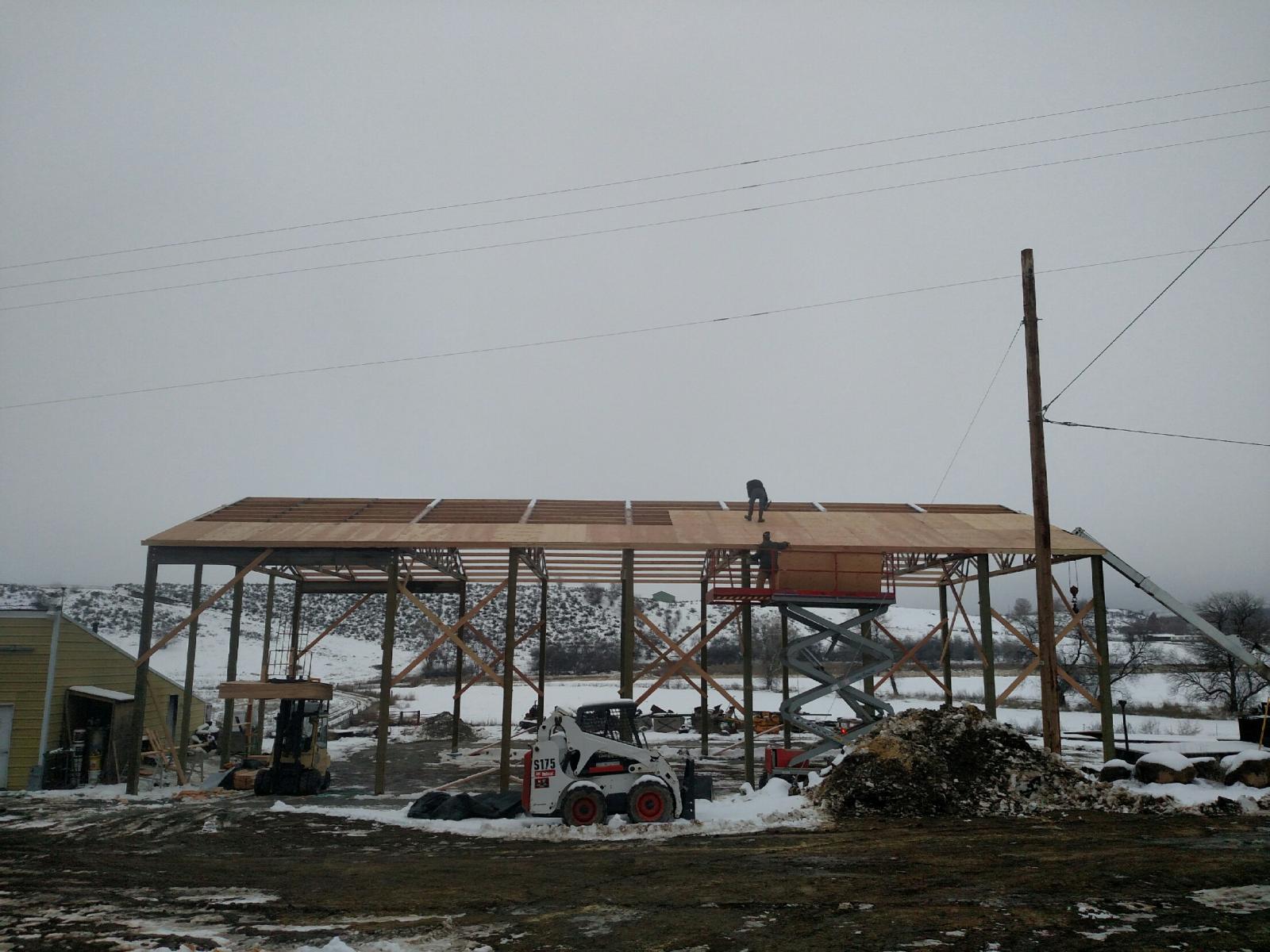

Well making a little more progress ! had to use the boom truck to "nudge" the building into "square" but we got it!
I think you need otherdog to photoshop in some safety harnesses and lines.. lol
Looks good. I find it interesting that your sheeting with plywood. Will you put steel on top of that? A pole barn built here would't have anything between the steel and the wood frame. Your shop will be as solid as a brick shit house.
