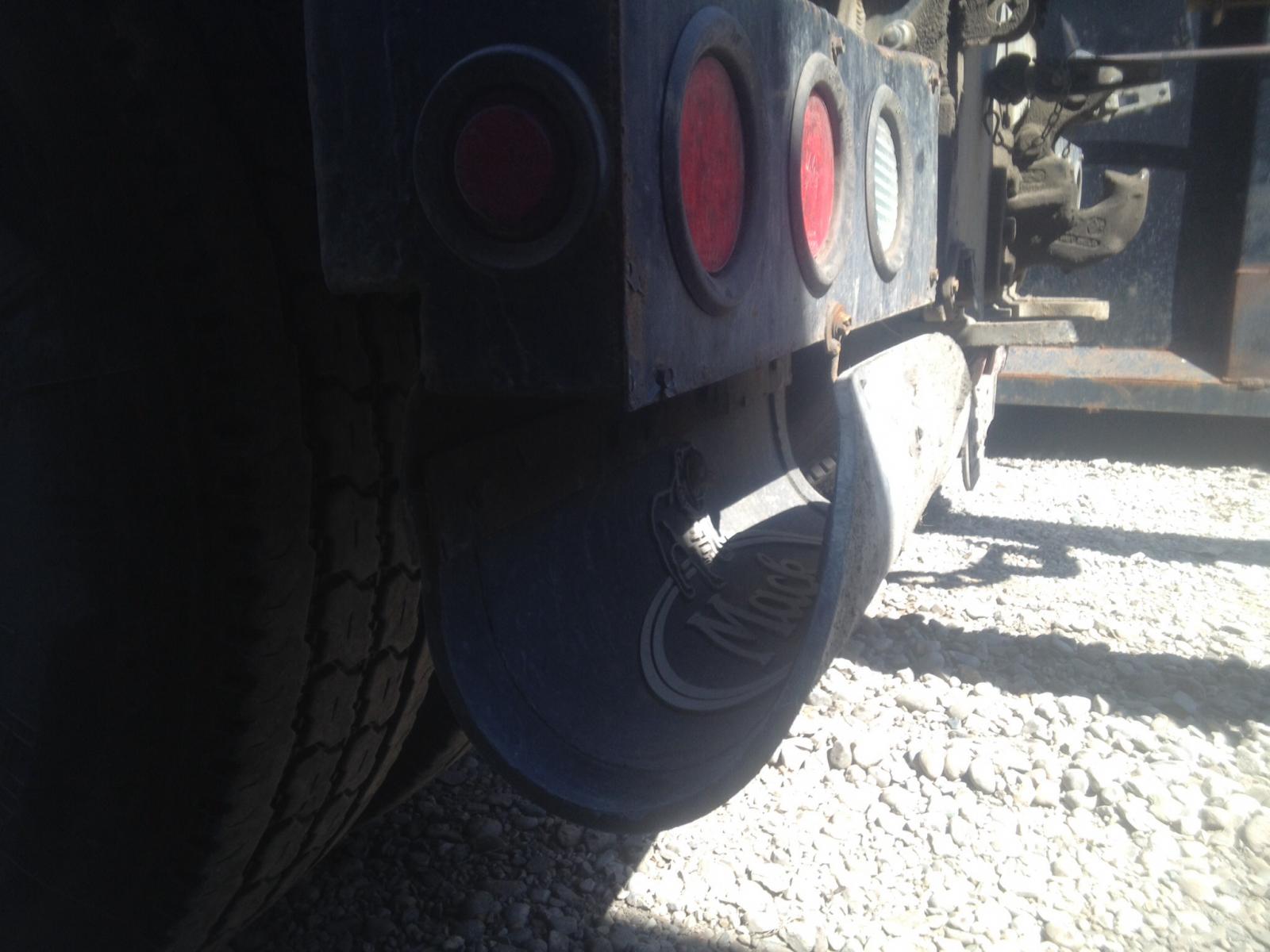

Looks like you need a set of these....

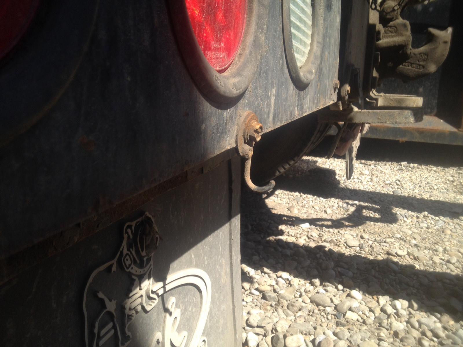

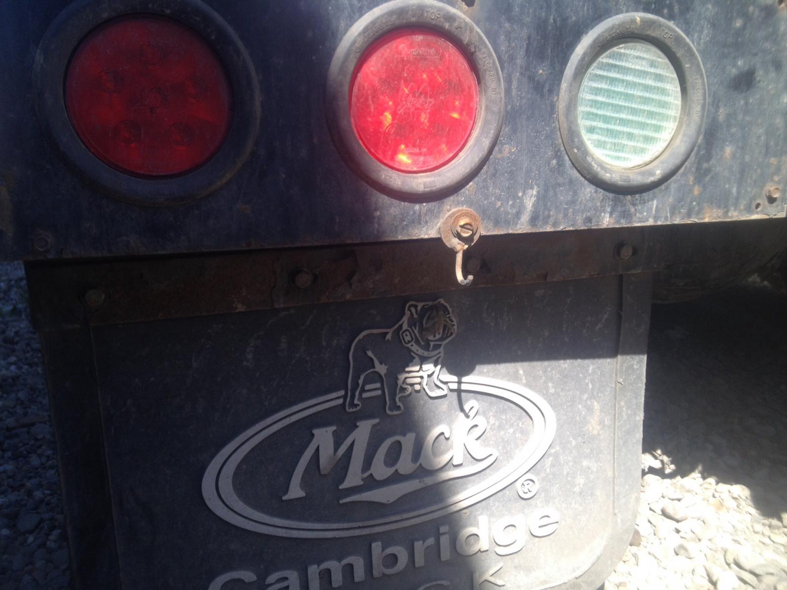

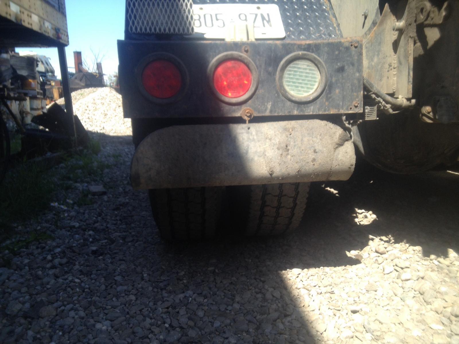

After ripping off and ultimately destroying the universal handling equipment flaps, I found these Mack flaps and said to myself, there's gotta be a way to move them when I think they're gonna get caught.....
2 washers, a broken bungee cord and 5 minutes of welding and TADA!!!

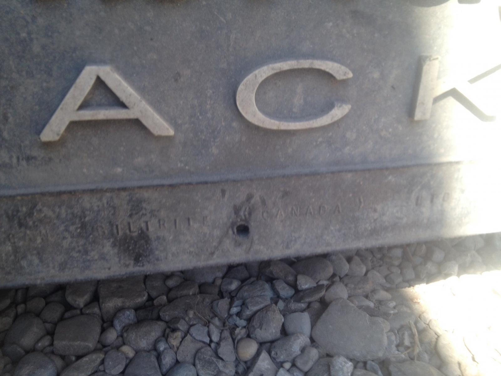

That weekend the other driver drove it and didn't hang the flaps backing over a curb and tore the outside bottom 2" off the passenger side .....%*@$!!!!
