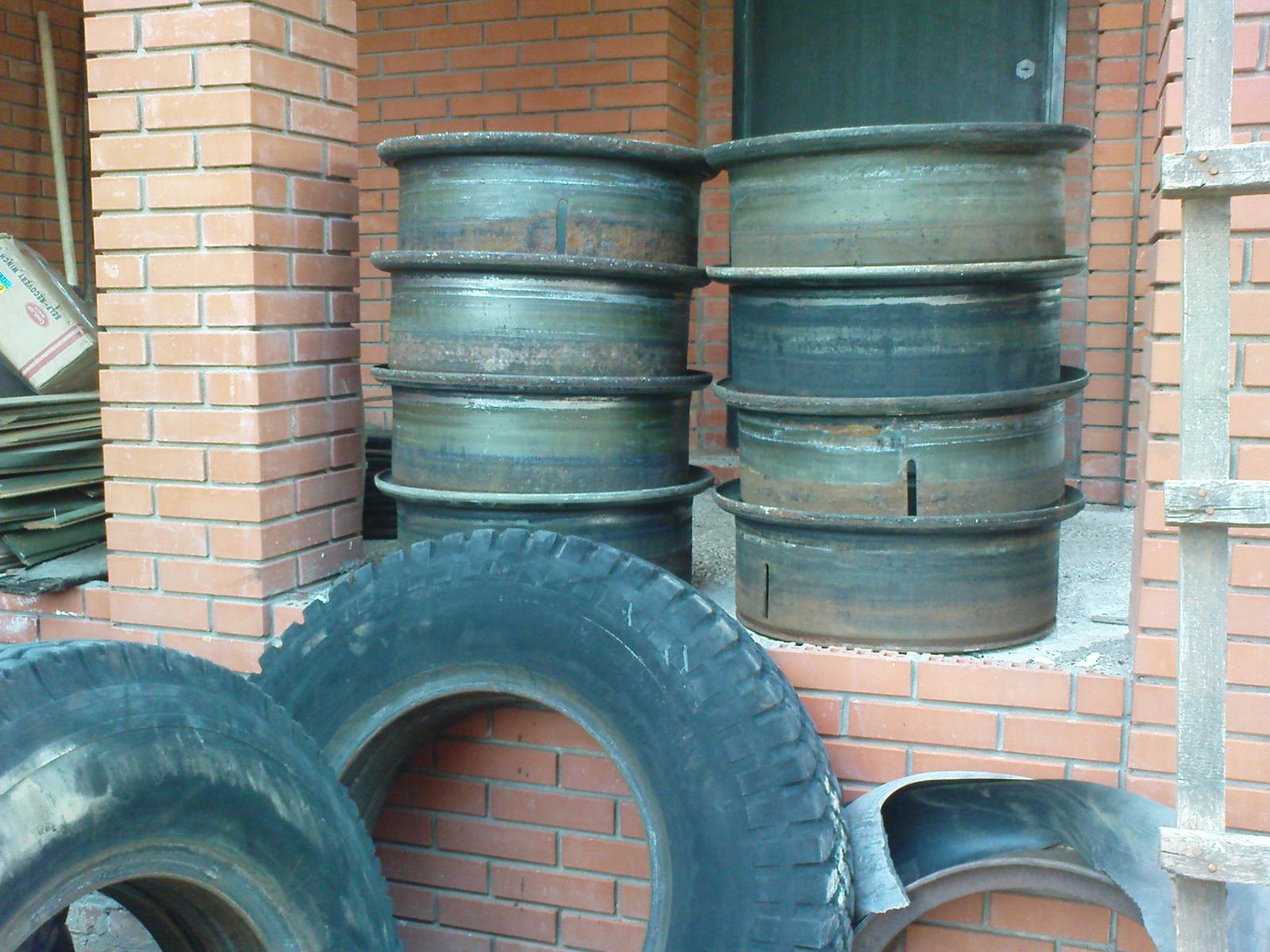

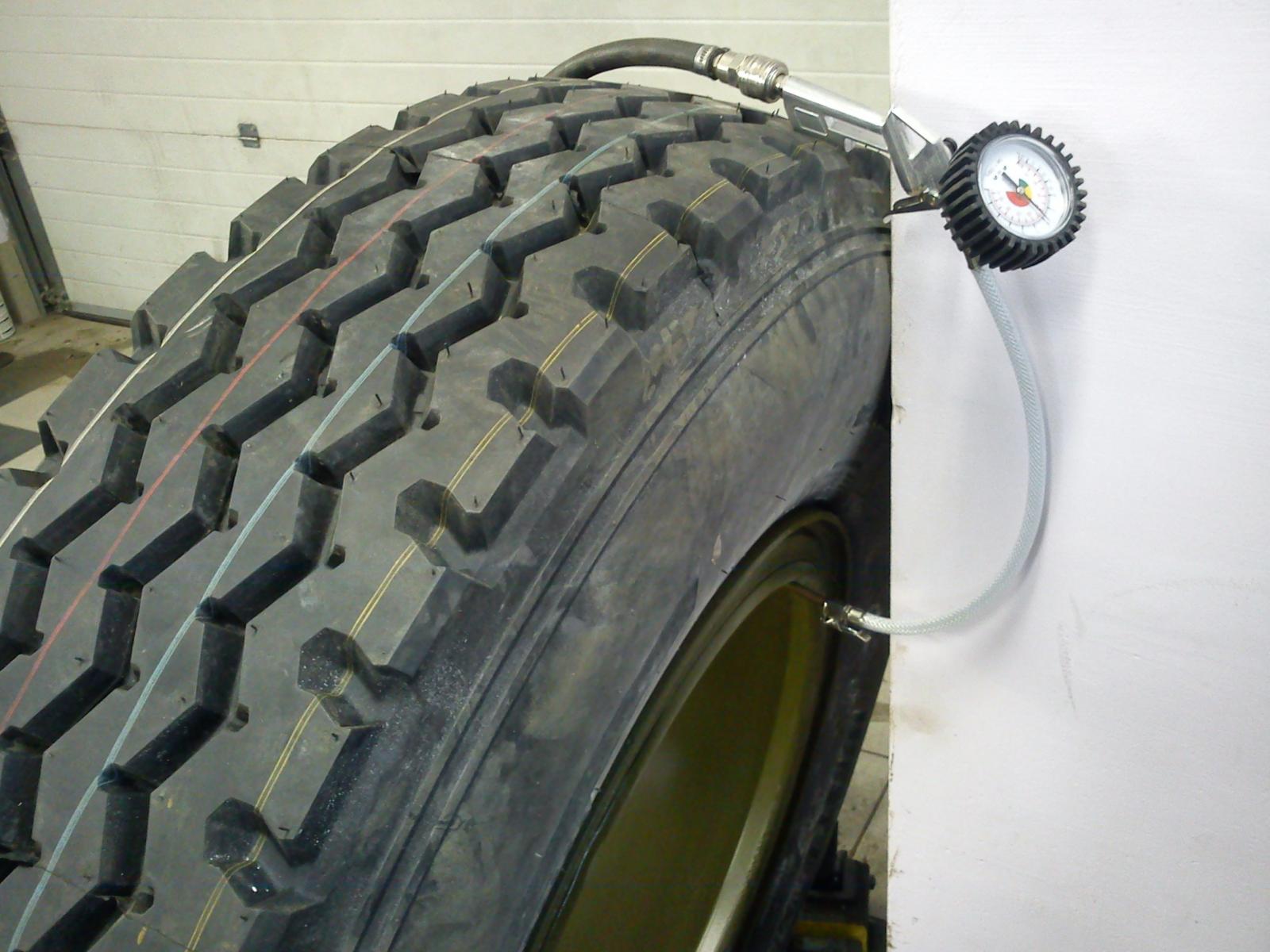

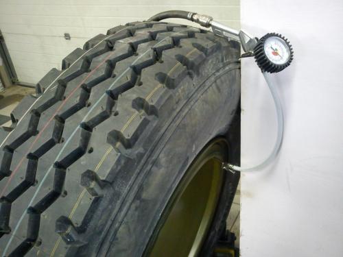

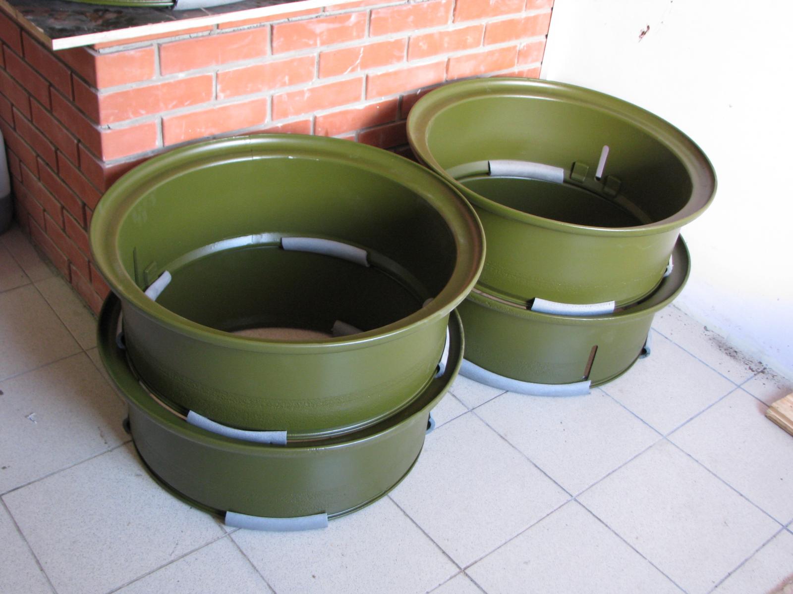

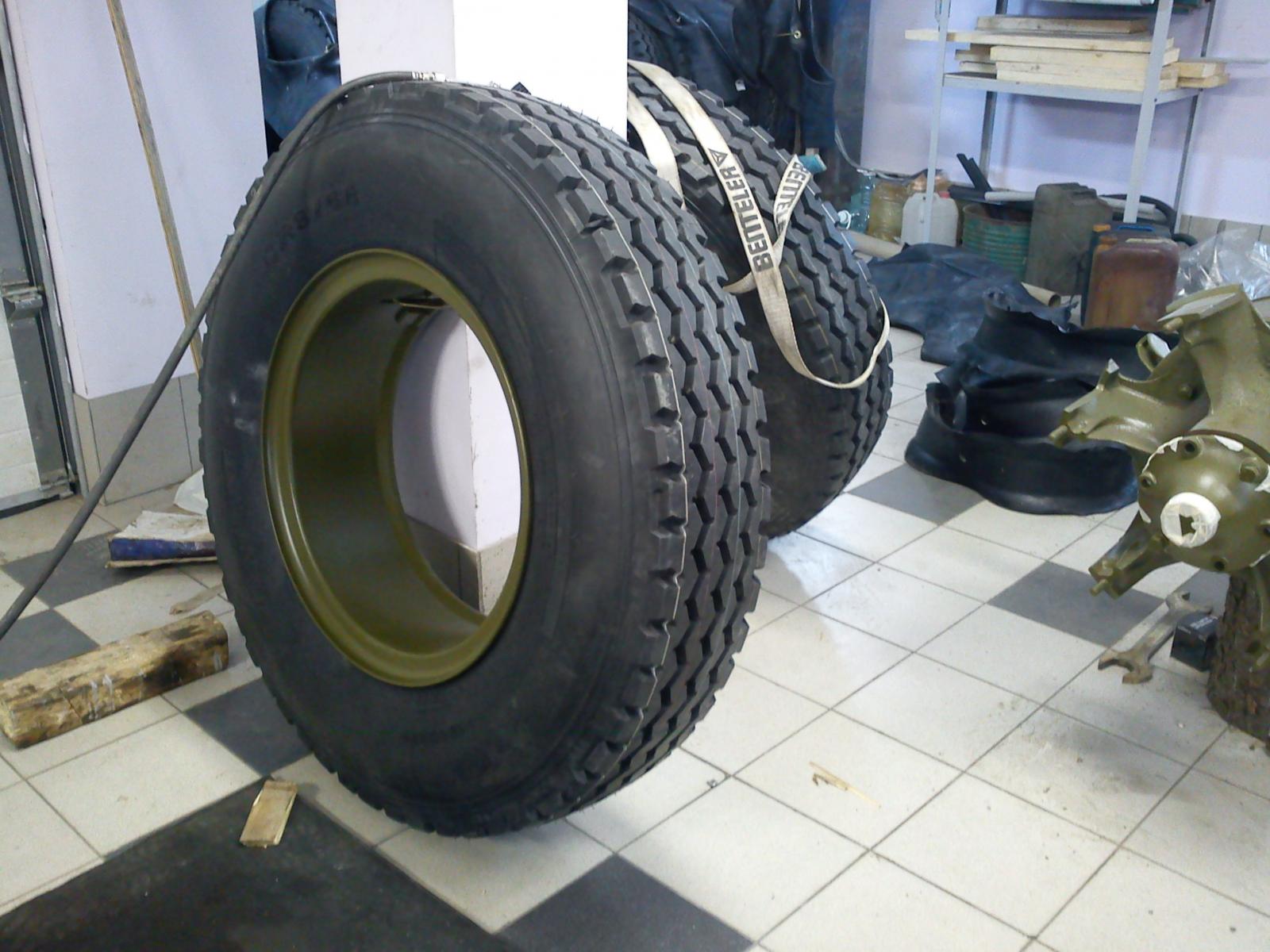

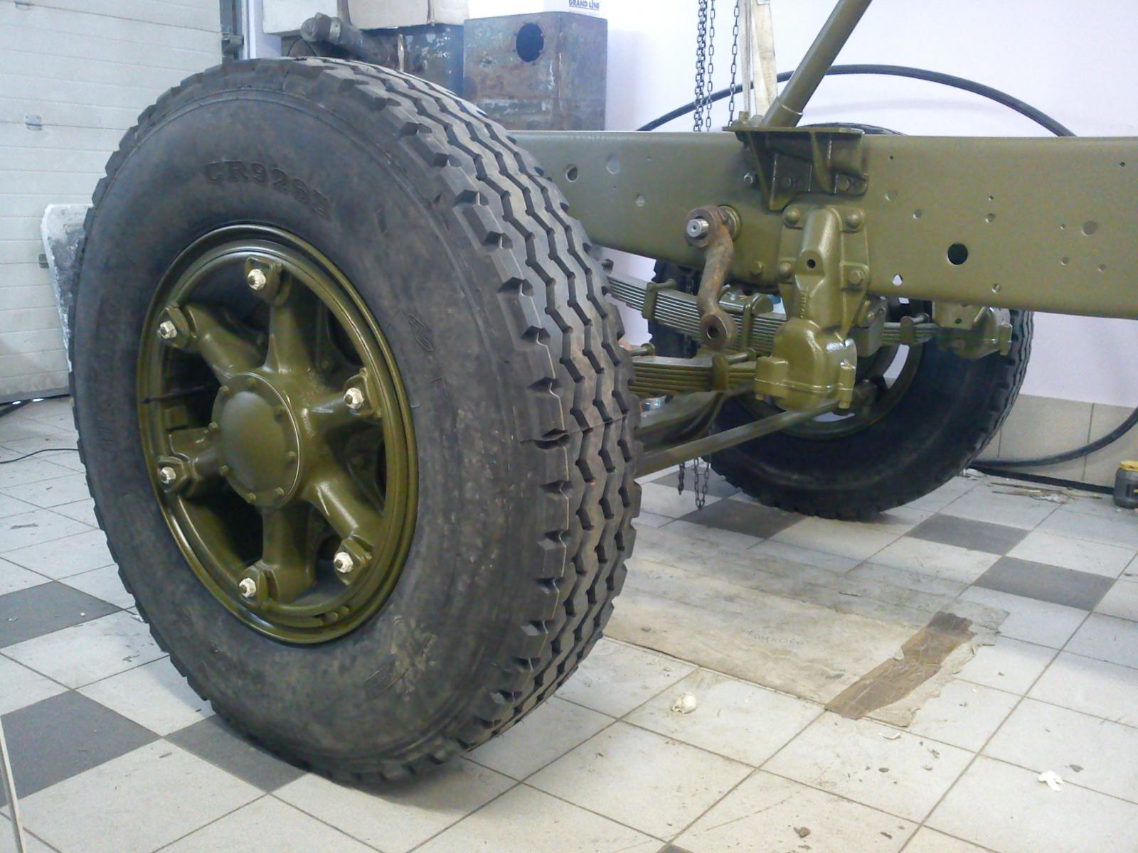

I had no luck taking the tyres off the rims and brang them to a shop.
Guys took them off with some labour but were going to brake the lock wheel because they didn't know there were rivets to keep the ring and the lock ring together.
After sand blasting and painting I assembled 10 wheels to the moment with no troubles.
Started to inflate them slowly being shure the lock ring seated well. Inflated up to the pressure securing the assembly with a couple of ropes.
