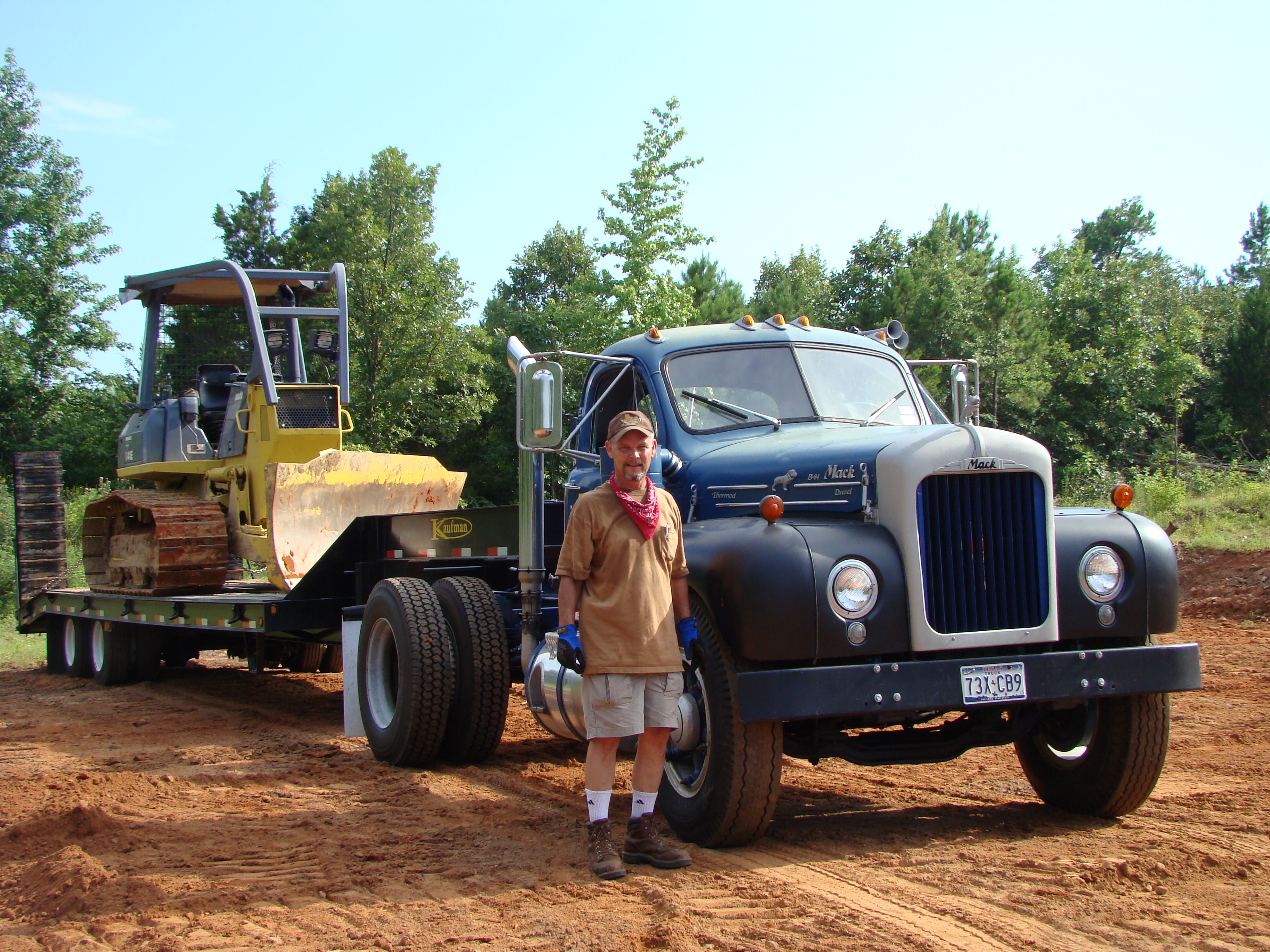

Nice looking "unit" there Thad! really nice! Contrary to where Other Dogs mind stays, by "unit", I mean the truck. You will enjoy that. I have a 61 that I use 2 or 3 times a week, moving excavator, dozer, motor grader. I bought it restored from oldmacks couple of years ago and been a really good reliable truck. I like Dennis, easy to deal with, and will do what he says. congratulations!! randyp
post-4330-0-76830700-1310497433_thumb.jp
As a sidenote Thad, mines not air conditioned, so I schedule my moves for early mornings or late evenings. It can get really brutal in "Killer B'. I have lived here in same spot 57 years and dont remember a drought and heat wave like this. Its 3 pm here now, and I have 3 different thermometers, 2 digital and one mercury, in 3 different places and all are reading 109 right now. we are getting baked alive! randyp
