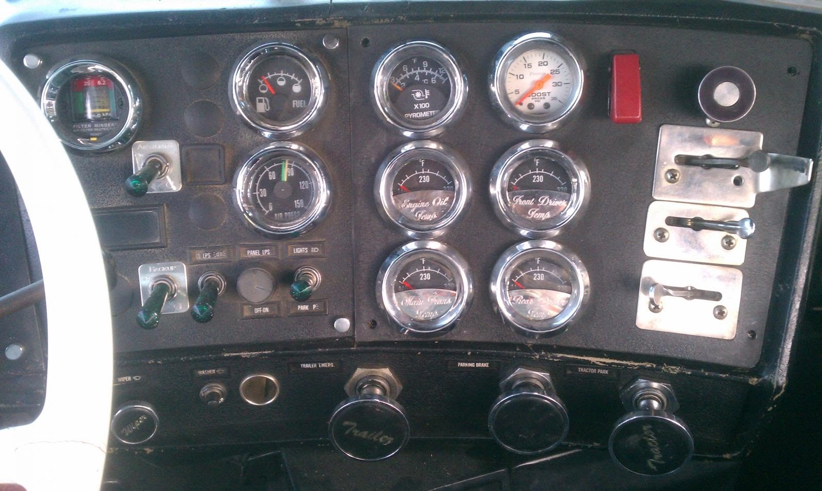

  17. sounds like the dash switch is bad or the inversion valve is bad . the dash switch has 2 ports that one or the other has pressure going to it depending on the position of the selector on the stick. if the inversion valve is sticking it may be stuck half open and exhausting when it should not be? someone just posted this pic the other day
