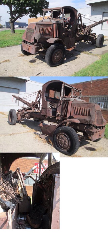

  10. I received an email about Just passing it along Crystal Truck Parts Dearborn MI 48126 Ph-800-336-3348 313-584-8008 Usedtruckparts@sbcglobal.net Fax-313-584-7196 Isidor For Sale: chain drive Mack tow truck - needs work - $3000
