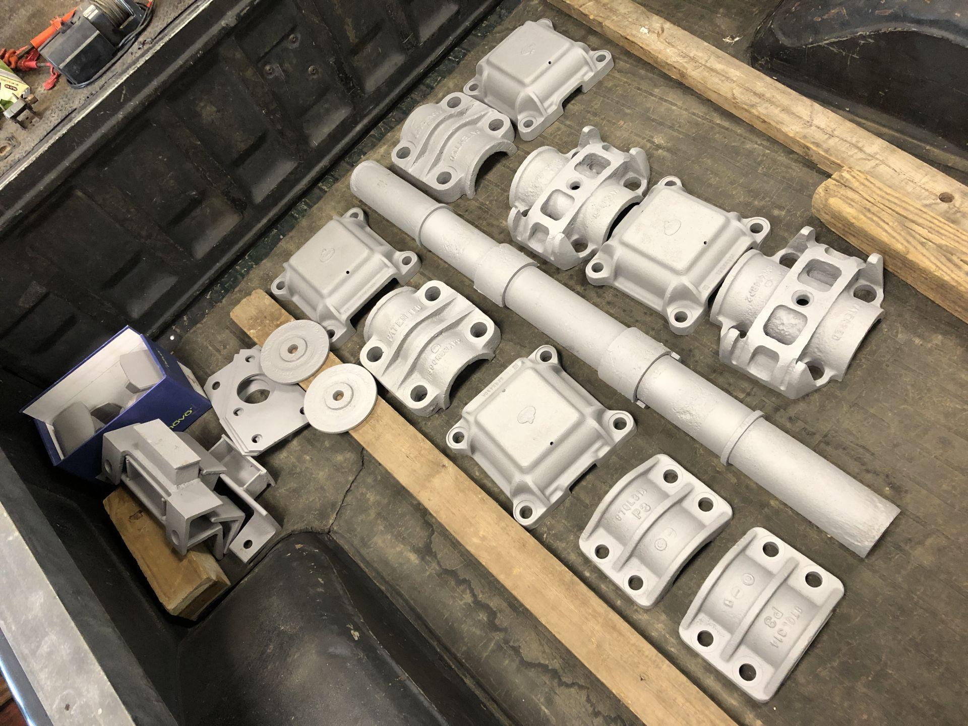

  10. I'm putting my H model together from 4 trucks, but thankfully I've got a clear title for the vin on the frame rail so no need for any fancy title work!

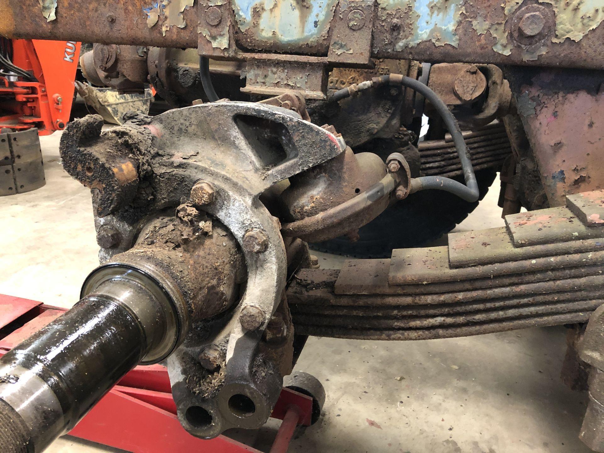

  18. I went to put the front leaf springs on, since there's no weight on the chassis the springs won't squat down enough to line up the ends with the mounts. As you can see, the rubber insulator is cocked at an angle because of this. I'm used to working on springs that have shackles so they will swivel to line up. I even tried the old spring, it's the same way. Has anybody put front springs on that can give me some tips? When I put the engine in will the rubber settle into the right position?
