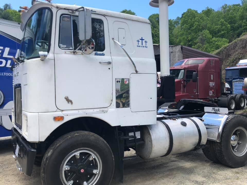

I saw this LJ for sale on Facebook Marketplace in Lima, Ohio. You sure don't see many L sleepers around!! Frame has been cut, has a Cummins engine. Ad says it's in rough shape, asking $450 obo.
