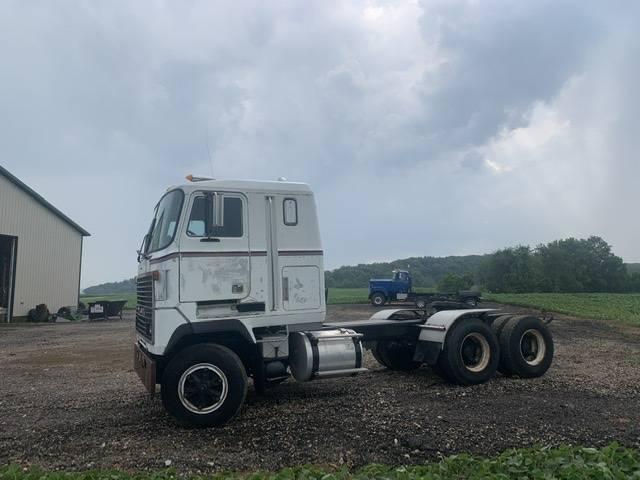

  22. Glad you saved it! It looks great, and that gravel pit is a really nice background for the photos.
