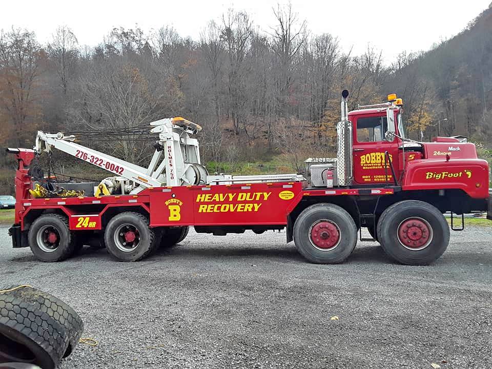

  4. This is one of the ugliest trucks I've ever seen; sadly someone put a lot of time into building it. It's got a Toronado motor/trans setup with front wheel drive... it may need some TLC. https://www.ebay.com/itm/tow-truck/265109095644?ssPageName=STRK%3AMEBIDX%3AIT&_trksid=p2060353.m1438.l2649&autorefresh=true

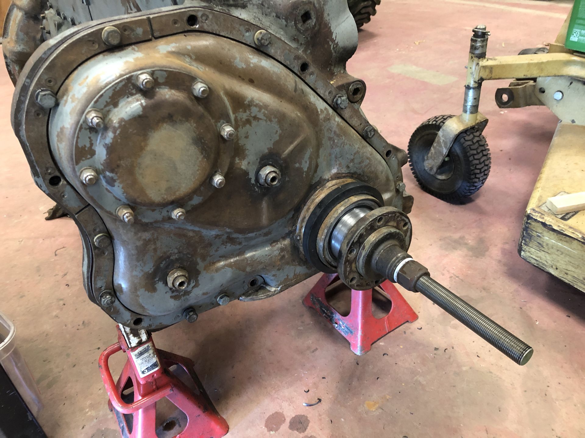

  21. I got this in a lot of Mack parts; I don't know what it is. The bolt holes are 4-3/4" on center...you can see what the part number is (it was still sealed in the bag). If anybody can use it, PM me your address and I will ship it to you.
