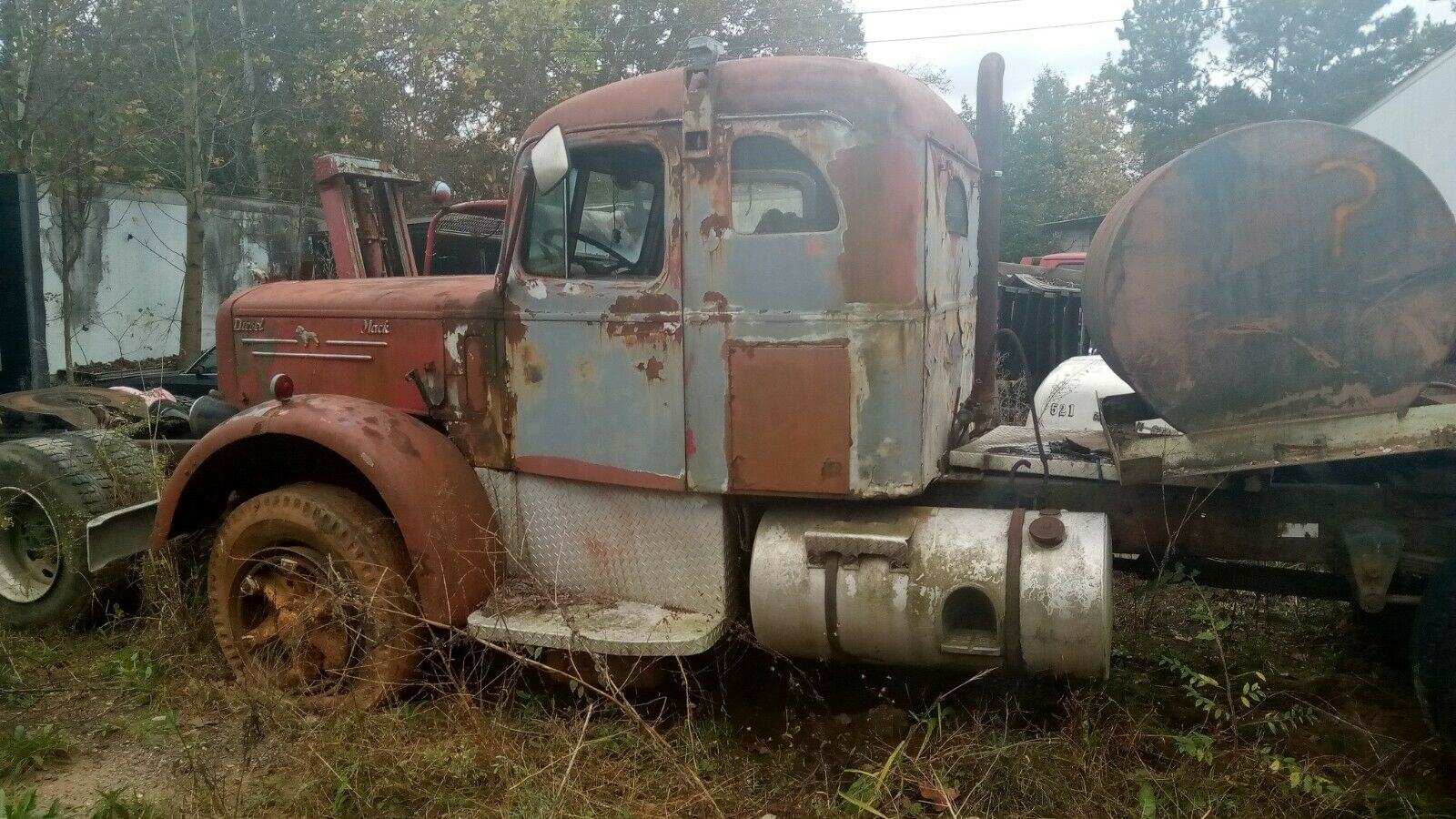

  24. Western F model!! I'm jealous, you have a cool truck there. I'm glad to see you're giving it TLC.
  25. That looks like a nice truck...if it runs good then $15k is a great price.
