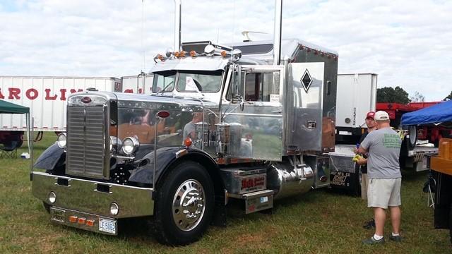

This was right after the truck changed hands (again) a couple of year ago. I have the new owner's card at home somewhere. Super nice guy. This particular one is sitting on a Pete air-ride rear suspension. Not sure if it's a full Pete frame or not. Loved this show growing up. Glad to see at least 1 of the trucks survived. I believe this is a season 1 (west coast) truck.
