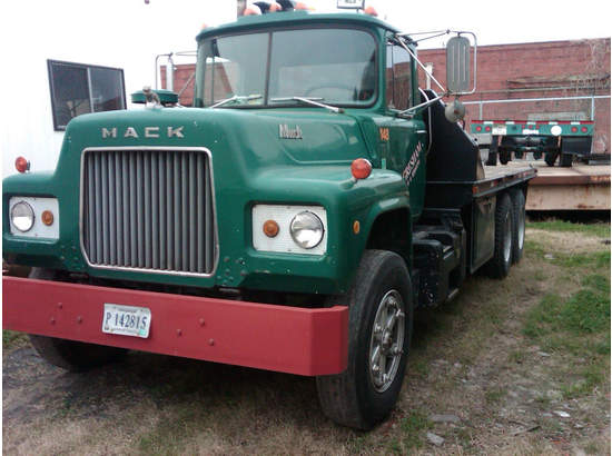

All, Here is one of the oddballs I saw. This truck is an F685T (both on the frame and on the...uh..."transplanted" VIN plate. The cab is an older CA36 "steel dash" piece, and the hood is a somewhat later model with the external grille on it. So, it's kind of a mutt. "Dale" at the mack museum said that the majority of the holes in the frame for locating the various components were common, and that things like cab mount brackets were model-specific. The reason I am asking if anyone has personally dome this swap os that I have found F-model trucks with good frames, but little else, and may have located an R or two which need frames. Of course, like j hancock said, I would be infinitely better off if I could locate an R that is equipped the way I want. I'm just trying to keep my options open! Kent
