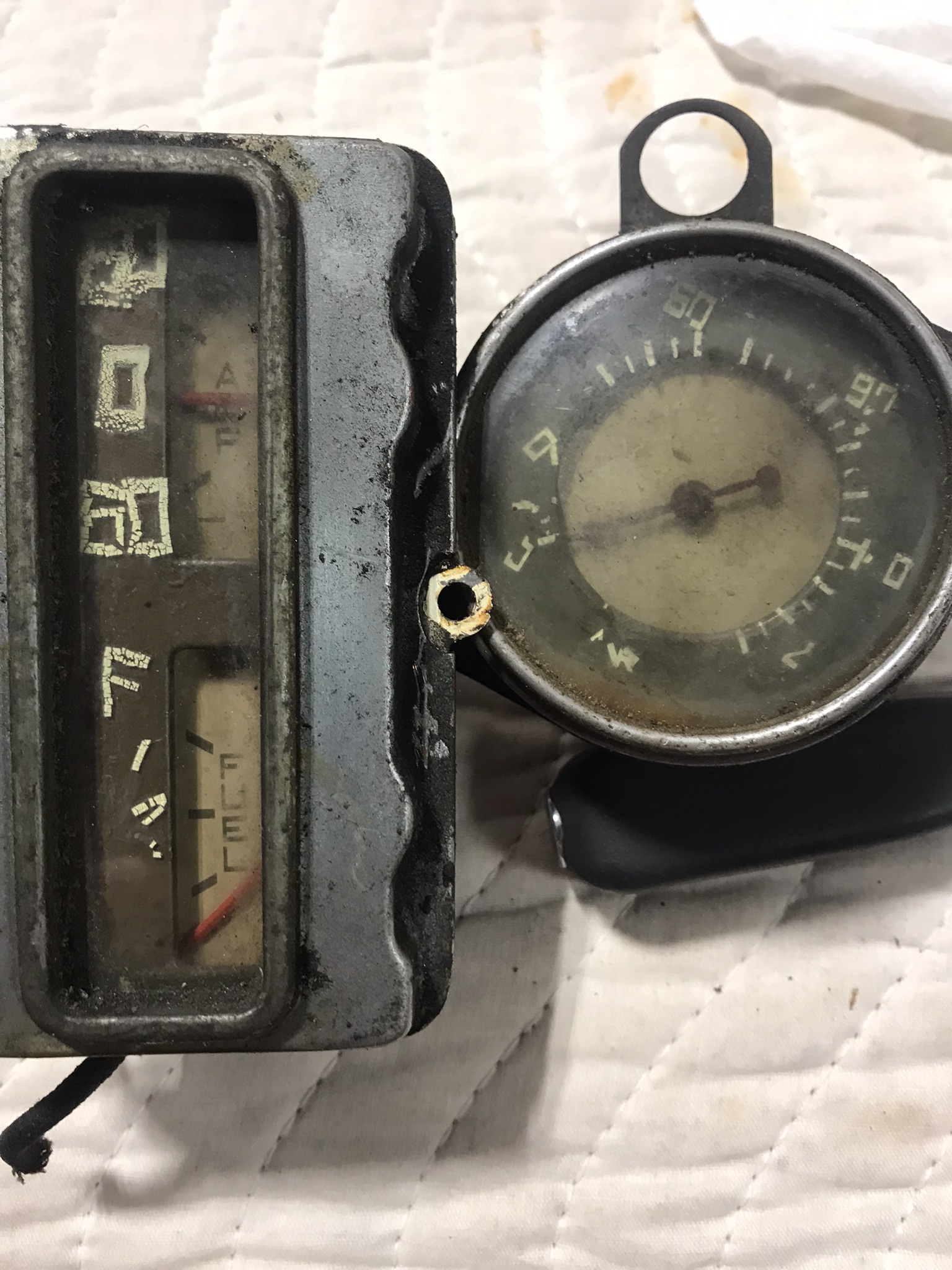

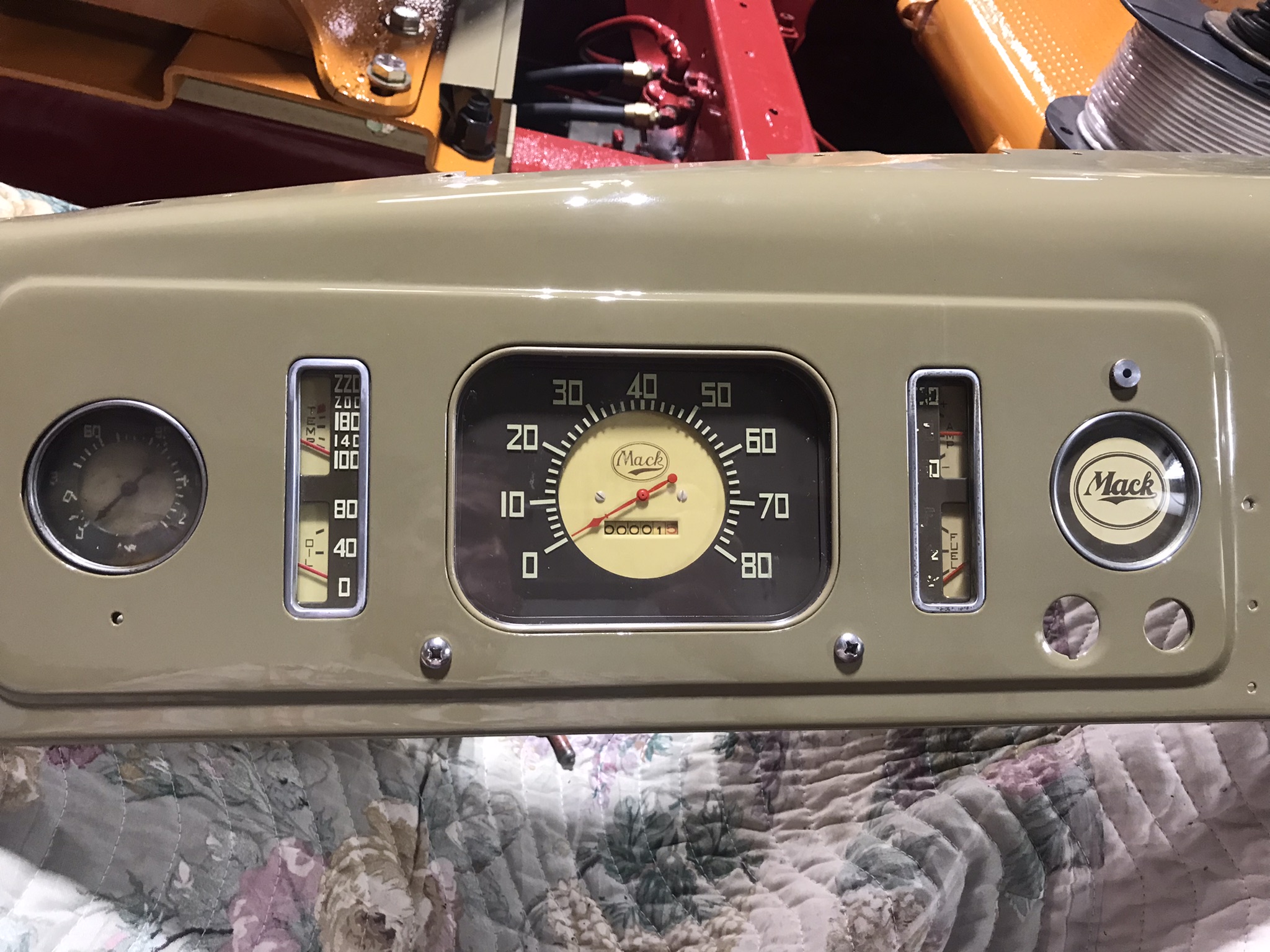

A thought would be to reach out to Matt Pfahl. He does a lot of vintage Macks and has a lot of resources to get things rebuilt to original. Classic Instruments is another resource that rebuilds old instruments and can also put modern innards into them for those that want the original look but modern operation, like 12 volts.

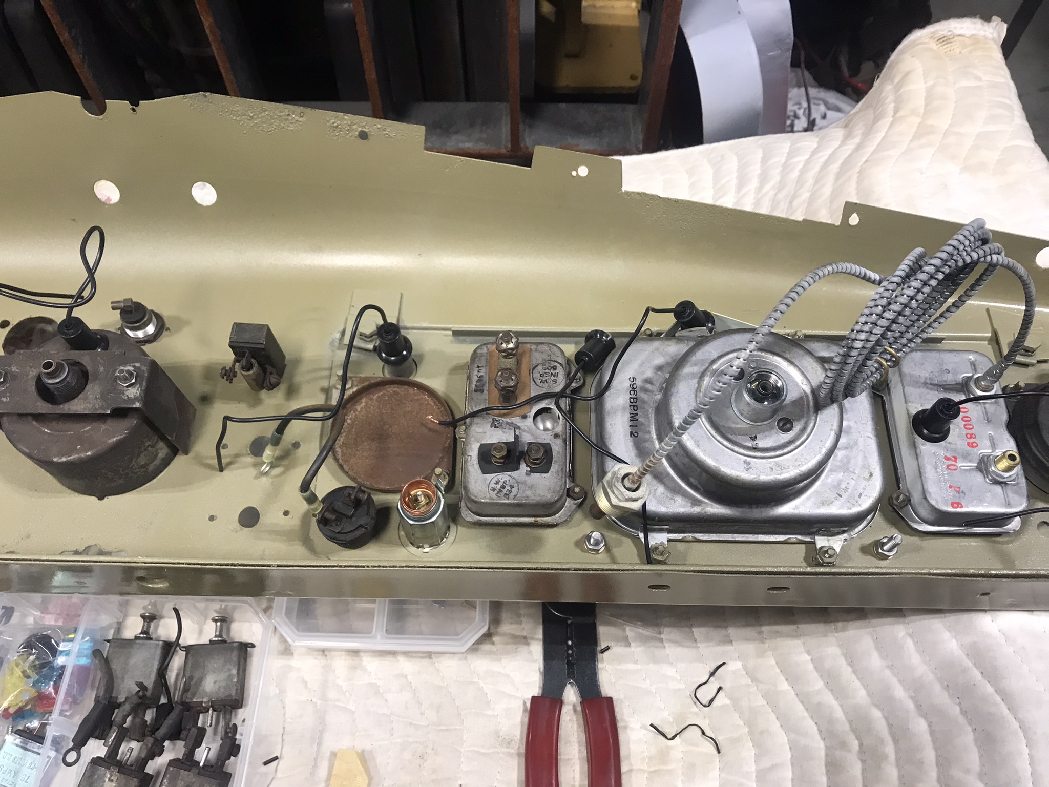

If you can get a schematic diagram, that would be helpful. All the wiring supplies are available that you would need, like fabric covered wires and loom wrap for a period looking harness. Or you could just use modern wire. Then just sourcing the correct gauge wire, most of it will be 14 Ga. and 10 gauge for heavier leads, like off the alternator on the charging circuit. Do you still have the old harness? Even if trashed, it could be useful as a pattern.
I was wondering where I could get a diagram,  l looked at some pictures of your dash that you posted and the LJ has fewer wires then the B73 , the old harness is long gone, I do have a parts truck that I removed the dash and it will be a good reference, but I would like to have a factory LJ wiring diagram just to keep it as close as possible. I’ll use modern wire and loom because I already bought enough 14 & 10 gauge wiring. Removing the voltage regulator, generator, and the series parallel switch cut a lot of wiring out already. Thank you.
